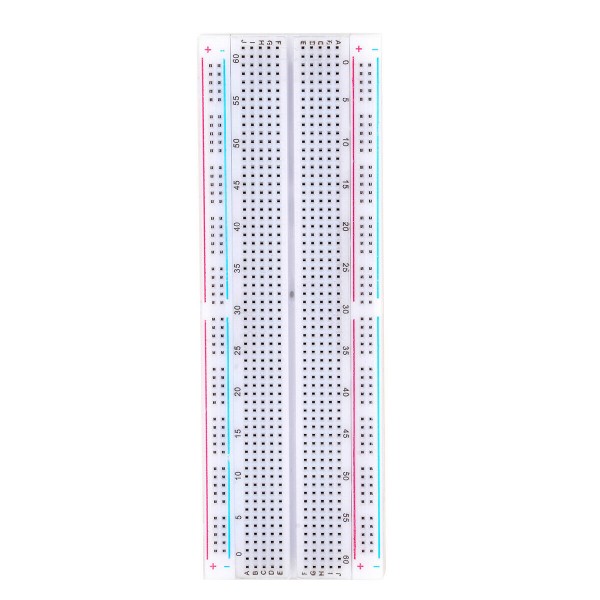

something to look out for when buying breadboards.
Of course you could choose to get it from a well known supplier like digikey or mouser and I would expect those breadboards will function great.
But if you're like me and try to spend as little money as possible there are cheaper options from china (ebay, alixpress, banggood etc)
However, there are some cheap breadboards out there that are practically useless because you can't really insert components.
I did once get a couple of those and there is something I have noticed you can look out for that might help you recognize them.
The most standard breadboard type (like the MB-102) has letters and numbers printed on them to indicate the rows and columns.
On the crappy ones the letters are reversed on the same rows, so on one side it would be labeled as A while on the other side the
same row is labeled as J (and upside down). The numbers are reversed as well. Of course what you see in photos isn't always what
you get but if you see this I would recommend to avoid it.
attached is a photo (from ebay) that shows an example of what to avoid.

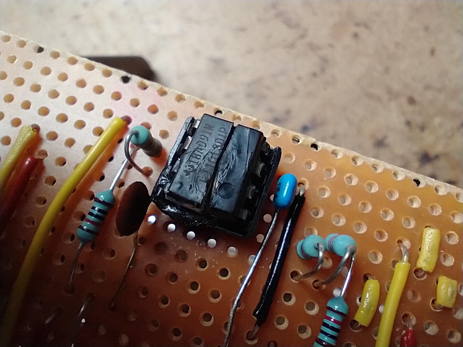

When you smell burning, turn it all off and keep looking until you find the source:

I know that smell, did it smoke too ?
These days I often do a quick test where I use my fingers to check if anything gets warm after powering up. Also measure for shorts before powering up.

Oh yes, smoke. It was actually a module already in my synth, a simple fixed voltage source providing +1V, +2V, +5V, and -1,-2, -5. Hence the use of the LT1013. Not sure what happened, it worked fine for years, suspect I shorted the output (though the opamp is meant to withstand a short indefinitely).
Bit disconcerting to smell burning from the cabinet, open it up, and see smoke!) Fortunately no other modules were damaged. The power supply was pretty hot though.
