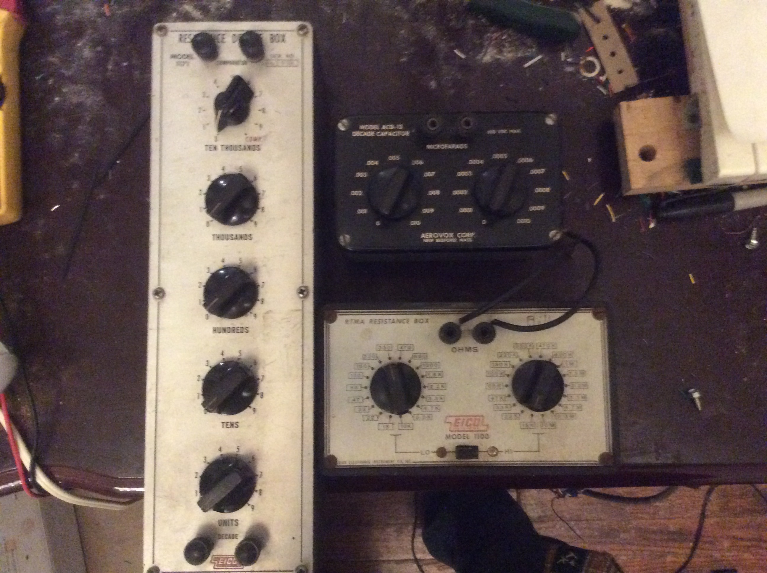

When I'm building a fixed filter for a cigar box organ.
Deciding exact resistor values for a voltage divider.
Setting exact gain on an opamp, to offset level lost in an affect.
I find having a couple of decade resistor boxes and a decade capicitor box to be big time savers.
I know they are pretty old school. But these cheap old yard sale buys get a lot of use in my projects.

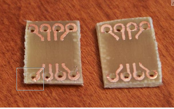

hello chaps,
i bought some CA 3046 's in SOIC format.Very, very small. The SOIC to DIP adapters cost a fortune,so i've been thinking of making my own mini pcb's to solder the micro chips onto, just like is depicted in picture.
has any of you done that ,or ,come up with different or better ideas ?
cheers all Smile

yes, for 1$25 you buy 20 pcs double sided HERE and the transport is free.
Ok, its not full diy.... :roll
But it works great Very Happy

thanks Grumble ! Smile
holy crap ! that's sooo cheap compared to the rip offs i've seen around the net. Up to 8 euros each in some cases Shocked Shocked
will make sure i buy some of them, it looks like Holland is the place to go for good bargains Rolling Eyes Rolling Eyes

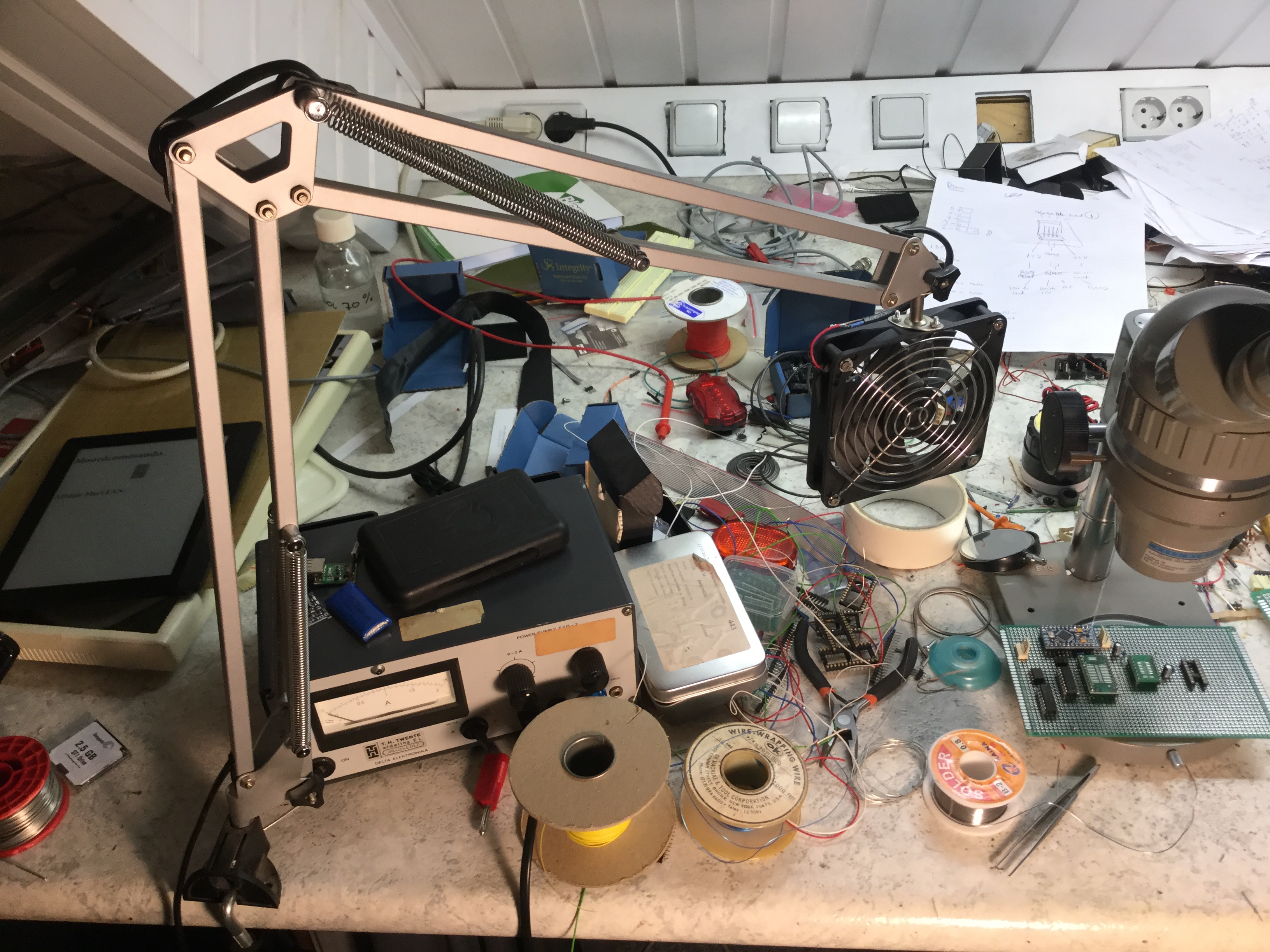

Ever noticed when soldering that the smoke always gets in your eyes, mouth, lungs?
That is because your body is warm, so the air around your body heats up and starts to move up.
I have a sort of solution for it: I just fixed an old pc fan to an old desk lamp and powered it with about 7 volts, and that is just about enough to suck the air (smoke) away from my work and disperce it.
One improvement could be to add a carbon filter, but this works for me.

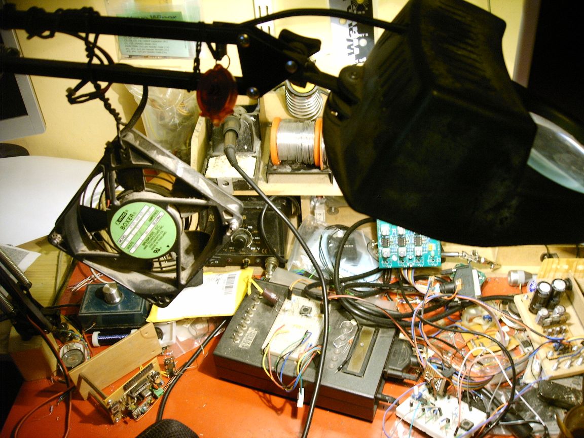

GMTA ? Laughing

Wonder how many diy-ers have a bike backlight at their workbench cyclops
Posts: 1320
PostPosted: Sat Jan 07, 2017 8:06 am    Post subject: Reply with quote  Mark this post and the followings unread
GMTA ? Laughing
GMWA Rolling Eyes
