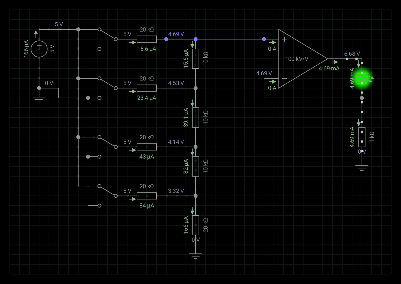

This is probably the best solution.
Its a 4 bit R2R feeding a voltage to current converter to drive the led. This is the best way to drive LEDs when variable brightness is required as the circuit automatically overcomes the Vf of the LED using negative feedback.

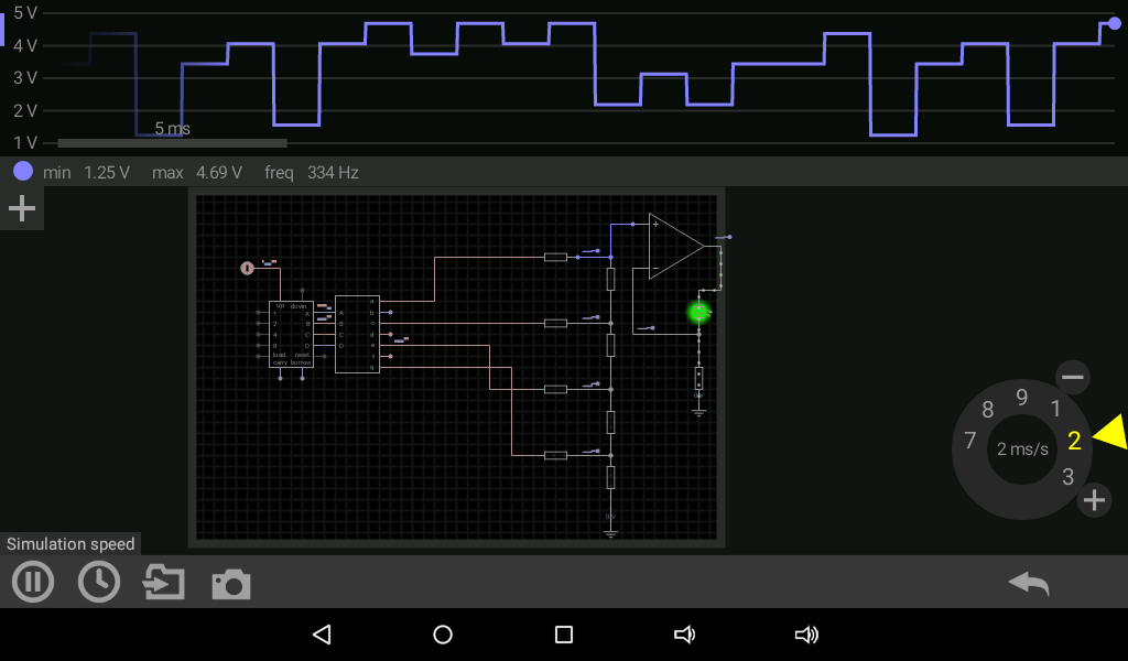

Using a binary counter and a 7 segment decoder to provide a complex modulation waveform

PostPosted: Wed Apr 26, 2017 5:12 pm    Post subject: Reply with quote  Mark this post and the followings unread
what kind of decoder did you simulate to get 16 different steps ?
I looked at some datasheets but they all had blank outputs above 9 (10 steps). I do recall seeing one which did have
valid outputs above 9, but I can't remember which one it was.
I was thinking of making it into a synth module with potentiometers on the outputs (like a sequencer) but realized that
it is much easier to get the same results with a standard 10 (or more) step sequencer. I might experiment a bit more with
it as a suboscillator though, maybe add a switch for some different presets. I guess the easiest thing to use for that is some
muxes controlled by a single switch, that could possibly create 12 different ones with a standard rotary switch.

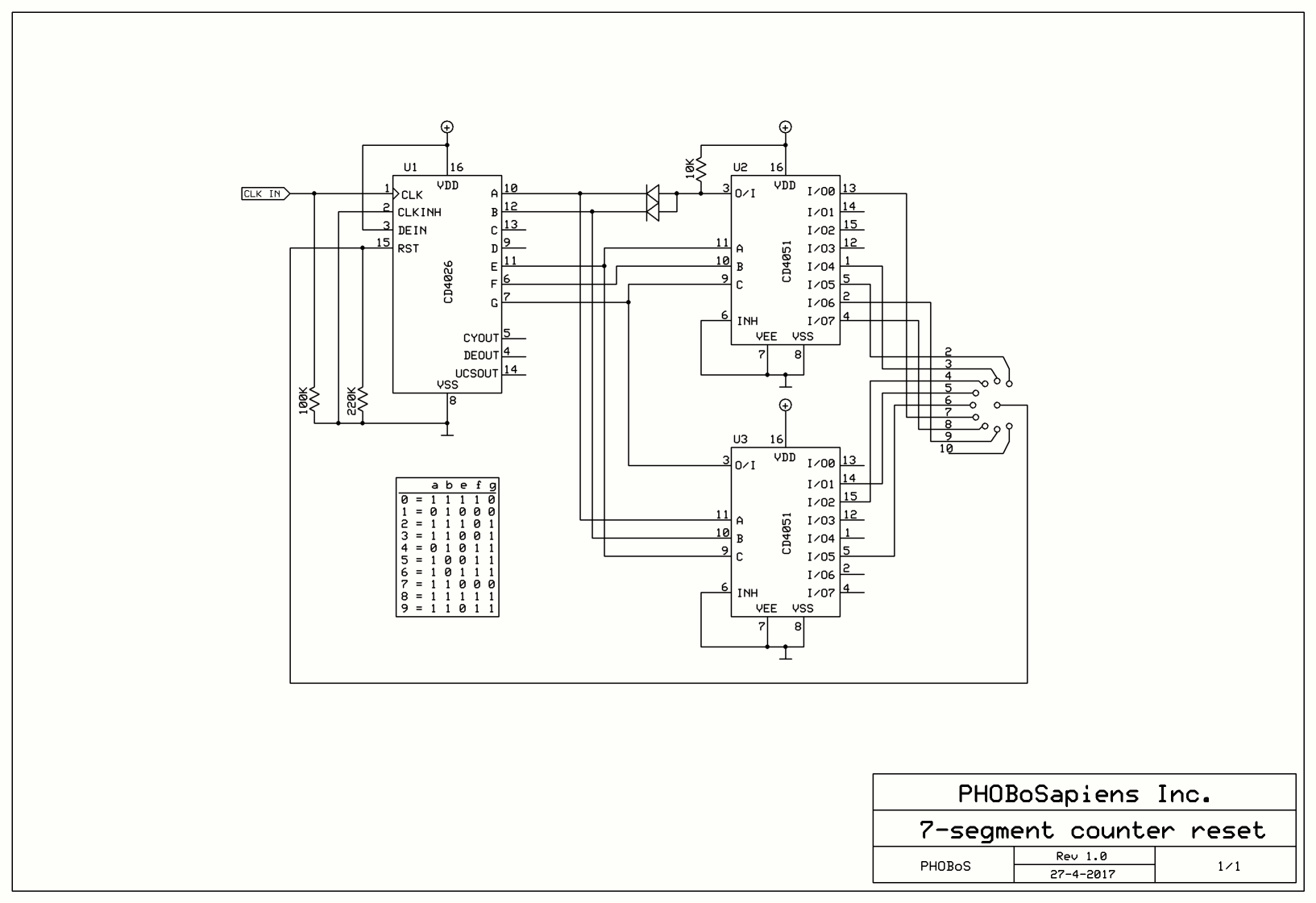

I came up with a circuit to select the number of steps using the a-g outputs. I first checked if there where any redundant outputs
and with that I mean outputs that are not necessary to determine the current step. Turns out that c and d can be left out so that
made things a bit easier. I haven't tested it so don't know if it will work and there might be a better solution. Another option would
be the seperate counter+decoder and convert the binary to decimal to select the number of steps, which could be done with a single
4 bit mux, but the chip count would stay the same and then you might have to add some extra delays again.
I was also thinking that instead of using presets a simple way would be to add 8-position switches to the inputs of the R2R
connected to the 7 outputs a-g (+ an off setting). It would take up more panel space though so I will do some test to see
what is useful. (this would be a for a dedicated subosc synth module btw)
reset for 4 steps doesn't work in this version, updated version posted below
 Filesize:  63.79 KB
 Viewed:  325 Time(s)

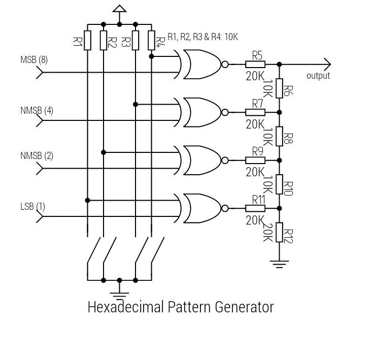

Another thing that I've tried is to put XOR gates ahead of the R2R one input is from a counter, etc and the other input is connected to a switch. The switch then decides whether the signal is buffered or inverted.
I was thinking of doing this with the 7 segment output going into an R2R. Not sure whether to have a 7 bit R2R or a 4 bit R2R with the option of picking which of the 7 outputs is routed to the R2R inputs via the XOR buffer/inverters.
gasboss775
Joined: Jan 02, 2016
Posts: 217
Location: Scotland
PostPosted: Sat Apr 29, 2017 11:11 am    Post subject: Reply with quote  Mark this post and the followings unread
Here is a schematic just to clarify what I was meaning in my last post:
 Filesize:  124.35 KB
 Viewed:  290 Time(s)

PostPosted: Sun May 07, 2017 6:49 pm    Post subject: Reply with quote  Mark this post and the followings unread
I just tested the reset circuit and it almost worked except the reset for 4 steps; it resets on 2 steps instead.
In theory it should work but I decided to add an AND gate to the I/O pin of the second mux too. (I actually
had this in the first design and then figured out that it shouldn't be necessary) This AND gate would be
connected to outputs f and g of the CD4026. As with the other mux I was going to use 2 diodes and a resistor
but after I added the diode to output g it already worked. Shocked I am not sure why, but I have an LED display
connected to it so maybe the voltage drops a bit and therefor the reset doesn't properly work, I am using
4.7K series resistors for it though. It might also be caused by the mux itself.
Anyway, it seems to be working fine now so here is the updated version.
 Filesize:  64.69 KB
 Viewed:  272 Time(s)
