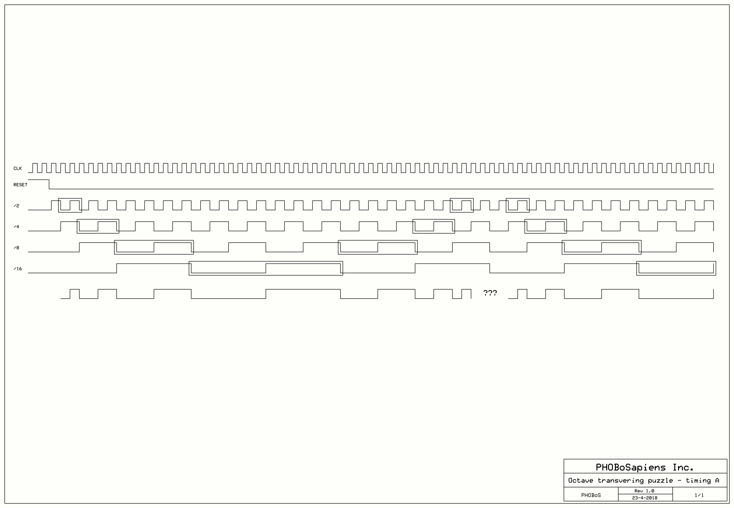

Heres a little something which might sound cool:
The puzzle is to make it so you only get one duty cycle per octave pulse like so:
this example transverses 4 octaves but that is not a critical factor...
I think I have a possible solution but would like to see what you fine folk come up with Smile

Hey, im after the output in the second drawing. So rather than 16 small pulses follow by 8 twice as big pulses followed by 4 twice as big pulses ... etc ... I was after a configuration that give 1 small pulse, followed by 1 twice as big, followed by 1 twice as big then back down again....

Here's something that probably won't completely work, but it's a start.
note: U4 is a priority encoder

I did a quick simulation with digital works and it works about 50%. I'll have to draw a timing diagram to see what exactly is happening.
Or maybe someone can use some software that does that. I was thinking about the reset too but sofar it doesn't actually seem to
matter. I think it just changes the phase compared to something else running from the same clock, but the pattern stays the same.

I don't know of any software but I did write down somewhat of a truth table. By the looks of it starts to repeat after a couple of cycles.

When I initially tried to solve it I first drew up a timing diagram to see which divisions need to be selected and when.
As you can see there is a bit of a problem which is probably releated to why your version doesn't fully work.
This is also the reason why I opted for a 4029 to do the up/down counting.
I did make a mistake in the circuit diagram: there needs to be an inverter between the carry out of the 4029 and the CLK in of the 4013.
if you do that it counts:

Ah nice. Thanks for explaining the way you approached it. Good idea drawing up which divisions are needed etc v smart!
Posts: 5899
PostPosted: Tue Apr 24, 2018 2:01 pm    Post subject: Reply with quote  Mark this post and the followings unread
That timing diagram is also how I came up with using a priority encoder.
While I was looked at it I noticed something:
/2 needs to be selected when /4 is high
/4 needs to be selected when /8 is high
/8 needs to be selected when /16 is high
etc.
I assumed CLK (inverted) can be selected when /2 is high but I didn't really check that, hence why I am not sure if the circuit
fully works or not, I also didn't check yet if it still works correct when counting down.
anyway,
/2 is connected to input 1 of the mux so is selected with CBA = 001
/4 is connected to input 2 of the mux so is selected with CBA = 010
/8 is connected to input 3 of the mux so is selected with CBA = 011
looking at the counter that means that when its output is 001x (Q4 = 0, Q3 = 0, Q2 = 1, Q1 = don't care)
the CBA control inputs of the mux need to be 001.
when its output is 01xx CBA inputs need to be 010
when its output is 1xxx CBA inputs need to be 011
and that's exactly what the priority encoder does.
I think it is also possible to chain 2 4029 counters which would give another 4 bits that can be connected to the priority encoder.
Q2 of the encoder can then be connected to input C of the mux.
