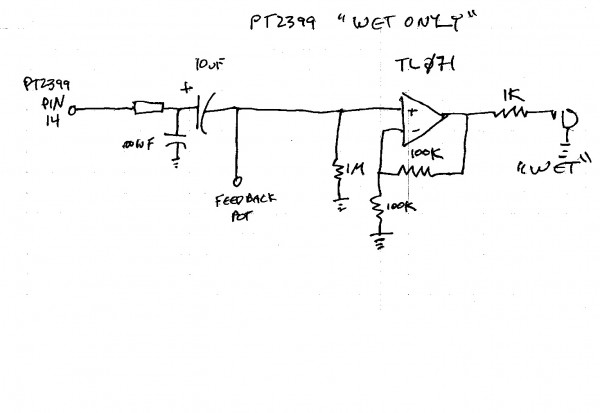

Question, I want to add a wet/dry control to a PT2399 design.
I see Befaco has that on their "Crush 3" PT2399 but I can't understand how it works--seems like they use two stages of a 13700 OTA for this, but still, not sure.
How would that work?
I'd want to get rid of the source signal somehow and just end up with the rest of the echo signal (so--what goes back into pin 16, controlled by the feedback pot, only), but I can't see how you can do that w/ the PT2399
Perhaps invert the input and sum it back in to the ECHO signal to only get "everything else BUT input"? (but that would in some cases kill the feedback frequencies as well?)
Does anyone know of a PT2399 design where someone has already figured this out? Maybe something simple I am missing?

gabbagabi wrote: | the simplest solution that comes to MY mind is attached....you could see how THEY mix together the dry and the wet |
Go GG!
Yeh, I will test again, but the "dry" signal is fully present in the "wet" at that output pin from my tests so far. I'll look again, maybe I got that wrong? I need "wet only", as often as possible
Back shortly..... _________________ Visit my AUDIODIWHY blog and website |

the output in the datasheet was on pin 15
i "moved" it to pin 14, the input has no longer direct connection to the output
GL

gabbagabi wrote: |
GL
HF
CU |
Thanks gabbagabi, I will try scoping PIN 14. If that's "wet only" then we are good....easy solution. _________________ Visit my AUDIODIWHY blog and website |

well, dont scope directly on the pin  |

Posted: Sun Jul 05, 2020 1:39 pm Post subject:
Glad to hear that it workz mate!
