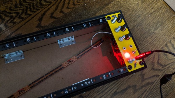

PostPosted: Fri Aug 28, 2020 8:53 pm    Post subject: Reply with quote  Mark this post and the followings unread
I want to start by saying thank you to y'all. This is my first foray into electronics and soldering. I built the case myself, bought some rails to go in, and started with a 12v-to-9v regulator and a 3-in-2-out mixer (using a TL084, because it's what I had - also got to learn and read about virtual ground). The panel is 3D printed and painted.
I'm looking forward to actually making some sounds soon!

Steveg
Joined: Apr 23, 2015
Posts: 184
Location: Perth, Australia
PostPosted: Sun Aug 30, 2020 2:56 am    Post subject: Reply with quote  Mark this post and the followings unread
Good one!
Banjo
Joined: Sep 27, 2009
Posts: 89
PostPosted: Sun Aug 30, 2020 9:40 pm    Post subject: Reply with quote  Mark this post and the followings unread
Hi dadinfinitum, nice start on your project! I wish I had the patience to make my builds so neat and clean. Keep building!

That looks great! Razz
Those bolts seem a bit massive though, I use M3 myself.
dadinfinitum
Joined: Dec 16, 2019
Posts: 41
Location: Maryland, US
PostPosted: Mon Aug 31, 2020 6:59 am    Post subject: Reply with quote  Mark this post and the followings unread
They are a bit large, but they fit the solder lugs I was able to find at a good price. Alligator clips still fit on them, which might just mean "good enough" haha.
