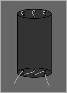

I've found something and I'm not shure is it a bead or choke.
It looks like cylindric piece of ferrite with six little holes and trough that holes wire goes is loop. I'll try to draw this (got no camera and cant find it on net).
I've found it in dead cable modem. Power goes straight trough it.

Posts: 24484
PostPosted: Thu Aug 14, 2008 10:28 am    Post subject: Reply with quote  Mark this post and the followings unread
This firefox has trouble displaying the jpg, but I guess you mean the "pig snout" thingies, those would be usable.
Like this one :
except it has more holes.

PostPosted: Thu Aug 14, 2008 10:30 am    Post subject: Reply with quote  Mark this post and the followings unread
I've uploaded it again. There it is.
So I'm fine. Grrrrreat.
