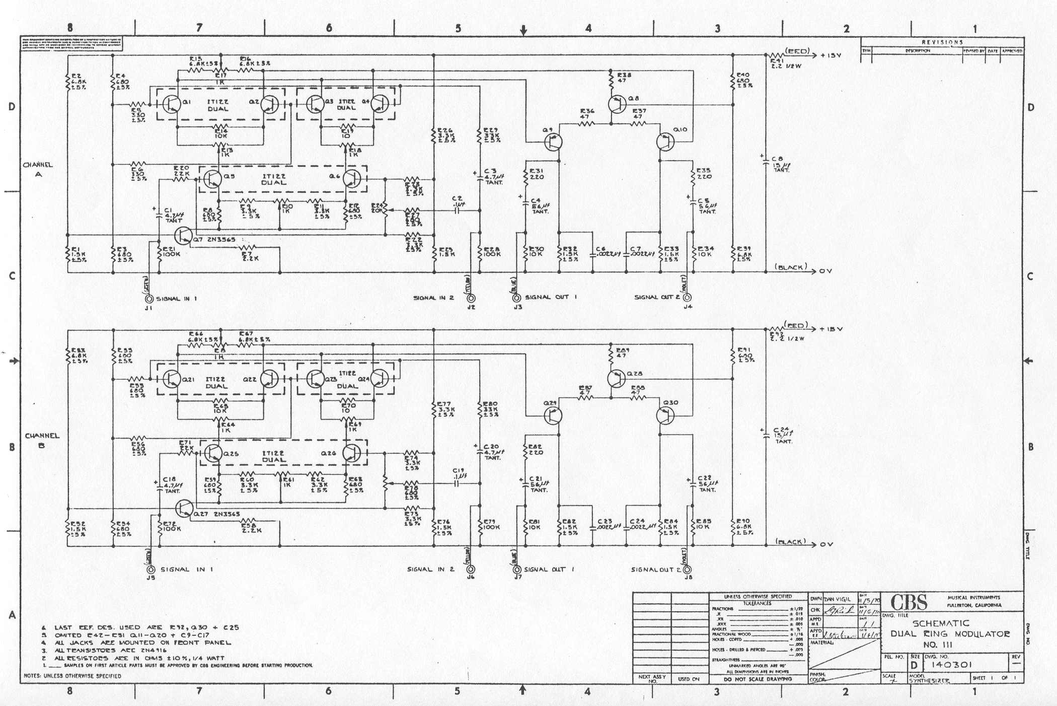

OK, Kiddies! Here's another Buchla pcb layout for you to play with. This time it's the 100 series ring mod, based off the schematics on the interweb (sorry can't find the link ATM)....
THis one is untested by me, but the layout matches the schematic 100%. I triple checked before I posted it.

Here's the one I got off the interweb. And now it's time for bacon!

So I've been testing it since last night. Last night it was completely not working. I'm using the new Kobicon 1/8" jacks from mouser and wired everything up incorrectly, because they changed the pinout. On top of that, they are flimsy. I will have to find better jacks.
Tonight I made another attempt, this time with the jacks wired correctly. The signal is getting all the way to the bases of the output transistors (Q9 & 10), but not any further. My guess is that R39 & 40 need to be changed since I subbed 2N3906s for the PNPs in the original circuit. They are probably not getting turned on enough to pass the signal through. I will experiment further in the next few days and let you know how it goes.

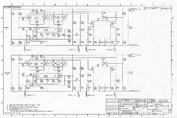

I think I found the problem. The CBS/Buchla Schematic has an error in it. R38, the 47Ω resistor that goes from Q8's collector to Q10 and the top matched pairs should actually connect to V+. Luckily I have two other versions of this schematic that don't have this error. I'll update the PCB layout ASAP.
R.

Quick update: I modified the the 47 ohm resistor as mentioned in my last post. Now it works like a charm! I've updated the PCB layout at the beginning of this thread. In my version I used MAT02s for the matched pairs, but it's quite likely that any matched NPN pairs will work.

Fix to CBS schematic
