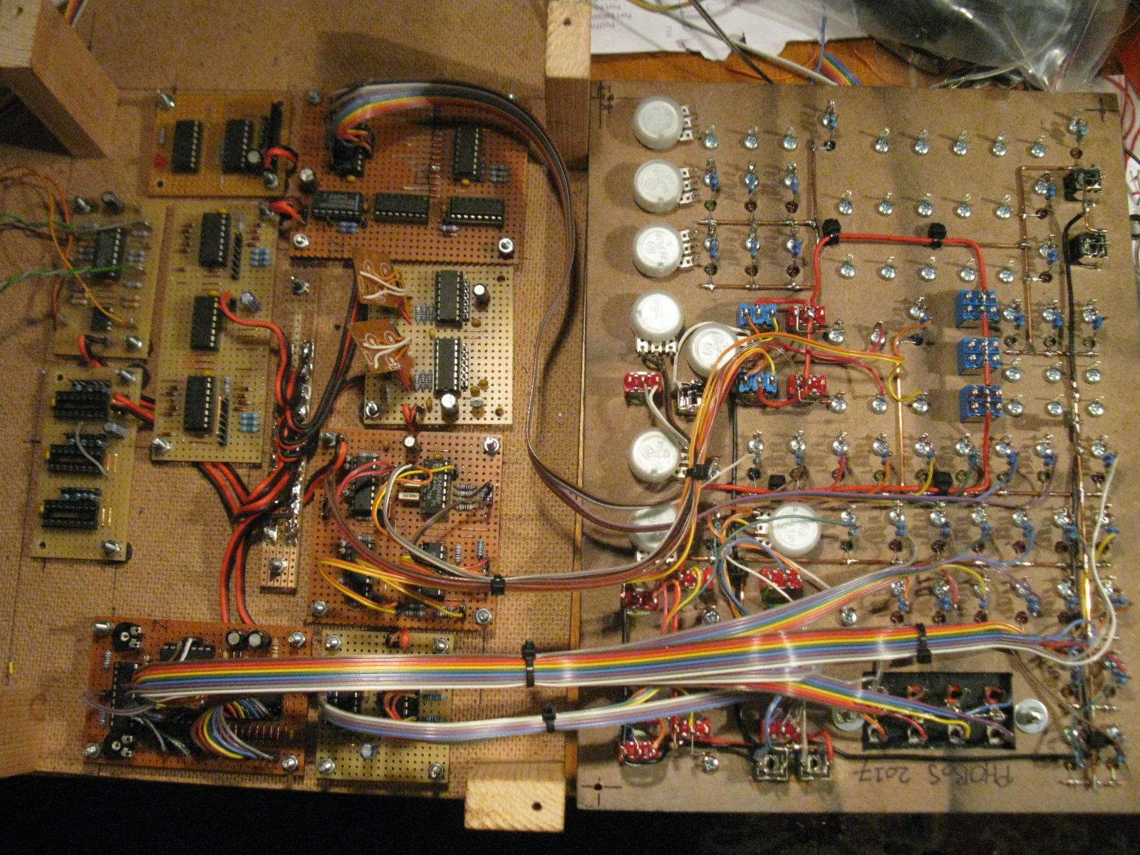

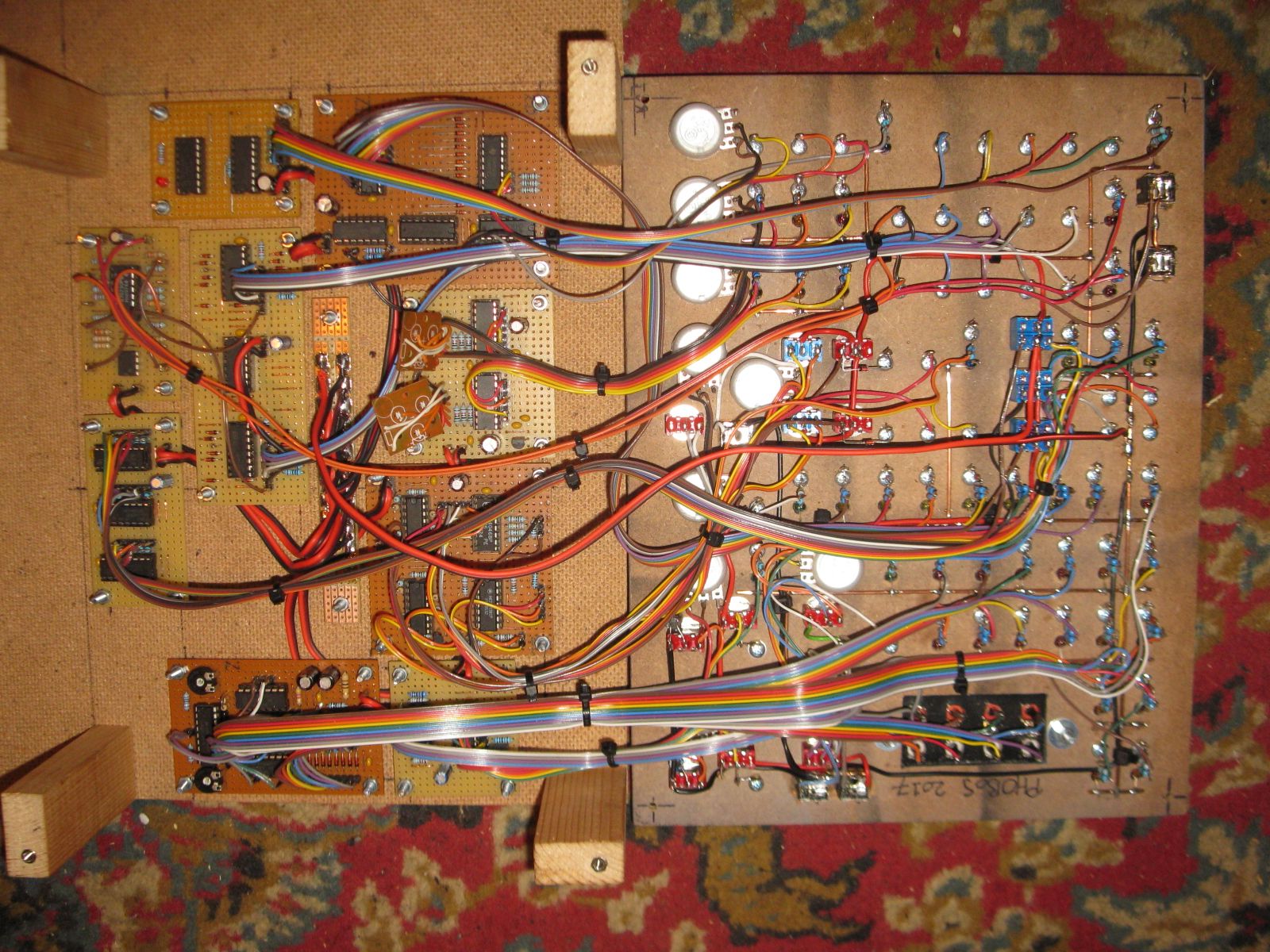

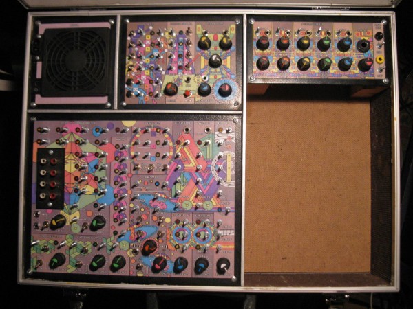

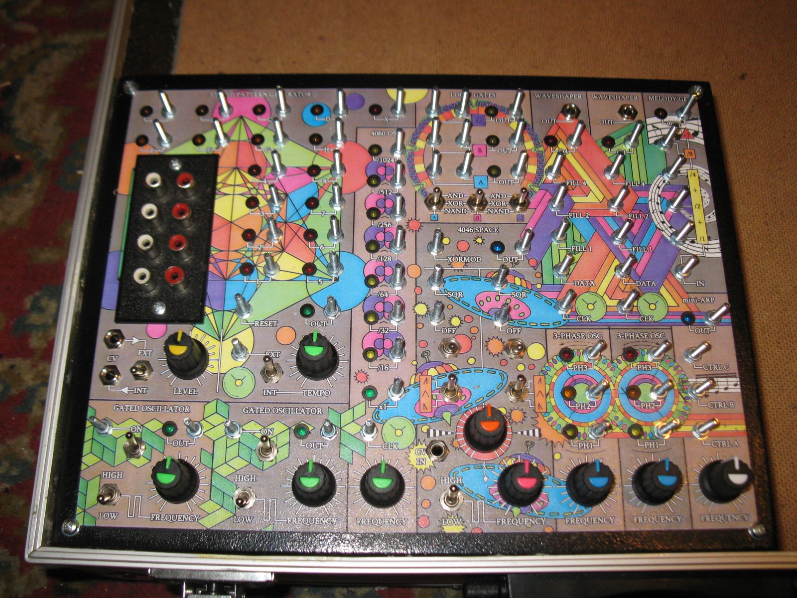

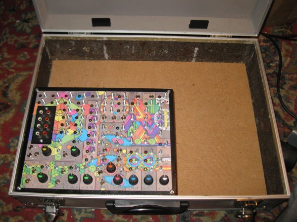

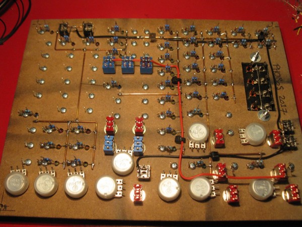

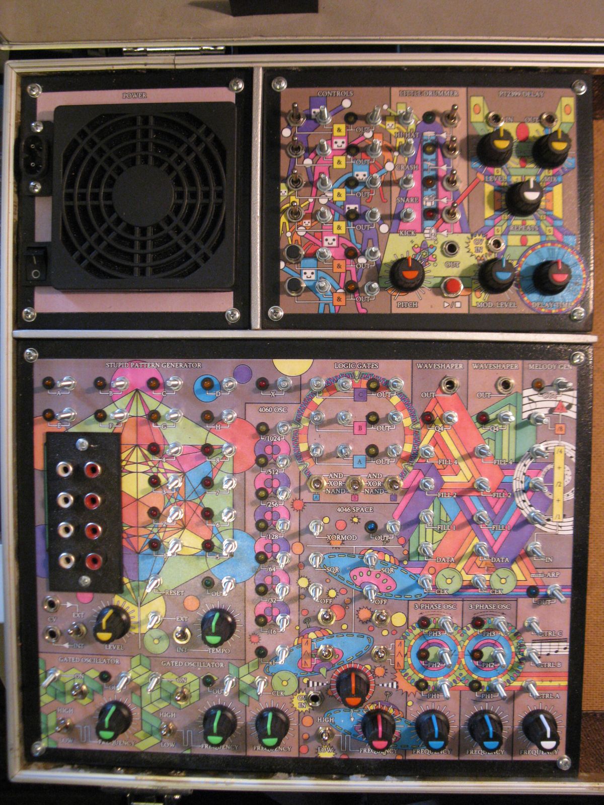

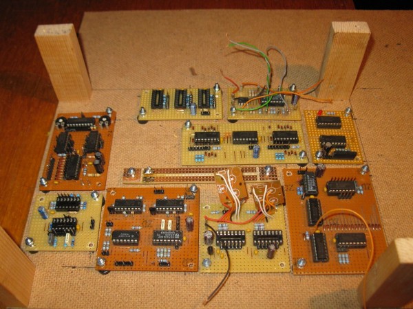

Over the years I built a lot of circuits that I never put in an enclosure or behind a panel. So I decided to combine a bunch
of those into a 'synth' which I named PHOMETHEUS. It's all going to be housed in one of those metal suitcases for easy
storage and it also saves me the trouble of building a case myself. Because it is going to incorporate a lot of circuits and
I don't have it fully planned out I will built it in parts.
I finished the first section which contains some digital/lunetta circuits. I will go into more depth and post some schematics
later but here's what's in it so far:
1 Stupid (patchable) pattern generator
2 gated oscillators
1 4060 oscillator/divider
1 4046SPACE+
3 AXN gates
2 3-phase oscillators
2 4015 based CMOS waveshapers
1 miniARP (with oscillator)
1 4017/4051 melody generator
and here are some gut pics

Posts: 5882
PostPosted: Wed Sep 27, 2017 1:16 pm    Post subject: Reply with quote  Mark this post and the followings unread

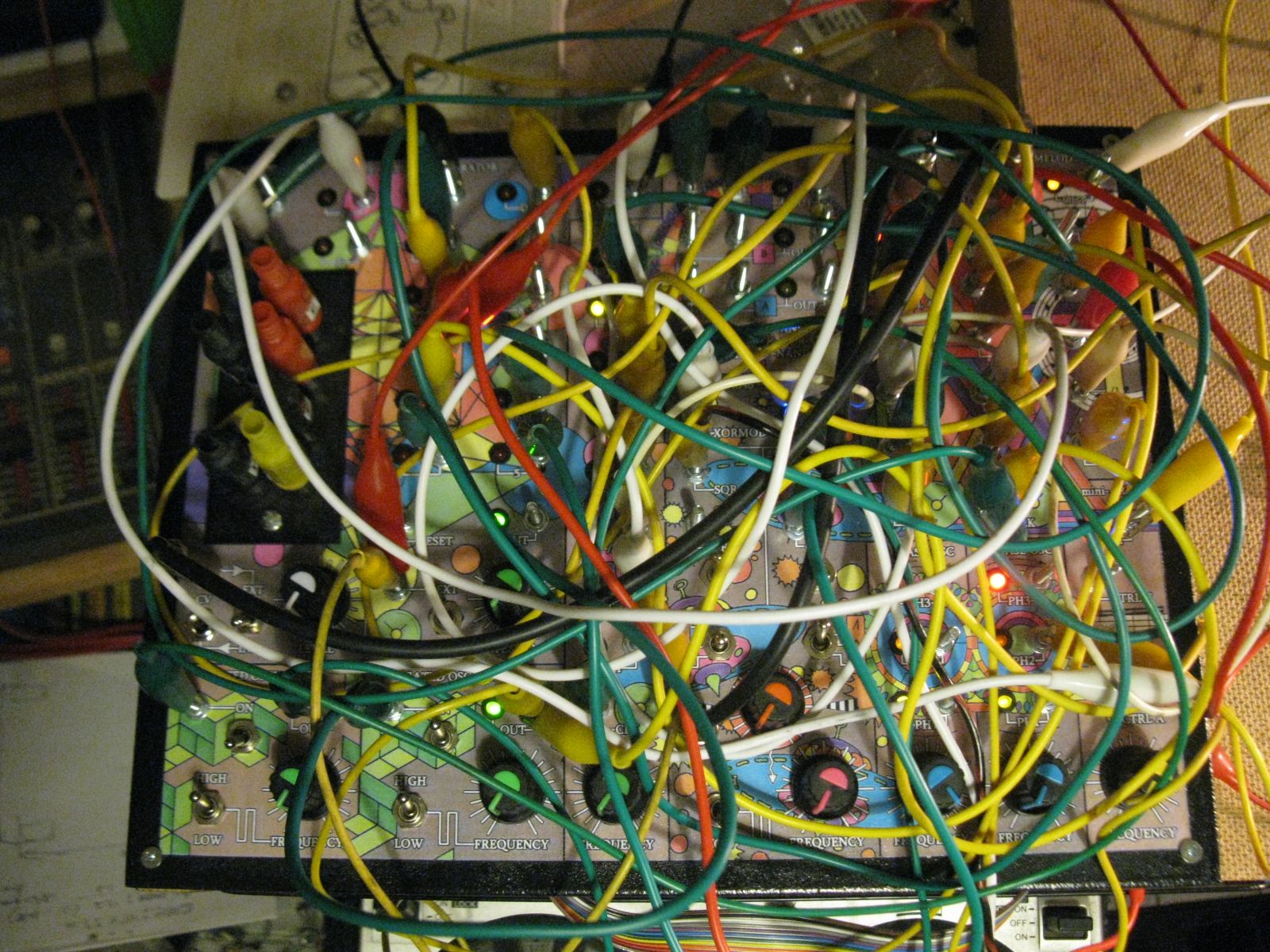

Here are some more photos and an excerpt of the first test which also used my RGB shroom drum and a bit of reverb.
Now I want to incorporate some drums as well but I don't know yet if I will built some simple circuits or use a drum
toy as I have a couple of those still waiting to be used. I also took a photo of the patch after the test. (some leads
are disconnected to shut it up at the end).

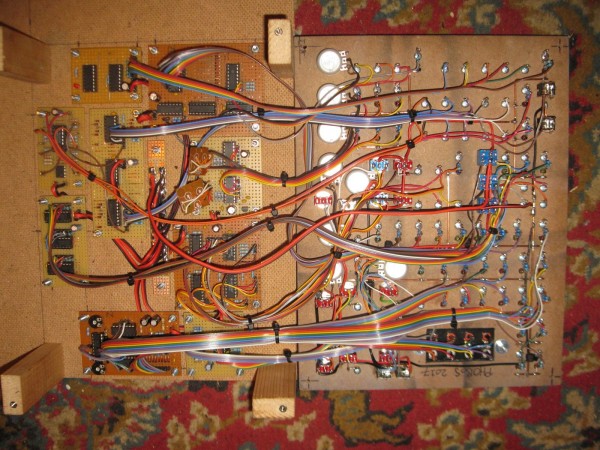

Posts: 429
PostPosted: Fri Sep 29, 2017 6:12 am    Post subject: Reply with quote  Mark this post and the followings unread
That sounds pretty cool! The repetitive bassline/drumline reminds me of Suicide, and the rest is like replacing Alan Vega's vocals with a crazy binary-bleep robot freaking out on Phobonetics and shooting lasers. Or something.
What a mess of patch wires! Sometimes I try to think of a better way for patching, one that doesn't obscure the LEDs and make it hard to manipulate pots and switches and require untangling to make changes. But there just isn't any other way, really.
Speaking of wires, it is most un-messy inside the box. I'm always amazed how your stuff seems so clean and orderly. I've gotten better, but I always seem to get into situations that require having wires cross and fly all over the place.
Thanks for the guts photos... they give me some clues on how to better organize things. I think the way I layout/solder my circuits has to change in order to be able to use ribbon cables... it's an extra step and requires more room... one has to bring the wires to a header.
Those rainbow ribbons you use... do they already have the female headers on one end, or do you solder those on yourself?
.:James:.
Posts: 5882
PostPosted: Fri Sep 29, 2017 7:30 am    Post subject: Reply with quote  Mark this post and the followings unread
thanks Laughing
The bassline is done with the miniARP. Although the number of notes it produces is limited (and I didn't actually use all of them)
it is nice to have something that is always in tune.
I did try to put all the controls at the bottom as much as possible but once you start patching a tangled mess is pretty
much unavoidable. The only thing you can do is indeed repatch and untangle it a bit once you have it patched up.
Nope, it just comes from a big roll I got very cheap many moons ago. It has no female headers btw. I did think about using
connectors and add an extra PCB with headers so I could unplug the whole panel but besides not having connectors for it that
seemed like an unnecessary extra step. I do add male pin headers on the PCBs to make soldering a bit easier though. I actually
don't really like to solder the ribboncable but it has a nice amount of colors and does make the end result a bit cleaner.
this is also a nice example of a pretty clean wiring job.

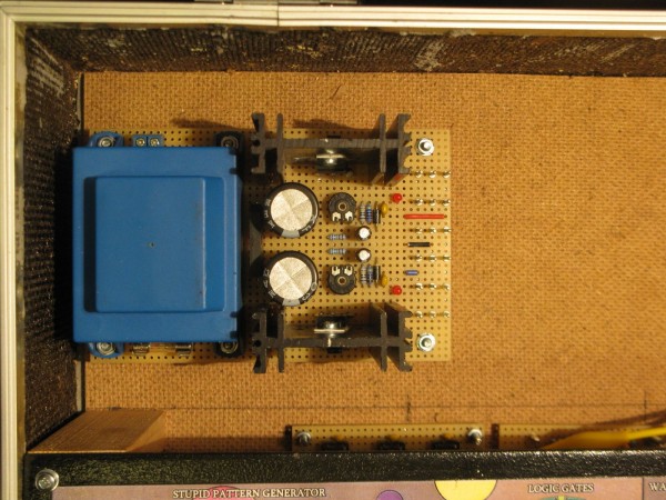

I added a bipolar supply. Most circuits will be single supply but I do want to add a mixer and it could come in useful
for some other circuits I might want to add too. Or at least I will not have the problem that I can't add something because
it only has a single power supply. The transformer is rated at 24VA so it should be enough to power everything.
The mains section will be insulated when everything is done. The suitcase itself is made of wood (hardboard) with
some thin aluminium on the outside so in that regard it is actually pretty safe.

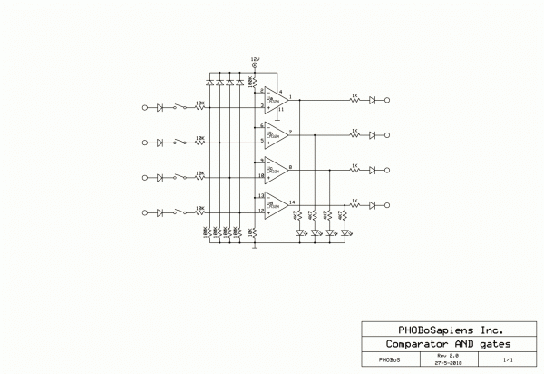

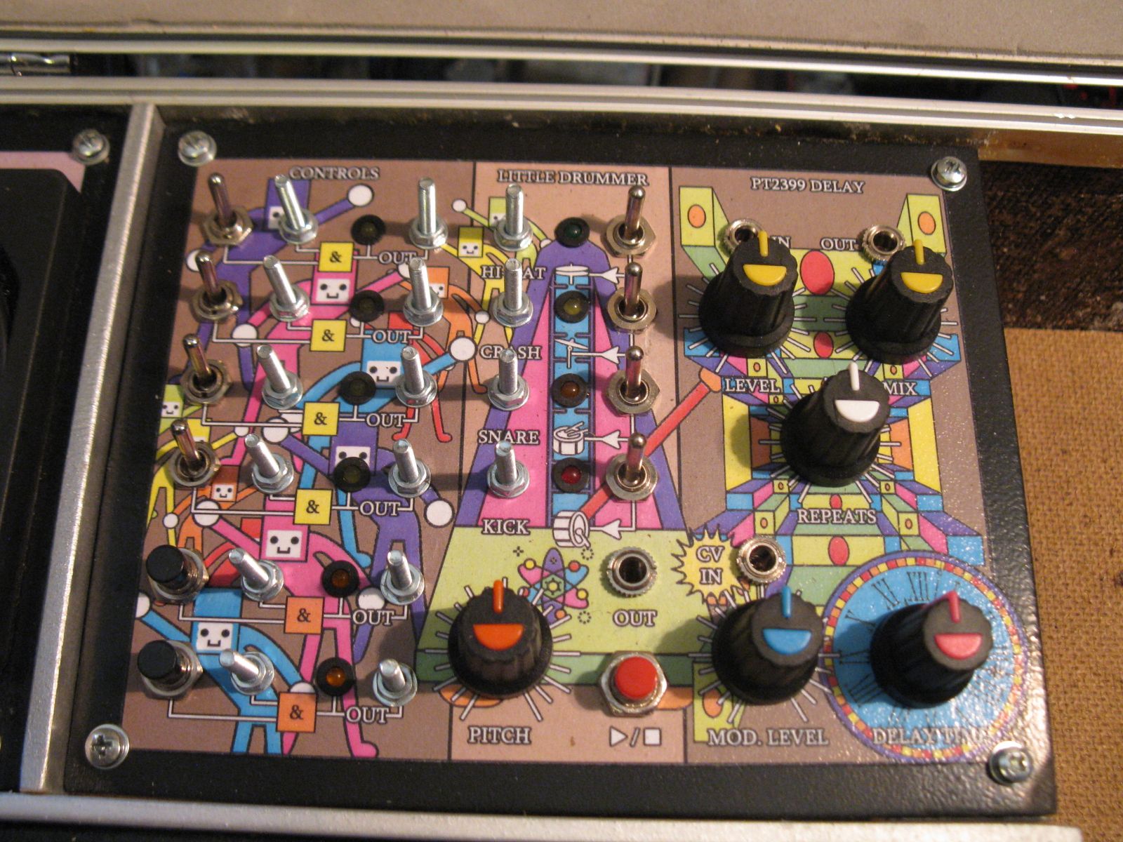

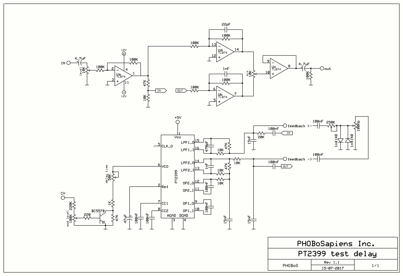

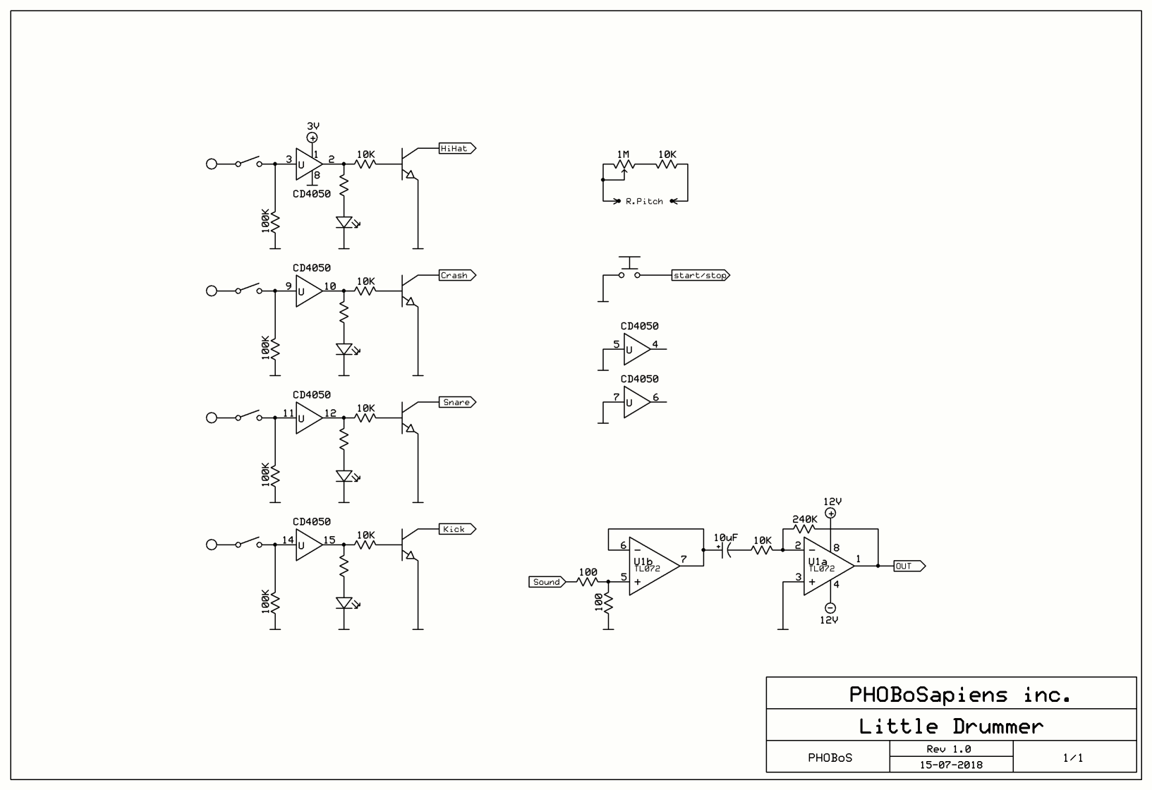

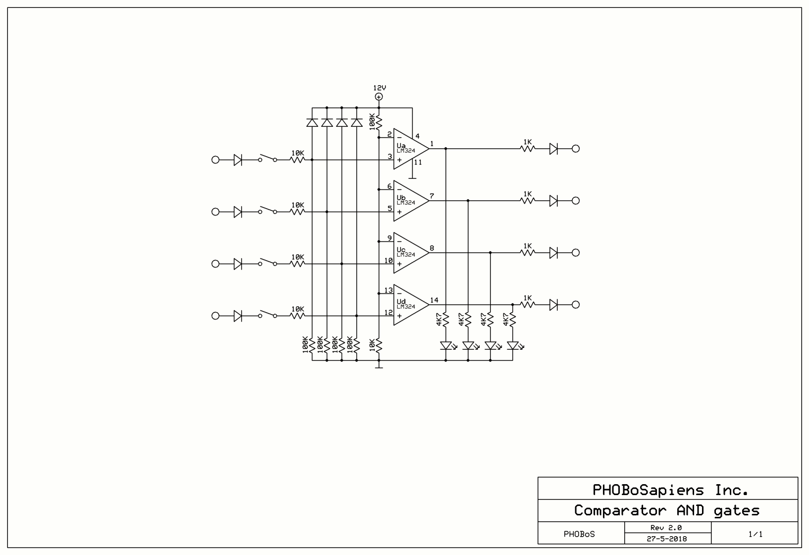

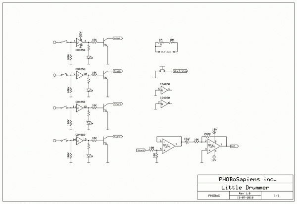

Some more circuits have been added.
I wanted to have some controls so I added a couple of switches. I added some comparators to these as I sometimes
run into problems if I want to use a 5V signal (from my modular synths) to control my lunetta's that mostly run on 12V.
I also used some diodes to protect agains negative and over voltage.
The little drummer circuit was kept simple, I had been thinking about incorporating some kind of priority encoder as
only one drum sound can sound at the same time but eventually discarded that idea. As it turns out it looks like it
already has it built in. I had a bit of trouble to get a decent output but eventually managed to get something useful.
The PT2399 delay was something I made years ago as a test circuit and I added some in/output buffers to it.

Posts: 5882
PostPosted: Sun Sep 01, 2019 11:09 am    Post subject: Reply with quote  Mark this post and the followings unread

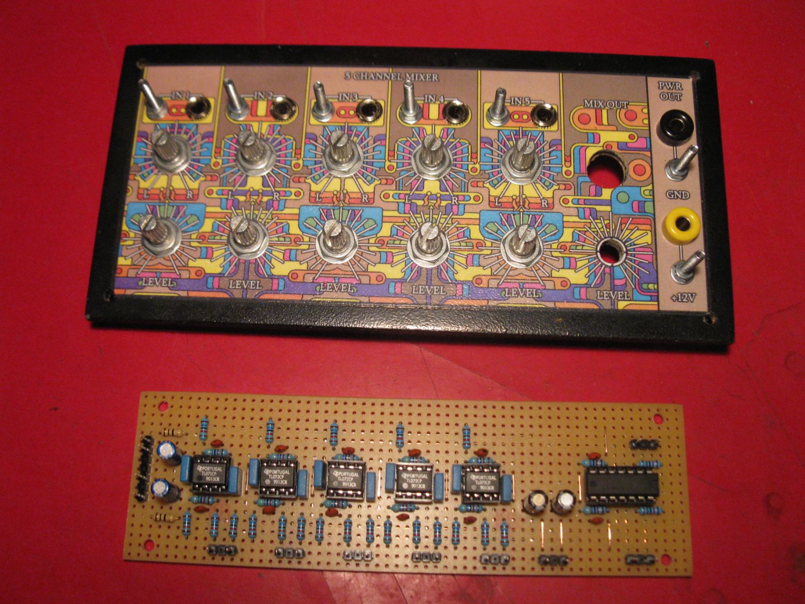

I started on the mixer section which will make it al lot more usable.
I also tweaked the little drummer a bit to boost the output signal.
 Filesize:  308.77 KB
 Viewed:  434 Time(s)
Posts: 5882

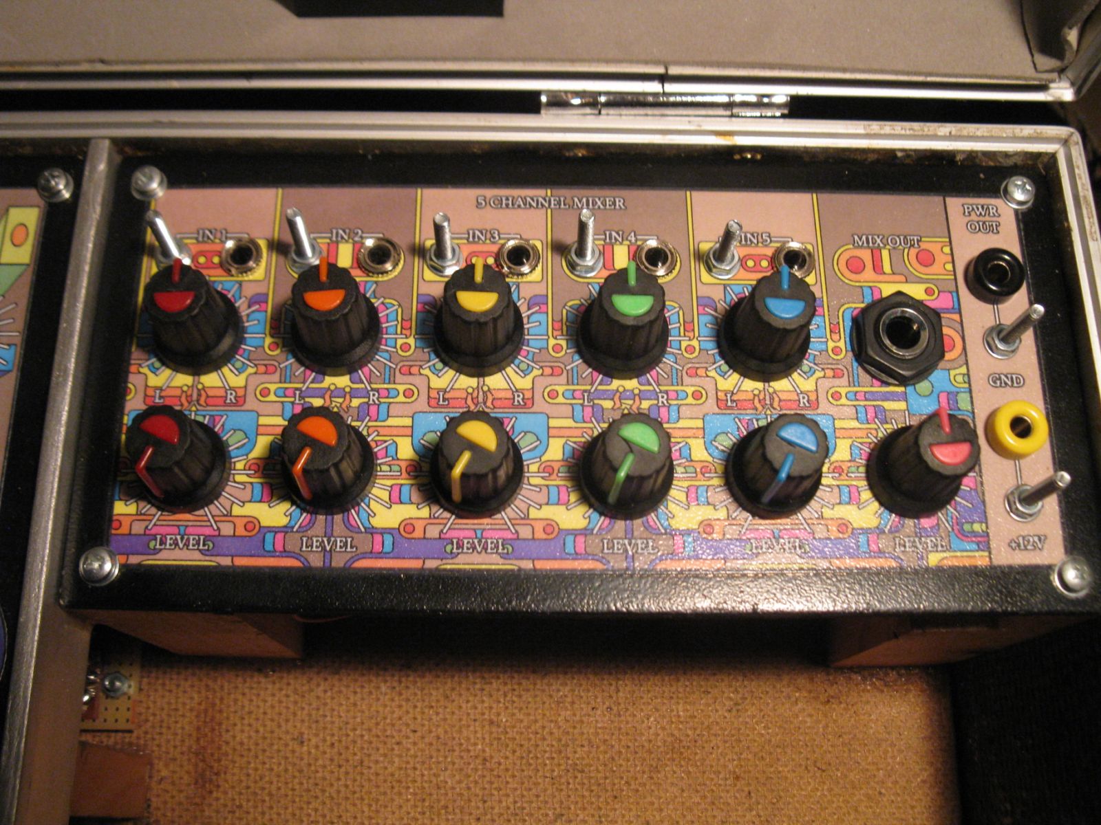

PostPosted: Mon Sep 16, 2019 5:22 am    Post subject: Reply with quote  Mark this post and the followings unread
Finished the mixer. I didn't have enough knobs of the same color so for now it has an assortment of colors, which is also nice colors
The circuit is based on the mixer I used in the asylum but without the input buffers.
Next I want to add some trigger inputs for the little drummer. It can only play one drum sound at a time and because of this it can't play
a new drum sound untill all the other inputs are low, eventhough the sound is long gone.
There also 2 oscillators in there that have a tendency to sync up. Not sure why it happens but it would be nice to get them isolated.
I do recall JovianPyx mentioning LEDs in the powerline for a PAIA module that had a similar problem, so maybe I give that a go.
Although I think they only run on 3V to begin with so the voltage drop would probably be to much. Maybe some resistors will
already do the trick. They' re actyally RGB LED drivers btw.
