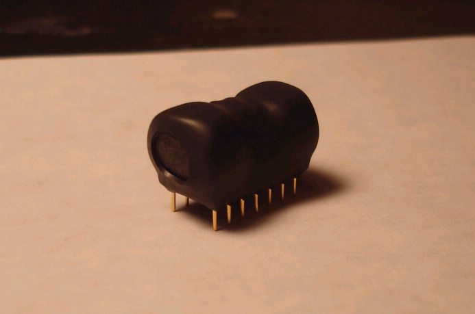

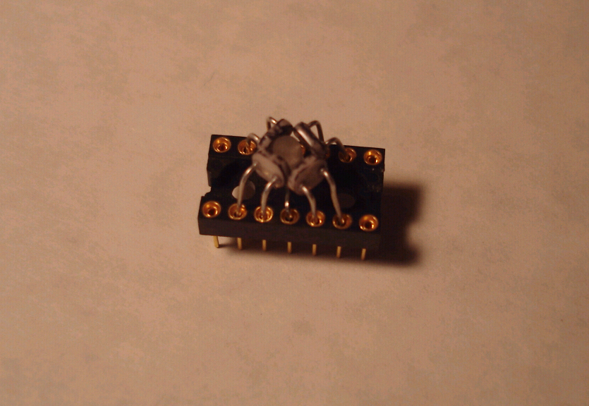

That looks nice. That's an incandescent inside?
edit; any chance of reposting this? As the actual LDR section is out of focus. (the camera seems to have focussed on the socket instead _________________ ACHTUNG!

Posted: Mon Sep 10, 2007 12:33 pm Post subject:
Yes, sorry for my lousy photographic skills. These pix were done a long while ago, and by now the little module is all packaged in shrink tube and happily phasing away in a four-stage phaser. FWIW, here are a couple more pix from that build:

Nice
But that's with an LED. I'm trying to think how we can do this with a filament bulb- which can be replaced if necessary- although apparently the chances of the bulb 'blowing' are remote. _________________ ACHTUNG!

Right, an LED. For my purpose at the time (a battery-powered stompbox) it was all about keeping current consumption low. But since that's no concern for something mains powered, I'd guess the smoother response of the incandescent bulb is preferable. Or in any case, it's more authentic to the original Schulte design, right?
Joe |

It's even easier with an incandescent lamp. Put the sensitive surface of 4 LDRs directly on the glass surface of the bulb (long wires ..). Wrap it with a sturdy black adhesive tape.
