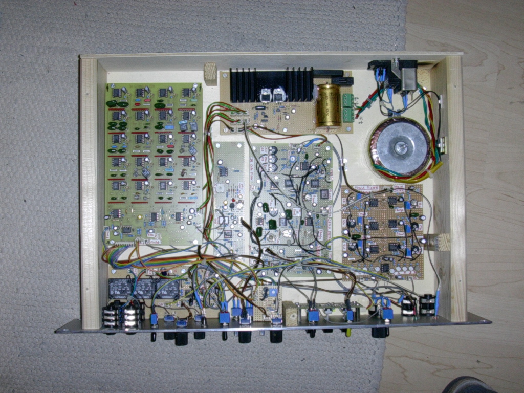

That's beautiful JH!
Will your PCB include all those features? (The stereo spread control especially interests me). Any special parts one might start sourcing for the future? (Don't worry, no obligation implied).

The two boards that are stacked on the left side are the 40 BPF filters.
That'll be the main thing on the new boards, too. Plus, I add some of the overall circuitry, like feedback control, stereo spread, etc.
The plan is to have a self-contained 40-band filter with just these two boards. This is enough to get the effect demonstrated in this sample:
http://jhaible.heim.at/string_filter/jh_string_filter_resonance_ob8.mp3
For (more or less) realistic emulations of string instruments (like in th esecond part of this sample: http://jhaible.heim.at/string_filter/jh_string_filter_benadecello_cs50.mp3 ), you need the 40-band filter plus a few broader resonances that I have created with a 3-band parametric EQ for each of the thre "presets", violin, viola and cello. (Thats the big veroboards with loads of trimpots).
Now, I expect much bigger interest in the 40-band filter than in the preset section, so I think I'll offer the 40-band filter PCBs separately. (Actually, these will be two equal boards for 20 bands each.)
I'm still looking for the best solution of the Para EQ stuff.
Maybe I'll make it part of the "Famous Fixed Filters" project.
Maybe I'll recommend using the Moog Parametric EQ board for this.
Maybe most buyers of the 40-band Filterbank have enough means for parametric EQ-ing already, and don't need a dedicated board for this at all.
I'll try to find out.
Meanwhile, I concentrate on the heart of it, the 40-band Filter Bank.
Back then, I used a design I thought clever - only to find out that it only was stable with NE5532 chips of a specific date code. That's why I didn't publish the old PCB layouts in the first place.
Now, I go for a different circuit topology, that also has a lot of benefits over the typical single-opamp solutions.
These will be 2-opamp biquads, which utilize a negative resistance to create a non-inverting integrator. (Also known as Deboo-integrator).
The main benefit of this - apart from it's low noise - is the low reistor spread, and zero capacitor spread. Which means, you need a lot of ...

Working on it ....

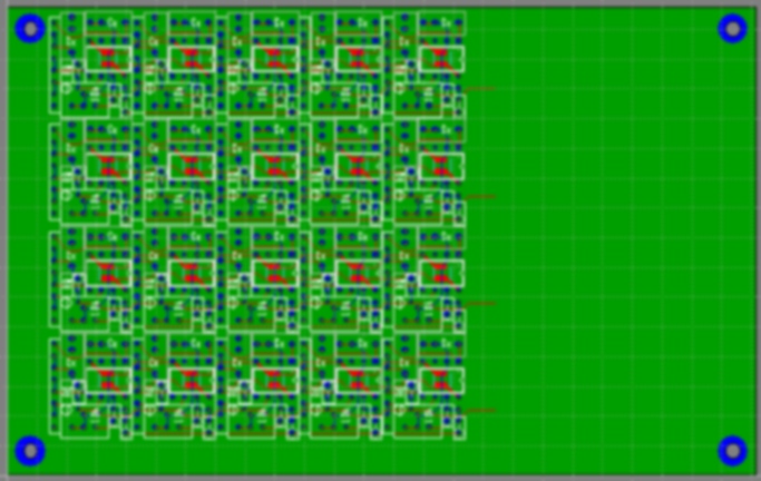

I plan to make the String Filter the next in line, after the Frequency Shifter and the Tau Reissue.
Board design is in a state that I can see where it's heading.
The 40 resonators will be distributed on two boards, as intended.
Also, there's the stereo spread stuff, a voltage controlled resonance, and an optional limiter.
The VC resonance will need a transistor pair like the LM394 or SSM2210 or MAT-02, or a selected pair of cheap NPN tansistors.
That's part of the whole concept, and therefore required.
The Limiter will need a Vactrol. I have yet do find out which type will work best, and the circuit can be adapted to use different types, too. It's a rather simple limiter - just to prevent harsh sounds from overdriving.
The Limiter is optional - you can simply omit the Vactrol and a handfull of passive components if you don't need it.

PCB design finished.
Prototye board ordered from Olimex.
Updated and re-located String filter page:
http://www.jhaible.heim.at/string_filter/jh_string_filter.html
(Contains screenshot of PCB design.)

Prototype board arrived from Olimex!
JH.

Filter section of one board (20 channels) tested.
The new filter topology works great!
And trimming these filters works like a charm.
They are stable, with TL072 chips.
You can use 10% capacitors here, and still you have almost one turn of the multiturn trimmers to walk along the peak of the BPF transfer function.
Still have to build the VC resonance and the Stereo Spread function, and the on-board PSU. If this works, I'll order a second board to build a complete 40-band prototype.

taking pre-orders now
I've been asked to make PCBs for my String Filter, and now I've redesigned the whole thing to make such a project possible.
Even though this project is somehow related to the Moog String Filter, it's not a copy, but developed separately, albeit AFAIK going back to similar sources. My main sources are:
Ian Fritz, "Filter Bank Design", Electronotes EN#107,
Bernie Hutchins, "A 39-Channel Variable Q Filter Bank", EN#115,
Arthur Benade, "Fundamentals of Musical Acoustics" 2nd edition 1990.
The filter choice for the 40 BPFs (State Variable with Deboo-Integrator) is my own.
You can read all about it on my web site http://www.jhaible.heim.at/string_filter/jh_string_filter.html , which also shows some intimidating photos of the old version.
The new version will consist of only 2 boards (or 3, depending on what you need).
Board 1 + Board 2 contain the whole 40-band filterbank part and the power supply (less mains transformer and fuses), with voltage controlled resonance and an opto-electronic limiter.

I'm only selling the printed circuit boards (PCBs) for this. You have to buy all the necessary components yourself.
I'll provide information how I've built my own string filter, using these PCBs (schematics, component overlay, BOM, etc.).

I've just recorded two short demos with the String Filter prototype.
First one is a fast Arpeggio from the OB-8, first dry, and then with String Filter switched on and off, and Resonance altered:
http://www.jhaible.heim.at/string_filter/jh_string_filter_2008_1.mp3
Second one is a String-like OB-8 sound, made more string-like with the String Filter
Switched on and off between phrases, to display the difference:
http://www.jhaible.heim.at/string_filter/jh_string_filter_2008_2.mp3
Note: Unlike the older sample ( http://jhaible.heim.at/string_filter/jh_string_filter_benadecello_cs50.mp3 ), the above has *no* Cello pre-equalization (yet)!
String Filter web page is also updated (with the two new samples and pictures of the prototype):

I haven't started with a BOM yet.
But I'll give you a rough overview:
You need 40 multiturn trimpots, 40 TL072 chips and 80 capacitors (10% tolerance or better) for the filter bank. Plus some extra opamps and one LM394 or similar dual transitor for the VC resonance, stereo spread, etc.
Plus a multitude of resistors and 100nF bypass capacitors.
Resistors: I recommend using 8-pin SIL arrays with four 10k resistors each; you need 40 of these. Alternatively, you can use 160 vertically mounted 1% metal film resistors of 10k.
If you want an optoelectronic limiter function, you need a VTL5C3 Vactrol.
(This is optional.)
