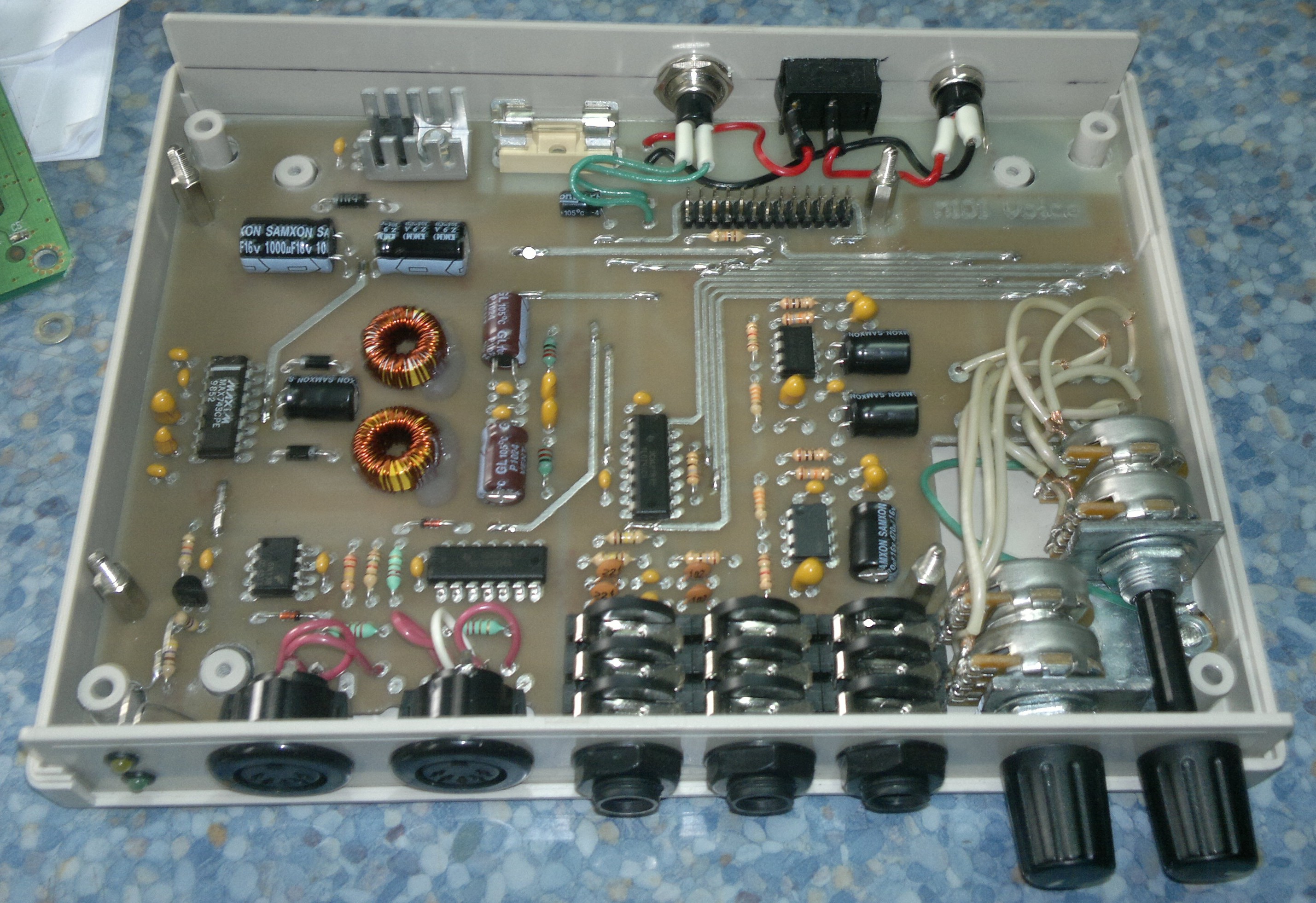

PostPosted: Mon May 09, 2011 6:00 am    Post subject: Yet another project Reply with quote  Mark this post and the followings unread
I'm reading this forum for about 4 months and it inspired me to build my own GM Voice project. Thank you guys, all of you.
After a long period of designing, and waiting for the board, and waiting for the DB60XG clone, and the MAX743, and a USB/MIDI cable (long live eBay and Chinese sellers), it took me only 3 days to assemble the whole thing. All other parts I bought in local stores, including the casing. I wanted it to be as much portable as possible, so I chose the slimmest possible casing that could fit the project, and voila! Very Happy
The PSU uses 7805 for the +5v rail (no surprise) and MAX743 as a dual output commuting power supply for +/-12v rails. And the whole thing is powered from an external and widely available 7.5v power adapter. I'm very pleased with this approach because it uses a single voltage supply and the 7805 does not get too hot. I also used a 1N4008 in series to protect against polarity inversion! Crying or Very sad
And it works so damn good! And because my M-Audio KeyStudio 49i has a headphone output, I designed the same for this project. For this I took the idea from here.
I only didn't mark the panels, yet.

PostPosted: Mon May 09, 2011 6:04 am    Post subject: Reply with quote  Mark this post and the followings unread
well thought build. great.
BTW where do you got the MIDI sockets? are they snap-in? i like them.

PostPosted: Mon May 09, 2011 8:41 am    Post subject: Reply with quote  Mark this post and the followings unread
The MIDI sockets are in fact 5 pin DIN sockets and, yes, they are snap-in type.
At the beginning I designed the board for PCB mount sockets, but I failed to find them locally. So I tried to find panel mount ones and I found those by chance in a store (in Bucharest...). I don't know any code or something.
I'll try to find some reference on the net.
