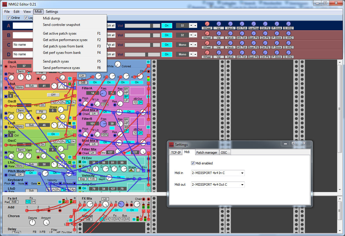

PostPosted: Sun Mar 11, 2012 1:59 pm    Post subject: Reply with quote  Mark this post and the followings unread
I've made a new beta version 0.21. If you want to test it, you can download it from the sourceforge page. It has a zip file with only the executables (bin), or one with the complete source code (src).
Some of the changes are these:
- I've added some midi functionality so you can use the editor without a usb connection. It has less functionality of course, but you can upload/download patches with it using sysex. You can also make patches and download intermediate results to the g2 using sysex. One of the screenshots below shows the menu options for midi and the midi settings tab on the application settings form.
- Also on another tab of the applications settings form you can configure the editor as a client to another editor. You can see that on the other screenshot. You could for example have the client editor on a laptop wirelessly connected to a pc that runs the editor using usb. While testing I found that the led- and volume indicator data is too big al load for wifi, so I made a setting on the settings form with wich you can set a timer interval for sending the led data ("Timer broadcast led messages" on the server editor).
- Also spend a lot of time making the VST compatible with Cubase 6. Cubase is a lot more demanding than Ableton, had a lot of troubles with lock ups of Cubase. I hope a tackled most of the problems, but not quite sure.
- Some other bits and peaces, you can read some more in the readme.txt file.
Hope I didn't make too many mistakes in this one.

PostPosted: Mon Mar 12, 2012 1:54 pm    Post subject: Reply with quote  Mark this post and the followings unread
Awesome work, Bruno!
I tried the sysex feature but the editor lists devices I don't have in the midi in list (UM-ONE, DJ console and Midisport 4x4). The midi out list seems to be OK, though.
Albert
brunov
Joined: Aug 03, 2011
Posts: 227
Location: delft
PostPosted: Mon Mar 12, 2012 2:20 pm    Post subject: Reply with quote  Mark this post and the followings unread
Ha, you're right! That's strange, those are my midi devices of course.
Probably my settings where saved as object properties and are now part of the executable Sad
Maybe restarting the editor helps or otherwise you could have a look at the "G2_editor_ini.xml" file, maybe edit the "midiInDevice" "MidiOutDevice" attributes.
Meanwhile i'll have a look at it, also just found another bug: sending some note events while midi is enabled crashed the editor.

PostPosted: Mon Mar 12, 2012 2:38 pm    Post subject: Reply with quote  Mark this post and the followings unread
That was the first I tried but even if I delete the xml file your devices are listed Very Happy
Albert
brunov
Posts: 227
Location: delft
PostPosted: Tue Mar 13, 2012 2:10 am    Post subject: Reply with quote  Mark this post and the followings unread
Fixed the two midi problems Albert: device listing and crash on note event.
I didn't make a complete new version, so better to delete the old 0.21 and download the new fixed 0.21 version.
Hope this one works better...
