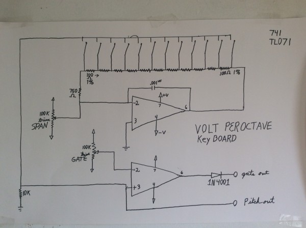

Just in case anyone else was looking for something similar. This is what I finally got working. I'm sure I didn't invent in, but I sure couldn't find an easy solution that worked when I built it.
This works on my bass pedals and a 2 octave keyboard project I did.
(Update) when I tried this with a TL072 it caused an issue. I believe the heat caused by the comparator/gate side of the dual opamp caused a temperature drift issue in the voltage control side of the IC. I couldn't keep the span in adjustment.
(Another update) I have used this circuit all winter long in a set of bass pedals and a 2 octave controller with no problems. Turns out the radiant heat in my house is very stable at 72 degrees. Spring is here and the house got up to 78. And the span drifted substantially.
I have ordered some opamps with better drift ratings to try. I will post back with results.
I have high hopes for the OP177 op-amp. At first glance it appears it may go right in the IC socket and has much better temperature drift ratings.
I spent a couple of hours fighting that new TL072 circuit before I finally realized I wasn't trying the other circuits when it was that warm in the house.
(Update) OP 177 opamp cleared up the temperature issues.
Great thing is you can build this with IC sockets, try it out with TL071's, or something you have, and buy the pricier OP177s if you need the accuracy.
I believe the OP177s were about 2$ each American at Digikey.

holy crap this works? its so simple. Ive got two salvaged 44 key Organ keybeds Ive been wondering what to do with. Only two tl072s 750 ohm resistor then each key seperated by 100 ohm? this seems way to simple. Gonna give it a try!

If I did it right, this is a link to a video of me using the circuit in a set of bass pedals.
There are 3 videos of that project.
There is also a page on here, in DIY hardware and software, developers corner, titled easy DIY analog synth project.
I have built 3 of the circuit. One in a one octave bass pedal set, one in a 2 octave keyboard. They both worked well. The third I built for a 44 key keybed and am getting a massive temperature drift issue. The span won't stay in adjustment. I ordered a better trimmer for the span adjustment, but I'm not sure if that is it yet.
I used 2 TL071s in each of the first 2 builds, and used 1 TL072 in the third build. I can't think of a reason why that would have an affect here, but I could be missing something.

As for glide, I am working on adding glide on the breadboard. A capacitor to ground on the CV pitch out will cause glide. I'm just working on values and control.

I have seen a guy use cut up, medium gauge guitar strings soldered together (push down to contact the buss bar) to make a test keyboard.
If your 100 ohm resistors aren't 1% the note spacing may not be correct. I used. 5% in one project but matched them with a good ohm meater
Good luck with it. It's a little tricky to get the gate trimmed just right. But it's fun when you get it going.

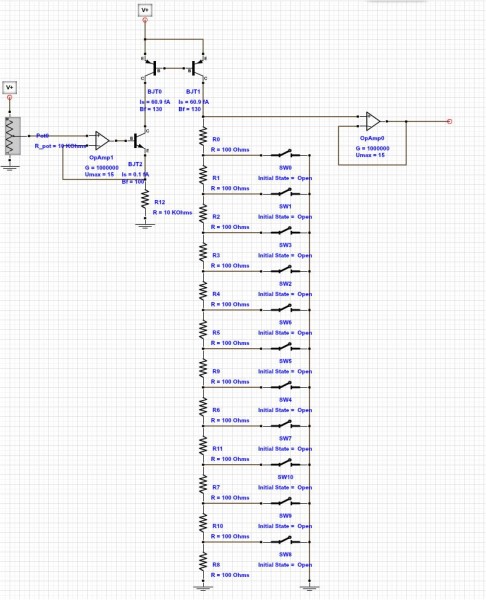

PostPosted: Thu Apr 14, 2016 4:10 am    Post subject: Reply with quote  Mark this post and the followings unread
The downside of this approach is that you will sound off-tune when you press more as one key.
Thinking about this, I produced the following diagram.
NOT TESTED! Just for considering...

Hi grumble. It is actually low note dominant. It does play the lowest key you are pressing in tune.
I got the (resistor chain in the feedback loop) portion of the schematic from the EFM keyboard converter schematic.
I can't get my mind wrapped around how it is low key dominant. If anyone can help with that I would greatly appreciate it.
I will give your schematic a try Grumble and post back with results. It looks promising. Thanks for posting it.

I like your schematic grumble. Am bread boarding it now. It appears it will be high note dominant as drawn.

PostPosted: Thu Apr 14, 2016 7:42 am    Post subject: Reply with quote  Mark this post and the followings unread
Sorry, made an ERROR forgot a connection (line in RED)

I tried it out grumble. I didn't get it working.
The constant current supply voltage showed up at the collector of the first PNP. (The one on the left) but not at the collector of the second PNP
I used 2n3906 PNPs
2n 3904 NPN
i tried a different constant current source I have made up for experimentation, got voltage tracking. I was looking at it bacwards earlier. Is low note dominant as shown in your schematic. Switching the resistor chain ends would also require switching to an inverting op amp configuration to make it high note dominant. Just switching wires would make low notes high, high notes low.
It needs a trimmer in the feedback loop of the output op amp to adjust the span to track correct.
Let me know if I'm wrong on any of this.
I hate bread boarding. So easy to miss something over a loose contact. But I'm pretty sure the span adjustment will be necessary.

PostPosted: Thu Apr 14, 2016 8:18 am    Post subject: Reply with quote  Mark this post and the followings unread
Just caught your update grumble. will try the constant current again.
Still needs a trim to adjust span to volt per octave. I think.

PostPosted: Thu Apr 14, 2016 9:09 am    Post subject: Reply with quote  Mark this post and the followings unread
Got it working.
Grumble (YOU ARE THE MAN!!!) works great. I'm still trying to figure out what's at work in the method you used to adjust the span. I was just seeing that as a voltage adjustment for a constant current supply.
Can you toss a comparator in for a gate signal in your schematic?????
I have already added one, but my chicken scratch hand drawn schematic won't be near as legible, and I'm sure your solution may be better than mine.
To masterofstuff . I don't see why a resistor ribbon type system wouldn't work on either of these.
On a 44 key keybed GRUMBLES schematic was easier to get tracking good, and is a little more linear using the exact same resistor chain key-bed

PostPosted: Thu Apr 14, 2016 10:01 am    Post subject: Reply with quote  Mark this post and the followings unread
Cfish wrote:
Got it working.
Great! You can use the same comparator as in your org. schematics.
I'm at home and don't have the program here (btw its a free program).
You got that right! And it even works better with an FET, because the base current is added to the total current in the current mirror (the upper two pnp's)

I wanted to post this Ken stone schematic here in case anyone wants to try it out.
I did it in a set of bass pedals. It worked ok but had a little key lag. I think that was a problem with the generation of IC I had. But I haven't done enough research to confirm that.
(Update) this circuit was talked about on another thread and prgdeltablues noted that the data sheet calls for x10 value difference between the capacitors on pins 5 and 6 not x22. And the minimum values are 100n and 10n.
The minimum values worked on a set of quick momentary switches I set up. But may not be enough debounce for other switches.
 Filesize:  1.2 MB
 Viewed:  837 Time(s)
