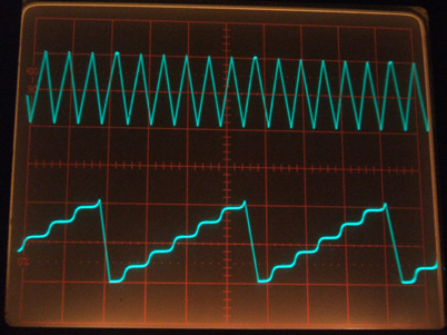

Hmm, so attenuators really aren't important for this module?
well, it's up to you to make that decision. i realize it's hard to know until you actually get using this module.
in the scope shot that shows the rising edge of one function modulated by another one, is there any attenuation of the CV signal?
nope. the control is set to minimum.
Theoretically I would expect that when you apply an unattenuated CV to a rising function, it would hardly move at all when the CV is low and zip to it's maximum value very quickly when the CV is high
it's the opposite. the rise/fall time increases with positive voltages. since the control is set to minimum [0V], 0v in cannot make the slope any sharper- however a negative input voltage would.

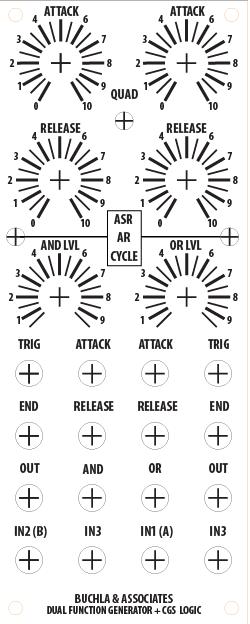

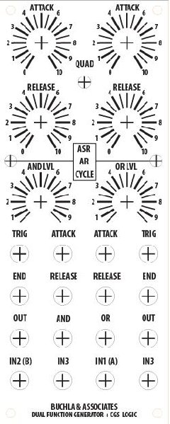

/mr wrote:
Is it wrong to listen to the sound of a 500Hz signal if it comes from a module that is similar to the ADSR found in hardwired synths?
Wow, this gives me an idea for a new mod. Wouldn't you need some kind of switch to get a more narrow control range? Because if you were triggering your envelope in the audio range and you turn the attack and release knobs past say.... 5% of a turn, they would never reach their maximum value, unless you modified the range so that first 5% takes up the entire sweep of the pot.
If one thinks in terms of audio signals vs. control signals, one loses many of the beautiful benefits of the open modular concept and the principles of voltage control. Buchla and Serge made some of the most open and versatile modules ever, and it's almost blasphemy to call a Buchla module a "controller"
Wasn't it buchla who physically segregated the audio and control by using different types of jacks?
Are the volume faders important on your mixing desk? Wink
Heheh. I just spent all the time since my last post trying to find a better use of the space the attenuator pots take up on my panel. Damn you for giving me second thoughts Wink It just occurred to me now that the reason attenuation is not important in topp's scope shot is because the modulating signal is much faster than the slope it is modulating. If it were the other way around it would be like a VCLFO and I certainly wouldn't want a VCLFO with no CV attenuation.
Anyway, what I came up with was to leave off the peak circuitry and replace it with a CGS Analog Logic board which provides the same functionality and more. The way the switching jacks were to be set up, for both the peak and trough(and and or) depending on which cables are plugged in they can compare the following signals:
A. Both function generators
B. Both function generators and one external signal
C. One function generator and one external signal
D. One function generator and two external signals
E. Two external signals
Now that I want the attenuators back I'll have to make some sort of compromise Evil or Very Mad
 Filesize:  34.32 KB
 Viewed:  179 Time(s)

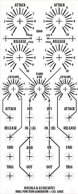

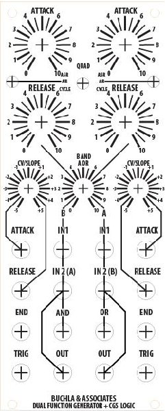

sound wrote:
It seems that design a front panel means compromise! If you choose A win X but lose Y, If you choose B You win Y but lose X Very Happy
You can say that again! Here is the 5th(and better be final Evil or Very Mad ) version of my panel. Compromises are the Attack/Release CV/Slope for each function are controlled by the same dual gang pot, and the amount of function A into the And + function B into the OR share a dual gang pot as well. I'd still like to be able to switch off one of the attenuators for each function, should I ever not want both the attack and release CV attenuated the same amount, but I don't have room for any more switches. Does anyone know where I can get a 16mm body, 1/4" smooth shaft dual gang center-detent pot with push-pull SPDT switch? Laughing
God, this thing's gonna be a nightmare to put together. 5 PCB's(including LED drivers), attenuverters on a perfboard, 8 switching sockets etc... but it'll be worth it Cool
 Filesize:  38.74 KB
 Viewed:  194 Time(s)

neandrewthal wrote:
I like the idea, but I think your going to have to break down and go to a 3U panel...it's getting crowded in there!

clickmrmike wrote:
Definitely... and it's still just a dual Function Generator. The original b281 is a quad! Laughing
You can try all you want but I can never listen to reason Wink If it's too crowded I'll probably leave of the attenuverter circuitry. Actually, 2U is the maximum size I can make myself, so I just do those since I'm a cheapskate. I'm obviously gonna have to take a hit on the Klee and MFOS sequencer though.
BananaPlug wrote:
Neandrewthal, maybe the thing to do is build the Analog Logic as a separate panel. More flexible that way too.
I would, but I have this obsession with filling every square inch of panel space. Just a quirk I guess. I cannot stand to see one empty space that could hold another pot or jack. Also, the way I have it set up, you can still use the analog logic separately. You just have to turn down the hardwired attenuated EGs, then patching in the external inputs will override the unattenuated EGs.
