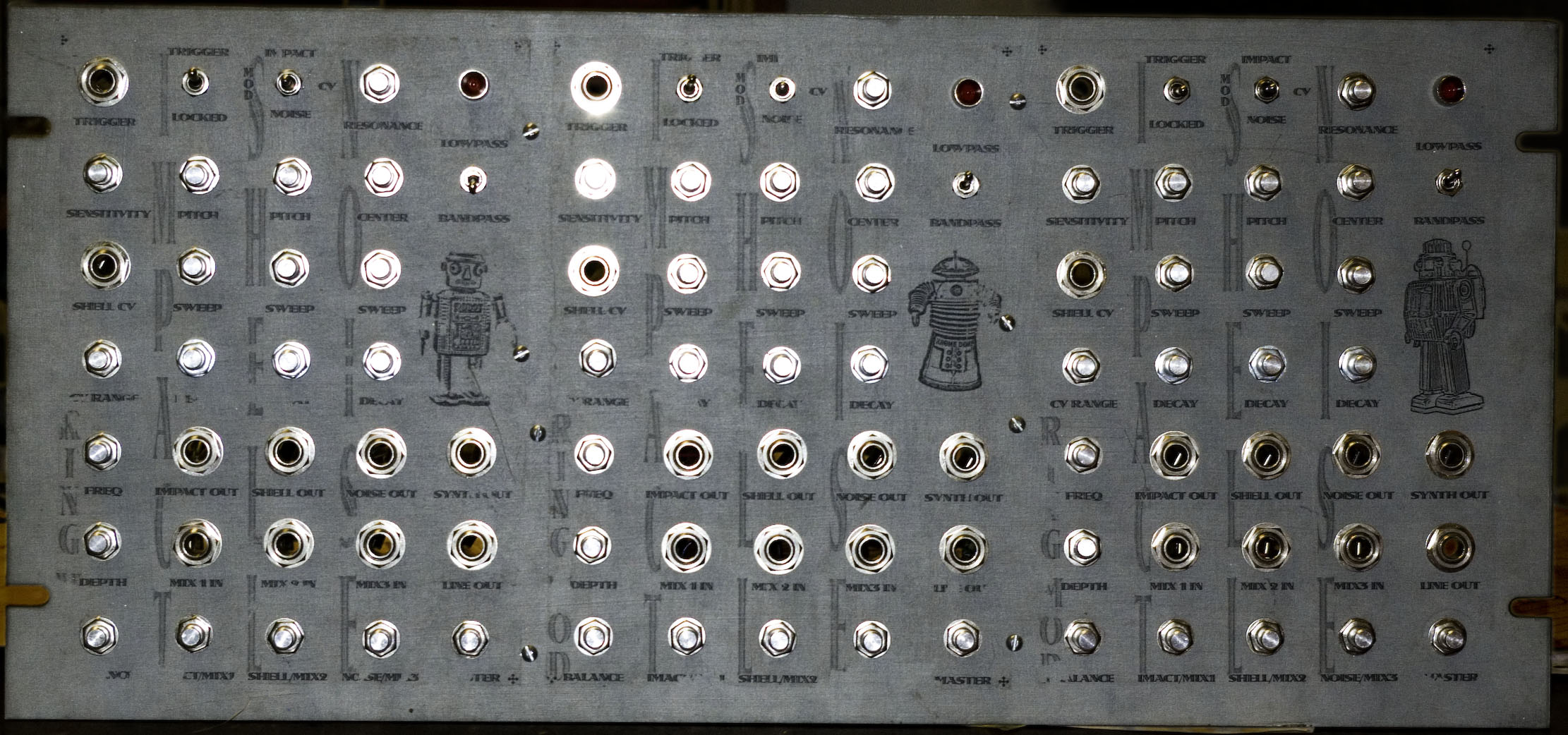

RKHobbs
Joined: Jun 10, 2008
Posts: 19
Location: Maryland
PostPosted: Wed Oct 14, 2009 7:52 pm    Post subject: Reply with quote  Mark this post and the followings unread
Make mine a triple.
Triple MPS
 Filesize:  456.89 KB
 Viewed:  843 Time(s)
