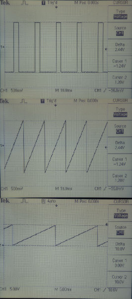

PostPosted: Thu Mar 11, 2010 4:50 am    Post subject: Reply with quote  Mark this post and the followings unread
Just finished one living VCO core and the driver module. Sound great already but I have a question regarding the generated sawtooth. I connected a software oscilloscope and the sawtooth is showing spikes. Is that normal? Or should I check the various components? Since I'm a n00b Wink - could use some suggestions. TIA!
 Filesize:  23.8 KB
 Viewed:  27244 Time(s)

PostPosted: Fri Mar 12, 2010 1:56 am    Post subject: Reply with quote  Mark this post and the followings unread
It's probably an artefact from your measurement setup.
My guess is: High bandwidth of the scope, connected with a long, un-terminated wire.
JH.

PostPosted: Fri Mar 12, 2010 10:01 am    Post subject: Reply with quote  Mark this post and the followings unread
I was going to suggest the same issue with this being an artifact of the probe. However, your ramp waveform looks like it is +8 to -10, or 18 volts pk-pk. Did you want your output that 'hot'. I would have expected something less.

PostPosted: Fri Mar 12, 2010 2:27 pm    Post subject: Reply with quote  Mark this post and the followings unread
Oh - I didn't look at the scale. Should be +/-5V after the amp, not more.

PostPosted: Sat Mar 13, 2010 4:37 am    Post subject: Reply with quote  Mark this post and the followings unread
thx! I connected the oscilloscope to the rightmost pin of the SAW_n connector so the graph should be showing the 0 ... 10V saw from the VCO core. Anyways, I'll start working on the other cores. compare the different outputs and report my findings back here.

PostPosted: Tue Mar 16, 2010 1:50 pm    Post subject: Reply with quote  Mark this post and the followings unread
As promised Smile
Everything's ok now! Borrowed a Tektronix TDS 210 scope from work and these are my results. First the pulse, then the saw and as last the 10V saw. Keep you posted on my progress!
 Filesize:  111.57 KB
 Viewed:  287 Time(s)
