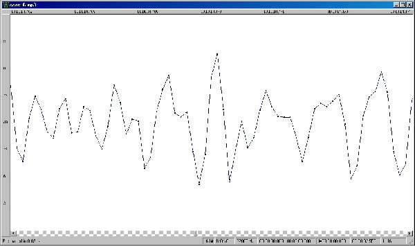

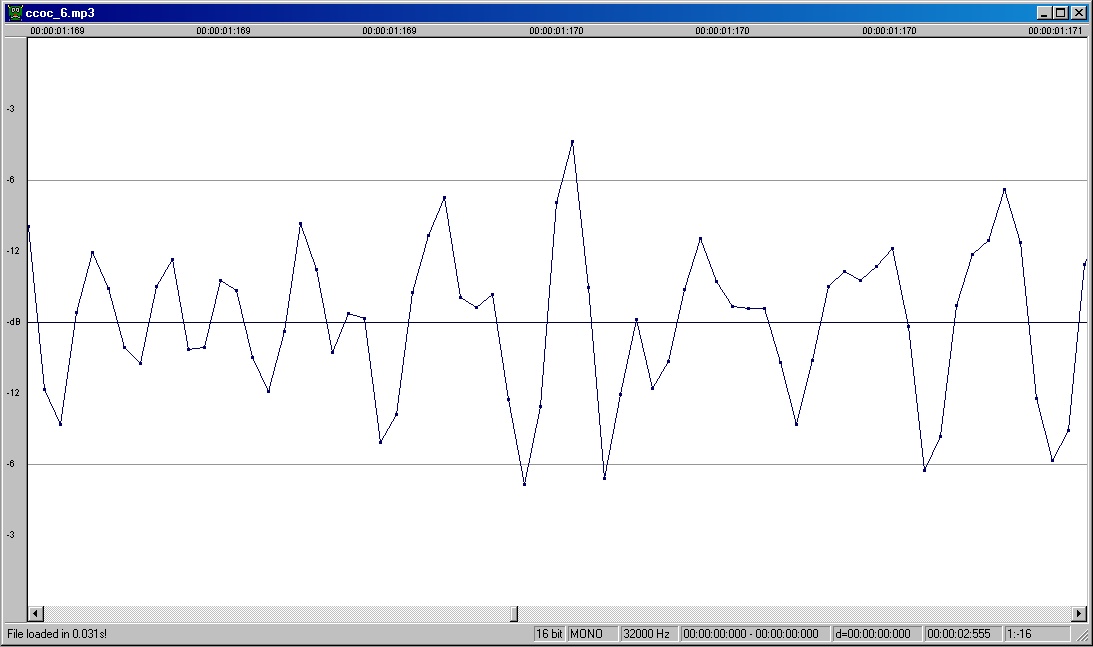

richardc64
Joined: Jun 01, 2006
Posts: 679
Audio files: 26
PostPosted: Fri Feb 11, 2011 12:32 am    Post subject: Reply with quote  Mark this post and the followings unread
The bottom doesn't get cut off. The input signal gets shifted up by R1. The only way the bottom -- or top, for that matter -- could get chopped off is by overdriving the transistor with too large a signal; more than 2-3vpp or so. True, the output isn't symmetrical about it's center, where ever that may be, but that can be partly corrected by a capacitor at the output.
I don't have a 'scope, but I captured images in Wavosaur of one of my samples that used this VCA. I don't see any flattening of the bottom, even after zooming in I-don't-know-how-many times. It's not a sine wave because the input wasn't a sine: it was 4 schmitt oscillators and white noise mixed in an attempt to create a hi-hat.
 Filesize:  50.29 KB
 Viewed:  51790 Time(s)
 Filesize:  91.35 KB
 Viewed:  1738 Time(s)
ccoc_6.mp3
Close but no cigar
 Filename:  ccoc_6.mp3
 Filesize:  40.5 KB
 Downloaded:  2654 Time(s)
JovianPyx
Joined: Nov 20, 2007
Posts: 1988
Audio files: 224
PostPosted: Fri Feb 11, 2011 2:09 am    Post subject: Reply with quote  Mark this post and the followings unread
Ah, I see - R1 supplies a bias which would prevent the rectification, but not the thump because the assymetry with respect to zero volts is still there. The assymetry should cause the thump. I really wish the waveform had not been hand drawn.
Is there no thump?

Dan Lavin
Joined: Nov 09, 2006
Posts: 649
Audio files: 21
PostPosted: Fri Feb 11, 2011 6:56 am    Post subject: Reply with quote  Mark this post and the followings unread
Scott,
I've spent time with the DR110 and this circuit and there is no thumping. At least hard thumping, that is. It's possible there could be a little clicking as these are percussion voices and a little click wouldn't be a bad thing in a percussion voice.
