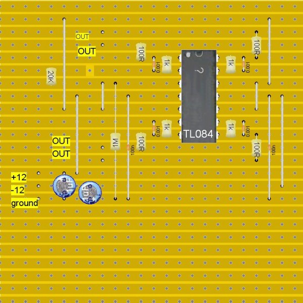

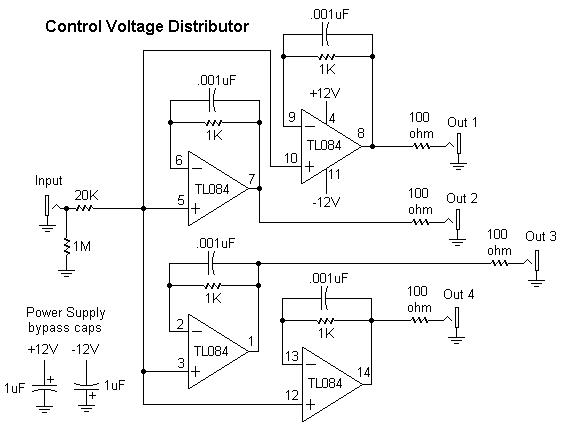

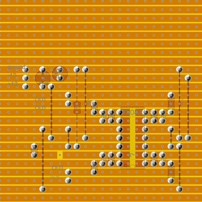

hello,
Who can help to make a stripboard layout?
I ve tryed it now 3 times to do this on a hardwired breadboard but everytime i fail.
I can´t find the error.
can please do it someone on a stripboard ?
I think there are a lot of people who are happy when this is finished.
Thanks.

Here it is i think .. i missed those 1uF decoupling caps on the power strips ..

yes and mislabeled the 0.001 uF for 0.01 heh .. happens
thankls a lot men.
is there a chance that you show me where this cap´s have to be ?
Or can i let them out of this ?
ill try to build it after that i will give feedback , and if it´s ok for you i will share this to some friends.
thanks.

dont forget to cut the strip out in the middle of the IC Smile
do you mean this ? please see the edit

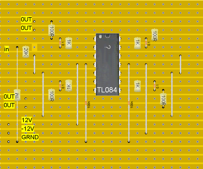

and how do i have to solder the 1uF decoupling caps ?

PostPosted: Wed Aug 31, 2011 11:57 am    Post subject: Reply with quote  Mark this post and the followings unread

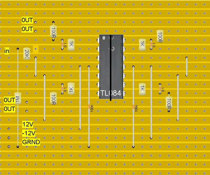

in the layout there are already 100n ceramic capacitors that serve as decoupling caps .. but if you wanna add those 1uF electrolits you can use this .. for orientation .. there is a nice paper on capacitors i know it's on the fonitronic site i think it's called 101 capacitors http://www.modular.fonik.de/files/capacitors_101.pdf may wanna check it out ..

here's a proper layout with the strips cut off in the back ..
cheers
about using it commercially if you think .. that's for MFOS to decide as for the layout you can use it as much as you want

PostPosted: Thu Sep 01, 2011 11:51 am    Post subject: Reply with quote  Mark this post and the followings unread
thanks a lot men, nice work....no no idon´t wan´t to use it in a comercial way. i just wan´t to post it in our german forum at the diy section, there where some guys who also wan´t to have it.

PostPosted: Thu Sep 01, 2011 11:54 am    Post subject: Reply with quote  Mark this post and the followings unread
the input is not there Smile but no prob i know where it must be Smile

PostPosted: Thu Sep 29, 2011 10:43 am    Post subject: Reply with quote  Mark this post and the followings unread
your desighn was super...it works fine thanks alot men... so i saved another 60€ for buffered multiple....

PostPosted: Mon Nov 14, 2011 12:00 am    Post subject: Reply with quote  Mark this post and the followings unread
What's the 20K resistor for? It doesn't seem to connect anywhere
citric acid
Joined: Jun 11, 2011
Posts: 45
Location: germany
PostPosted: Mon Nov 14, 2011 9:05 am    Post subject: Reply with quote  Mark this post and the followings unread
its the input !!!
look at the first drawing Wink

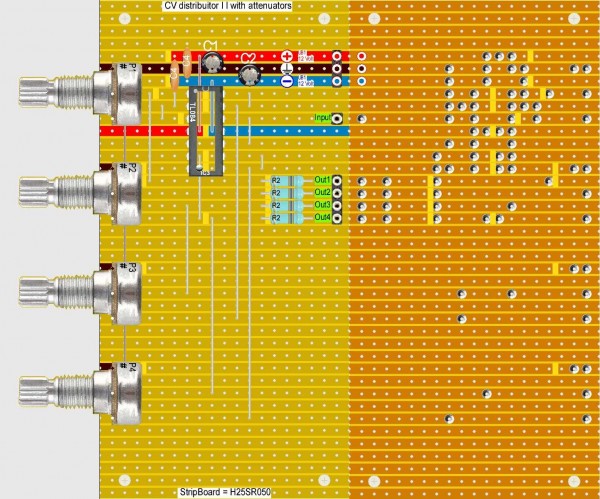

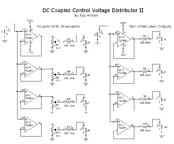

I saw this thread seeking for buffered multiple tips and also found another schematic from Ray Wilson online. See attachment.
Wondered which one I should choose. The one attached or the one seen in this thread. More detailled here:
http://www.musicfromouterspace.com/analogsynth_new/OLDIESBUTGOODIES/VOLTAGEMIXER/voltagedist1.html
Cause the one attached looks more recent, has attenuator pots and has less components, caps etc. ("more simple" in a way, though the other one is not complicated).
Mostly I was wondering if I would have to change any component value for 15V supply use instead of 12V.
Also if this could be used without problem with audio signals as well... Not necessarily mixing AC and DC signals, but using this module for both uses.
 Filesize:  11.79 KB

PostPosted: Sat Dec 22, 2012 7:20 pm    Post subject: Reply with quote  Mark this post and the followings unread
I like the buffers from this project of Ray's:
http://www.musicfromouterspace.com/forums.html?MAINTAB=SYNTHDIY&PROJARG=CVANDGATEDIST/CVANDGATEDIST.html
I built a utility board that includes both the gate/trigger distribution and the CV distribution portions of that, one with and one without the voltage offsets.

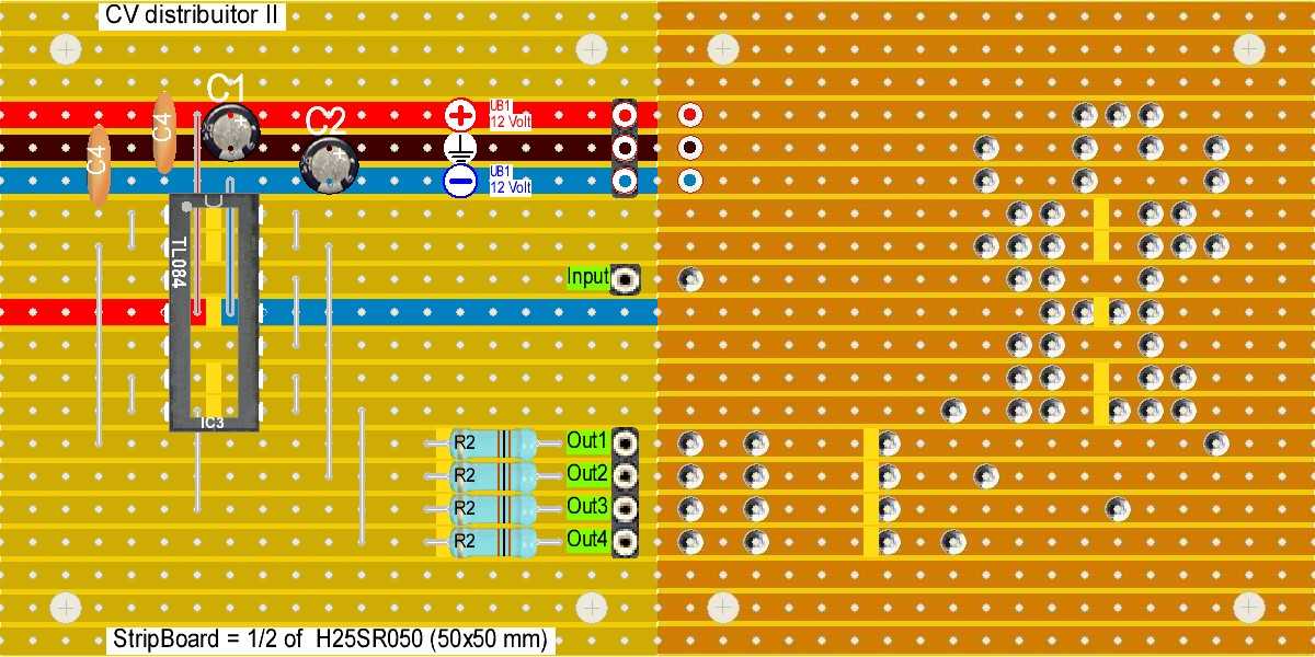

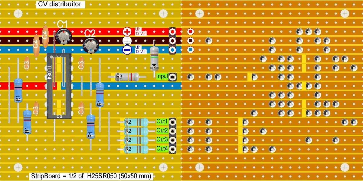

PostPosted: Sun Dec 23, 2012 8:47 am    Post subject: Reply with quote  Mark this post and the followings unread
Stripboards
 Filesize:  190.8 KB
 Viewed:  865 Time(s)
 Filesize:  98.24 KB
 Viewed:  880 Time(s)
 Filesize:  102.74 KB
 Viewed:  799 Time(s)
