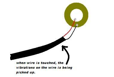

ok everyone, i started building my own drum triggers...essentially it's a contact mic underneth a playable surface. However, i came across a slight potential problem. FOr those who are familiar with building drum triggers, your help would do me a blessing. My problem is :
would this lead to false triggering? I was wondering if someone has a solution for me, asides from buying an actual drum trigger Laughing
how would i insulate the wire? any help would be grand!
thanks

How is your contact mic (piezo element) mounted? Can you just mount the cable somewhere also? If that's limiting, try building a short cable, that has a piezo at one end, and 1/4" female connector at the other. The mount the connector. This allows you to unplug a cable, just like any other drum trigger would allow, and if the 1/4" conn is "mounted" well, any movement of the cable won't be transferred to the piezo... You have to deal with the cable no matter what, since the piezo is designed to detect vibrations...whether they come from your drum surface, or the cable, it doesn't descriminate.

well said jksuperstar. well nothing is really assembled yet...except for what you see in my diagram. i have yet to make pads and cut out a circular metal sheet and piece them all together. I've noticed everyone that builds pads usually use 1/4 inch female connectors...i was just trying to save more money by directly reducing 2 parts. (female and male) cause i'm also making my own cables. but it seems i will go the extra mile and get a few more...its not that expensive anyway. i was also wondering, do professionaly made triggers react the same way, as mine? like instead of the wire being mounted or hidden inside the cage, if it were to dangle off the pad, would the movements of the cable be detected?
i also came across some technical terms that the alesis dm5 or d4 use...terms such as crosstalk. some people say they put triggers on the cage as well to deal with this problem.... i dont quite understand how this works.

as for the cross talk thing, you want to mount your piezo trigger and wires well. I actually recommend attatching the piezo trigger to the flat side of a plastic coffee can lid. then attatch the edge/perimeter of the lid to the underside of the pad. this makes it more sensitive in a good way: hitting in the center of the pad makes a "louder" trigger than other places. you can adjust extra cross-talk sensitivity with a drum module's settings.
i don't really understand what a cage is. A good rack to mount your pads on will prevent crosstalk, otherwise seperate stands. No wires should be dangling or outside of you pad unless they are the 1/4" cable connected to the jack and drum module.

The wires that go to the outside world - drum module - should not be directly attached to the pickup. Separate wires in a sort of strain relief system to accoustically decouple the cables. For example. Have the main connection cables attache to a heavy immobile part of the insturment that is near where the pickup is. Attach it firmly and bring the connection wires to a pair of terminal posts. The connect some very small wires that are perhaps coiled to the pickups. The coils of wire will hopefully dampen any vibations coming to it from the heavy frame. Look at the way voice coils on loudspeakers are connected to binding posts and then to the outside wiring. That's a good model.
