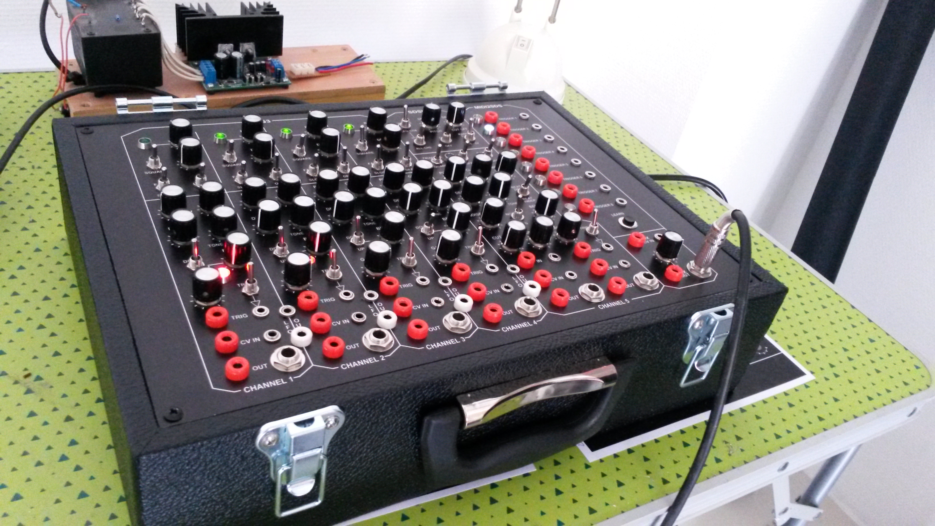

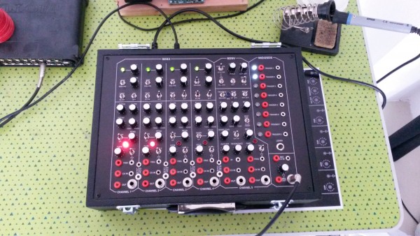

Simmons clone containing 4x sds3 and 1x sds5 channel + some extra's finally ready Cool

Very nice Arnoid Smile
I finished mine aswell, been waiting to do a panel for almost 2 years Smile will post pics this weekend.

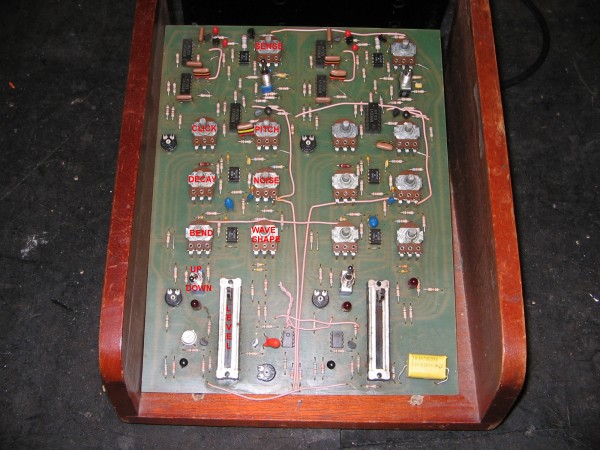

PostPosted: Wed May 08, 2024 7:53 pm    Post subject: SDS-3 images of original circuit board?
Subject description: Anyone have some hi res images of the original circuit board?
I've seen some links in the forum for hi res images, but alas the link does not work, I even tried the wayback machine. Anyone have the images they can share? I would be forever grateful. This unit is so elusive. Thanks all.

Sorry I'm a noob at the forums. Hi res photos of the original SDS-3 circuit board. Alex Ball has kindly given me some detailed images of the underside of the PCB, but as far as the top goes, for component values, I've found one image and it is super blurry.
I am looking for hi res image of the top of the circuit board. A few pages back someone shared that they own an SDS3 and posted a link but the link goes to a dead site.

This photo might have come from this thread. I don't want to look through 14 pages to see if this is a repost. Anyway, it's the best I have. How about posting your trace photo for us geeks?

Wow thank you. I was afraid this sub was dead but you came through!
I've got my pcb more or less working off THeffs work, but I am having similar issues to previous people's attempt with the ladder filter, I get a clean sine wave but my range is tiny on the tone side of potentiometer. And it is very high pitched. I am getting the smallest amount of tone frequency adjustment and the rest of the range only affects noise. I am wondering if my ladder filter is biased wrong. Would love to get this thing fully operational. Am open to any suggestions! Thank you.
