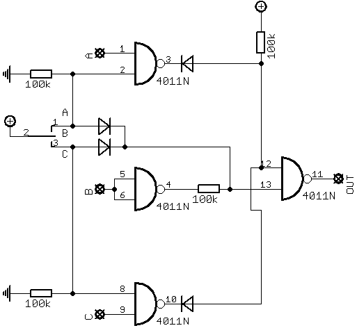

Came up with this today after hours of banging my head against the desk. Probably not the most streamlined solution, but it'll do!
This also only passes digital signals, though I'm sure you could tweak it to control an analog switch.

Hi commathe, that's a great idea to make use of those ON-OFF-ON switches. Didn't think of using them for this so far.
How about this solution? It needs less parts, handles two signals, and does analog too.

I've never really used the 4052, so I didn't think of that. Your's is definitely a lot more graceful (and useful)! Embarassed

obviously it did not help Smile your circuit is a real overkill to select between 3 signals A,B,C : connect A to to the left pos. of your switch, C to the right, and B via a 10k to the middle which is also the output of your 3-way-selector.(Use a non inverting gate as buffer if you don't want the 10k series R when selecting B)
I came up with this after seconds not hurting myself Wink

Just get one of the on-on-on dp3t switches..... No active electronics required.

A weeks worth of searching and not being able to find any was what inspired this. I could only get the 1P2T type that just connect both lugs in the middle position.
