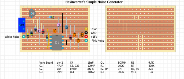

Hi kropo,
That's great. I think they are quite cool, even if toms aren't that highly regarded...
For the decoupling caps: ideally these should be mounted from V+ or V- to ground respectively, but you can easily get away with bypassing V+ to V- with anything between 10nF to 100nF ceramic capacitors. Just solder them on the reverse side of the terminals of the ICs (diagonally). (Keep in mind it's mirrored on the reverse side). So in this case:
TL072:
pin 4 (V-) -- cap (-||-) -- pin 8 (V+)
TL071:
pin 4 (V-) -- cap (-||-) -- pin 7 (V+)
But you can probably simply leave them out as well.
Noise IN shall be connected to Pink Noise. I added the Pink Noise Out for use with a switched jack (for use with an external noise source).
As for operation on +/-12V... cannot really say. The tuning is probably a bit off. And you would probably have to increase R252 (mid tom) to ~5k6. Just try it.
Cheers, helix

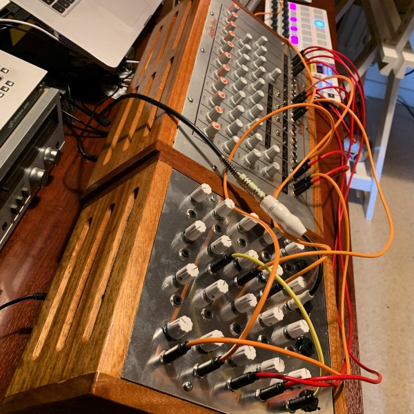

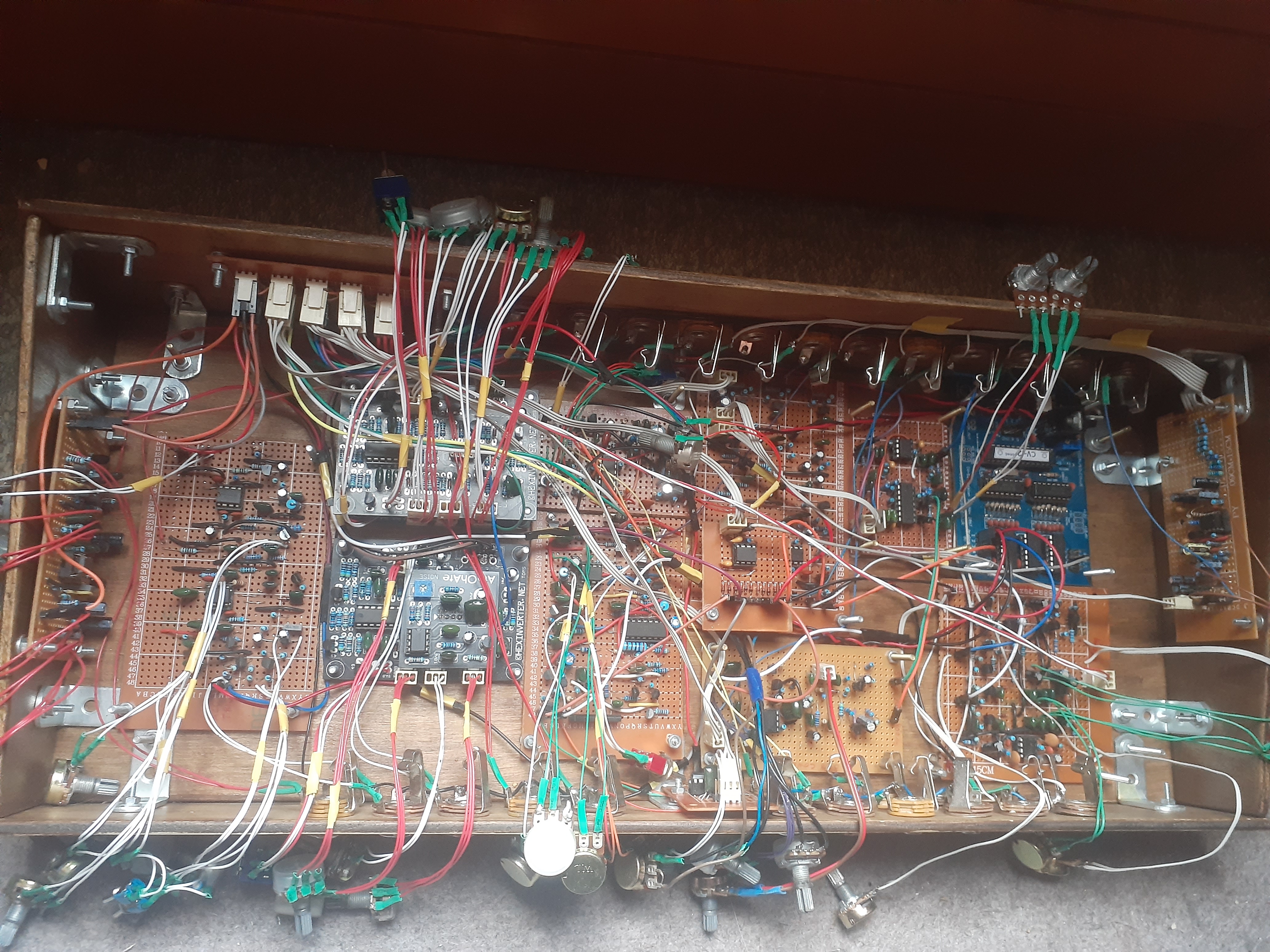

PostPosted: Sun May 05, 2019 4:59 am    Post subject: Reply with quote  Mark this post and the followings unread
Just wanted to say massive thank you to everyone in this thread. Today I finally housed my clone in a safe wooden case. The electronics have been sat waiting for this day for over a year. But I finally plugged it in and everything is working at it should (bar a little hum on the clap as the jumpers seem to be antennas.

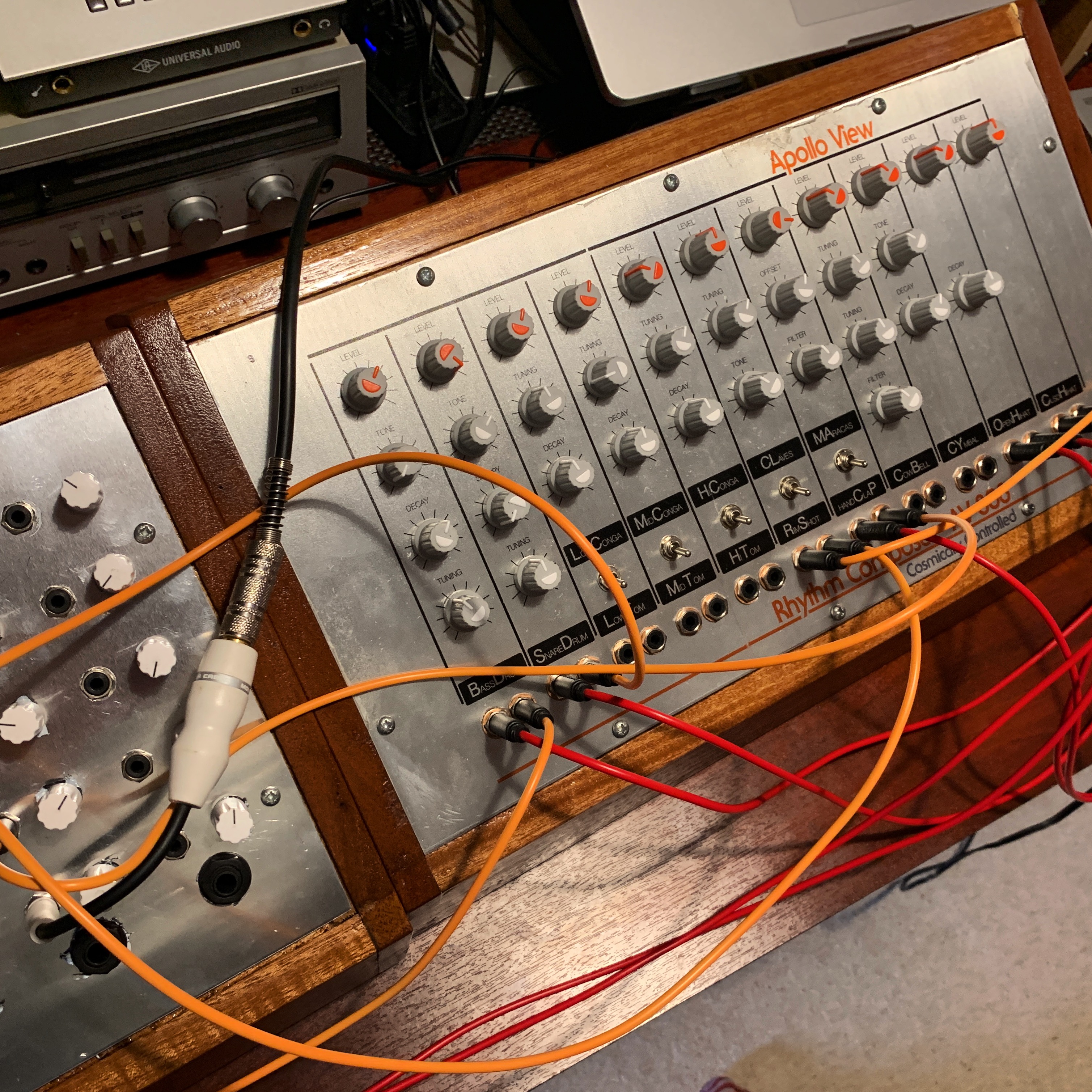

PostPosted: Wed May 29, 2019 12:38 pm    Post subject: Reply with quote  Mark this post and the followings unread
Wow, that's a nice piece of work Apollo. Great looking panel, though it looks a bit more like a 909! Razz
I just got my snare working and am moving on to the hihats and clap/maracas next. I probably won't do all the voices but I might mount those 4 behind a 20HP panel or something.

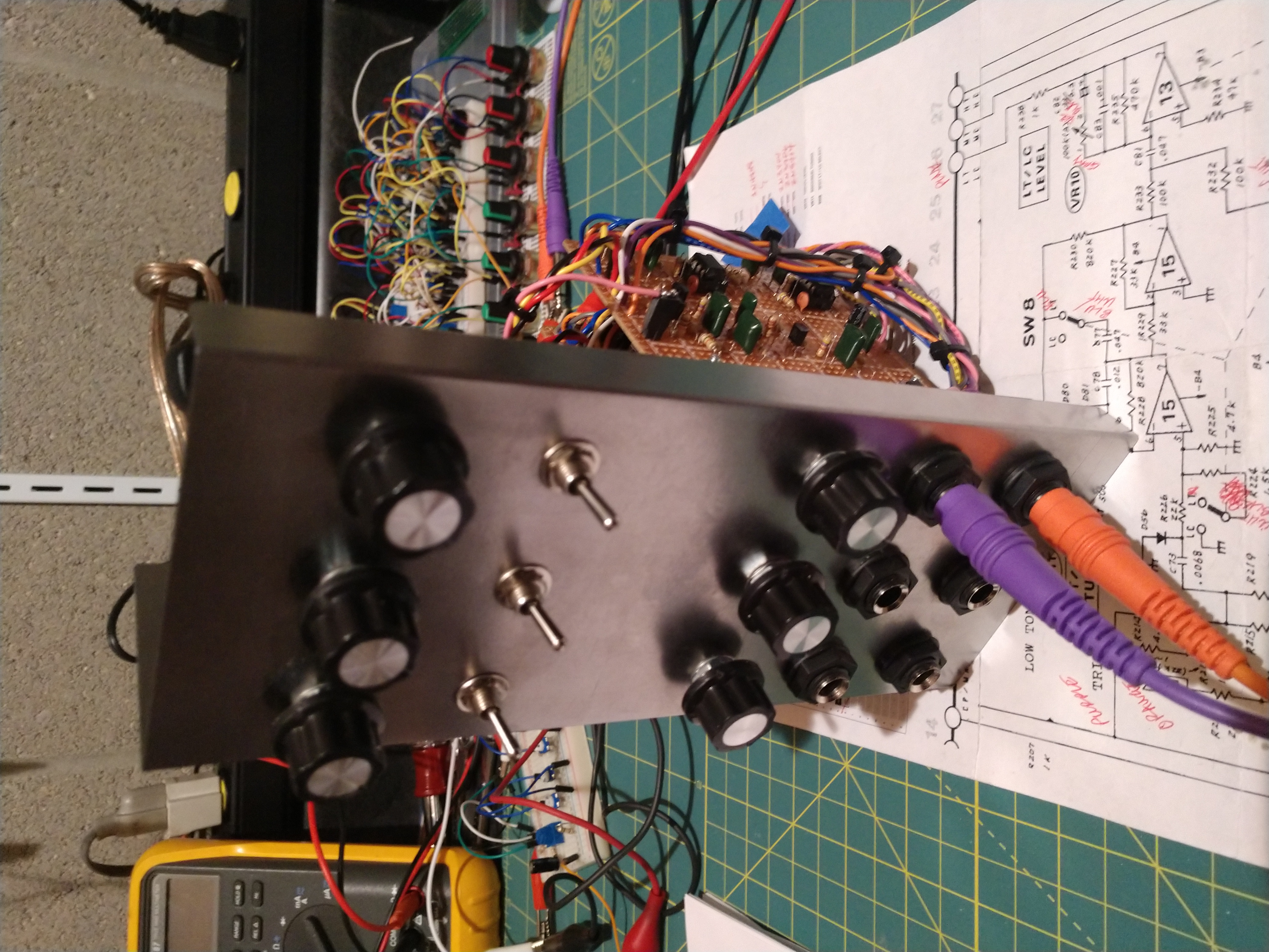

PostPosted: Thu Feb 13, 2020 1:09 pm    Post subject: Reply with quote  Mark this post and the followings unread

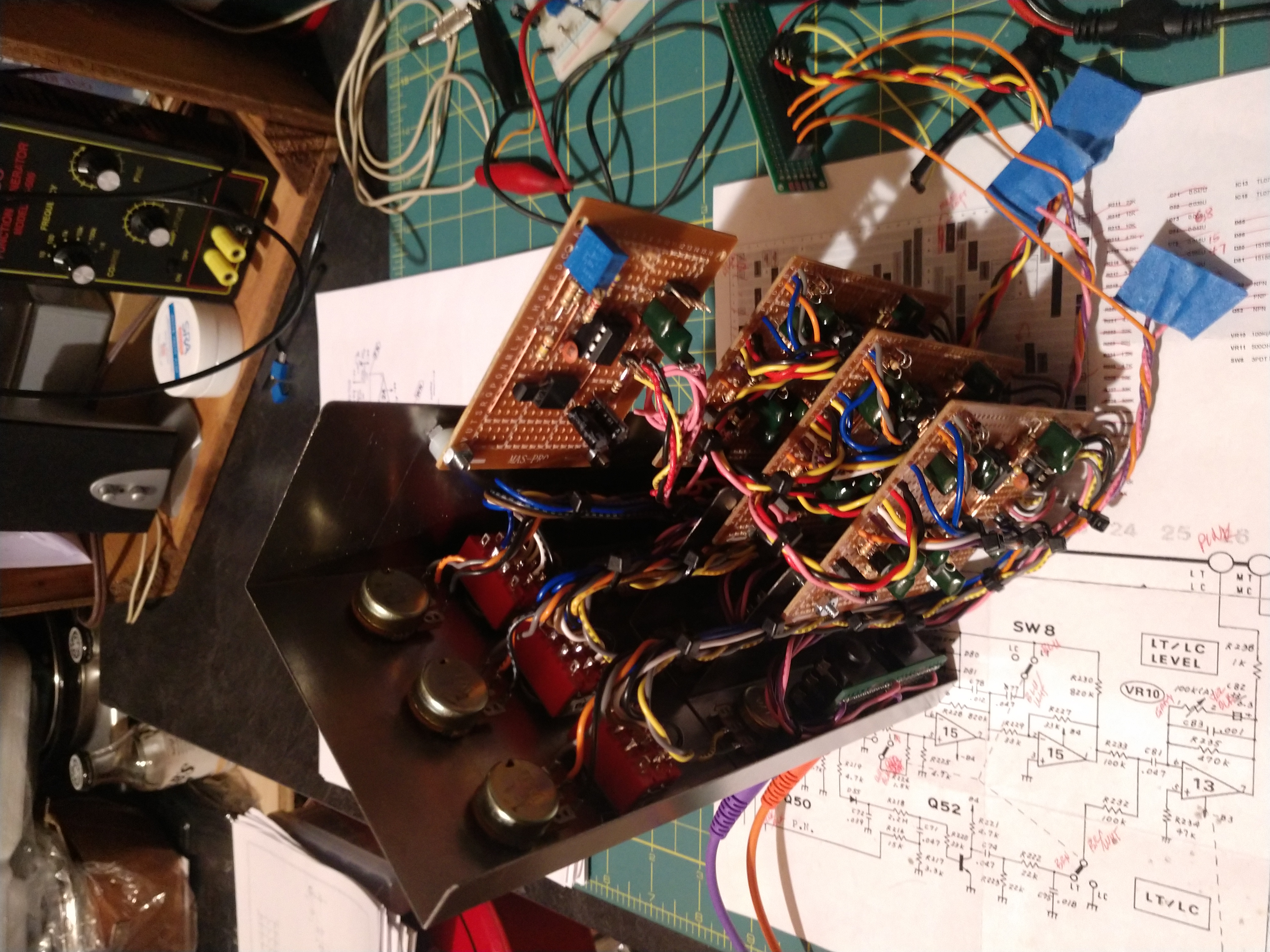

Not sure what my noob posting privs are, so here's a test money shot of the 3 T/C and Noise Gen

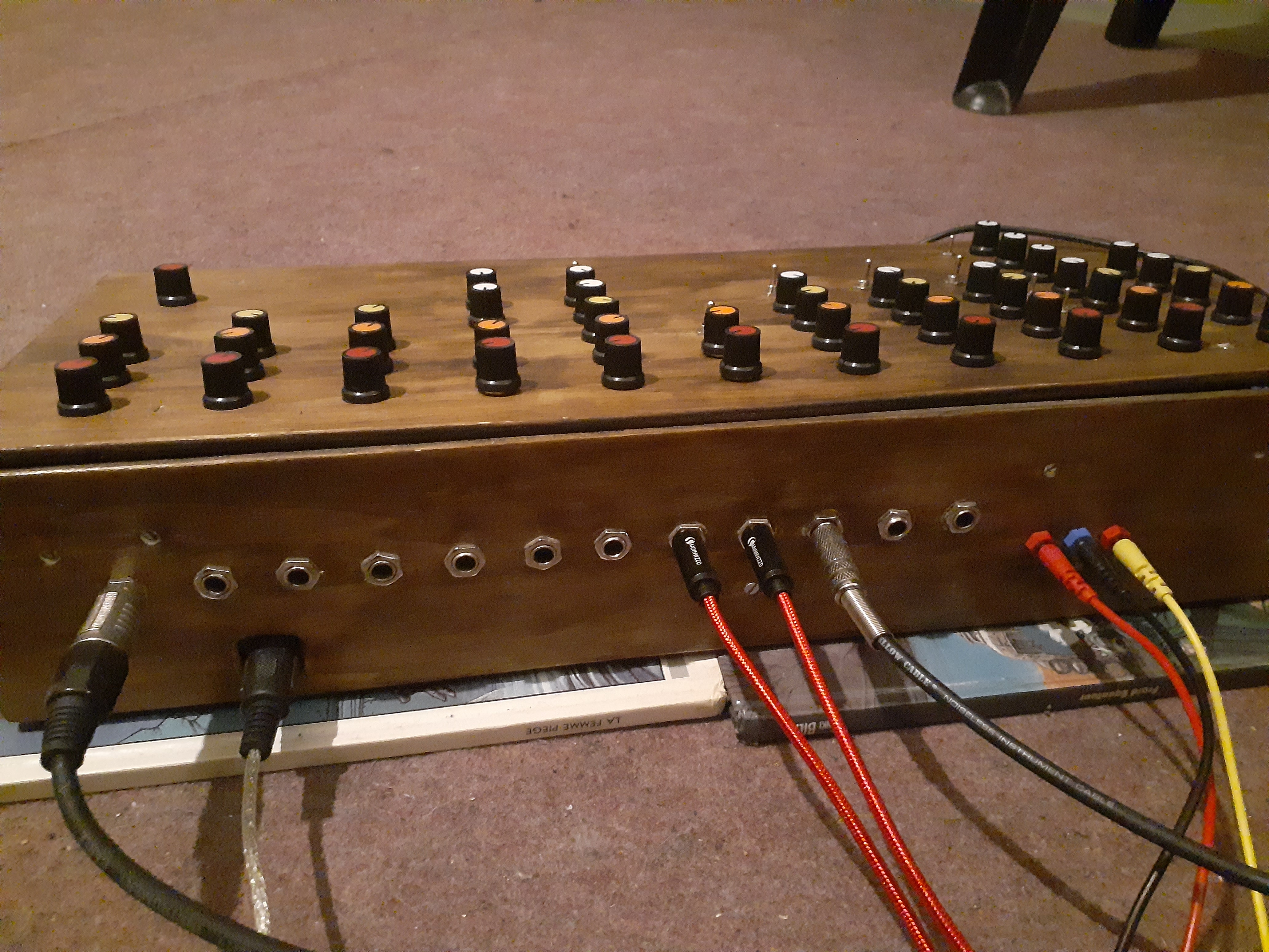

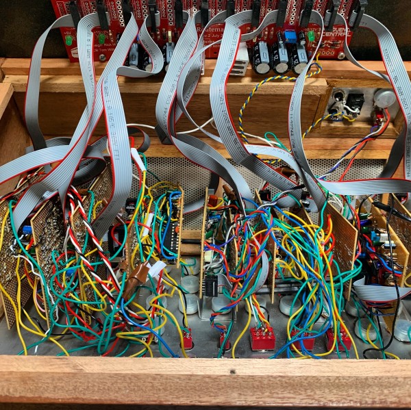

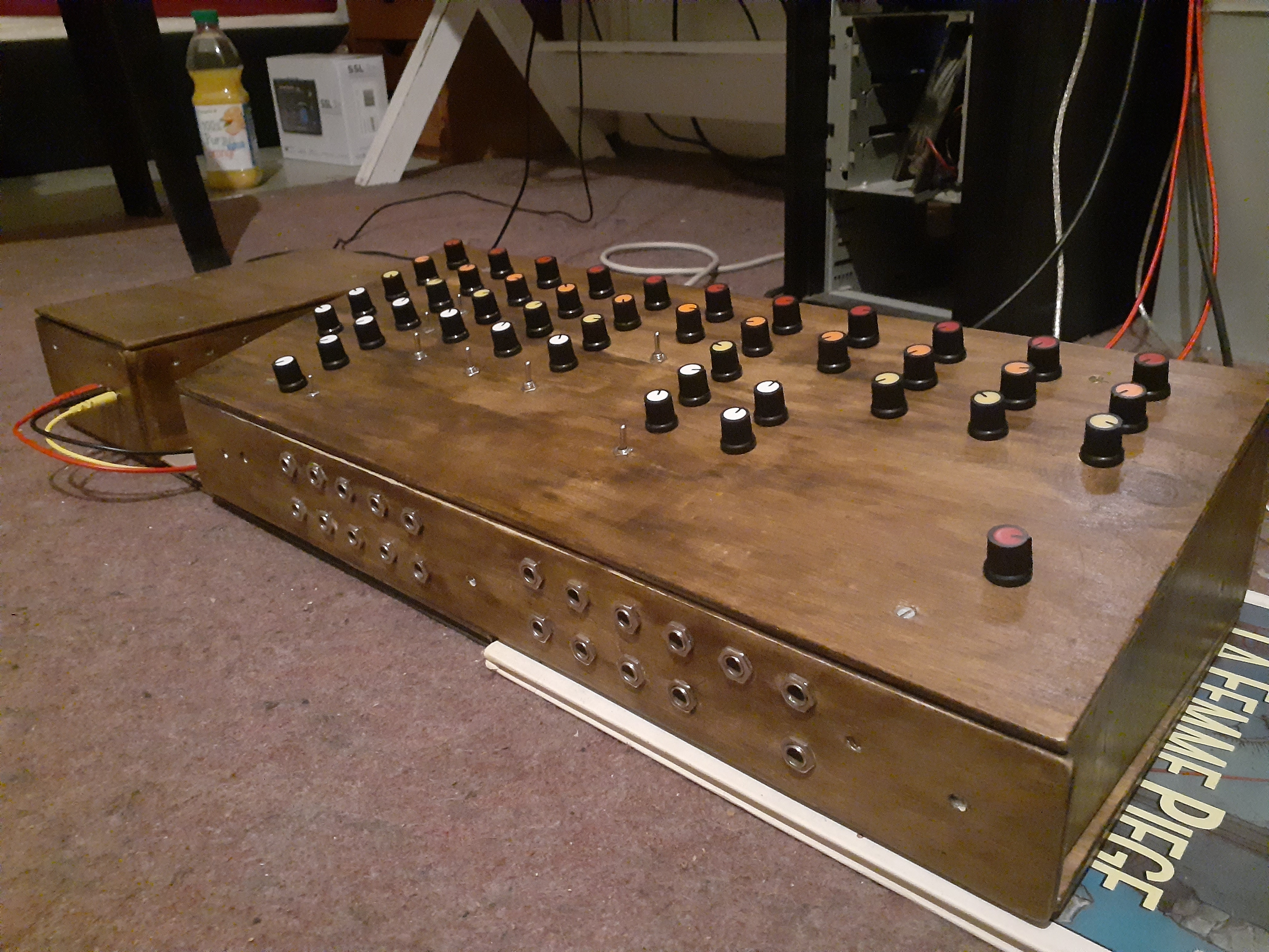

Hi everyone, been a while !
Oh f Peppy you're right... C144 is mounted on the wrong way... It doesn't seem to be very dramatic at least on my circuit, which sounds great to me, and now everything is in a box i can't change it anymore. I edited my post, thanks for the report.
Some of you noticed a noise leak on the clap/maracas, if it's not due to the C144 mounted the wrong side on my layout, maybe try to adjust the amount of noise source. On my 808 noise source i replaced the trimmer by a pot so i can manually adjust the amount of noise for the clap, it's a nice sounding feature, but you don't want that pot all the way up or you'll get some noise leak.
Let me present you the c8r0n8 ! After almost 5 years, i finally finished it during the quarantine, sounds sick !
Toms are the only non-stripboarded part, i used hexinverter's AteOhAte, i see someone designed a stripboard version for it in this thread, too bad i didn't see it earlier.
Here's the list of mods i used :
- BD: tune, decay
- Snare: osc pitch 1&2, decay, noise amount, noise filter
- HexInverter's toms are already modded (noise input/decay)
- Rimshot/claves: filter
- Clap/maracas: filter, decay, noise input
- Sound source: Osc 1 & 2 pitch (i basically just replaced the trimmers by pots on -minus- layout, mostly for different cowbell tones, also affects HH/Cymbal as they share the same sound source)
- Cowbell: filter
- CH/OH: filter and decay for both
- Cymbal: filter, decay
They can be found on this thread/the other 808 snare thread, and this forum: http://www.e-licktronic.com/forum/viewtopic.php?f=18&t=143&sid=1aae44d7fde1048f373b3c45c92d4143
I'm using midimuso CV-12, but i kept the individual trigger/acc inputs. I built an external PSU for it, but ofc can be used for other purposes. I may post a video with a proper sound recording
Thanks everyone for making this possible !

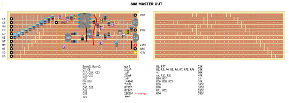

PostPosted: Wed Mar 24, 2021 7:37 pm    Post subject: Reply with quote  Mark this post and the followings unread
And here's the master output, i don't know if it's been posted before
