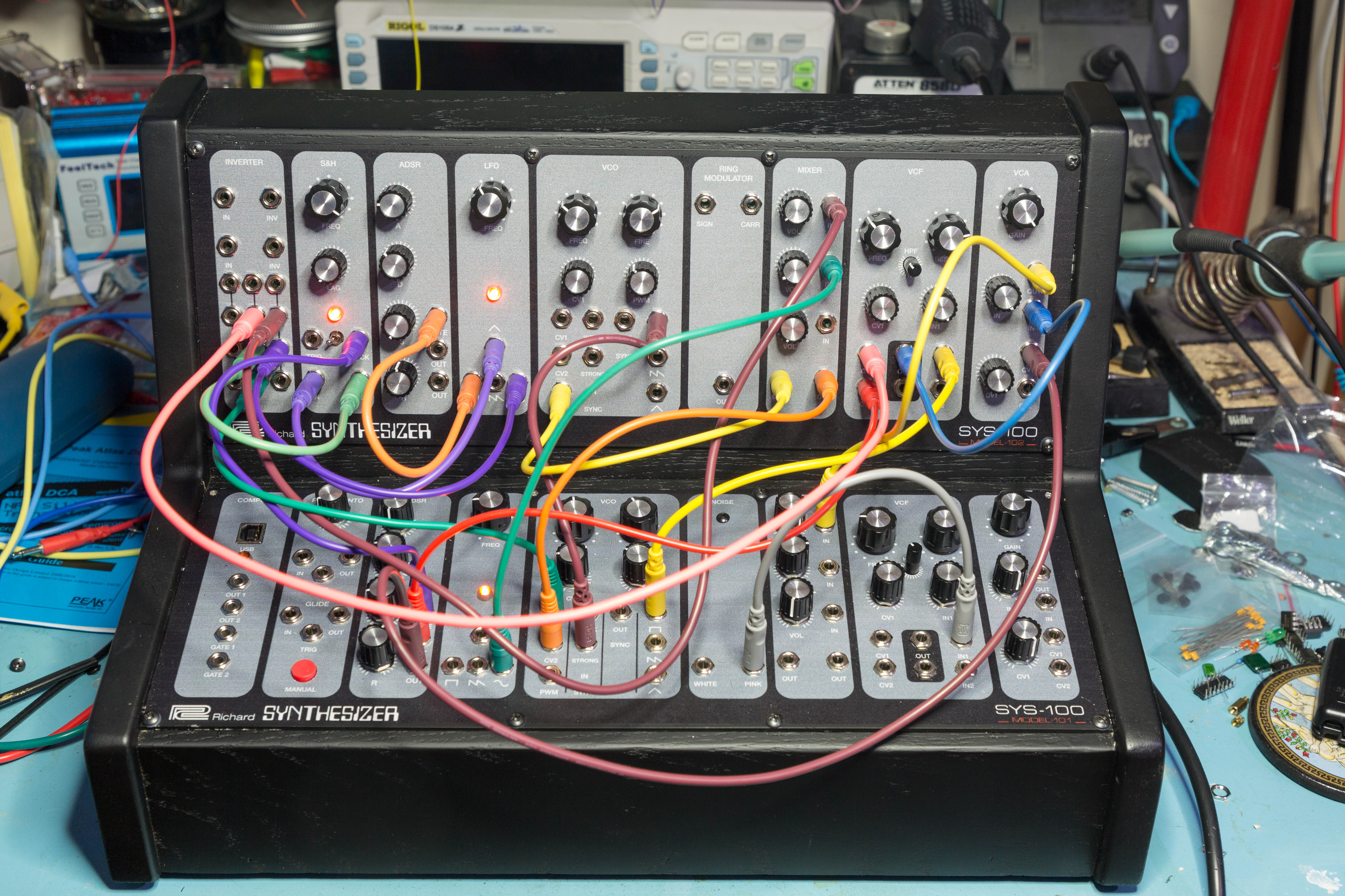

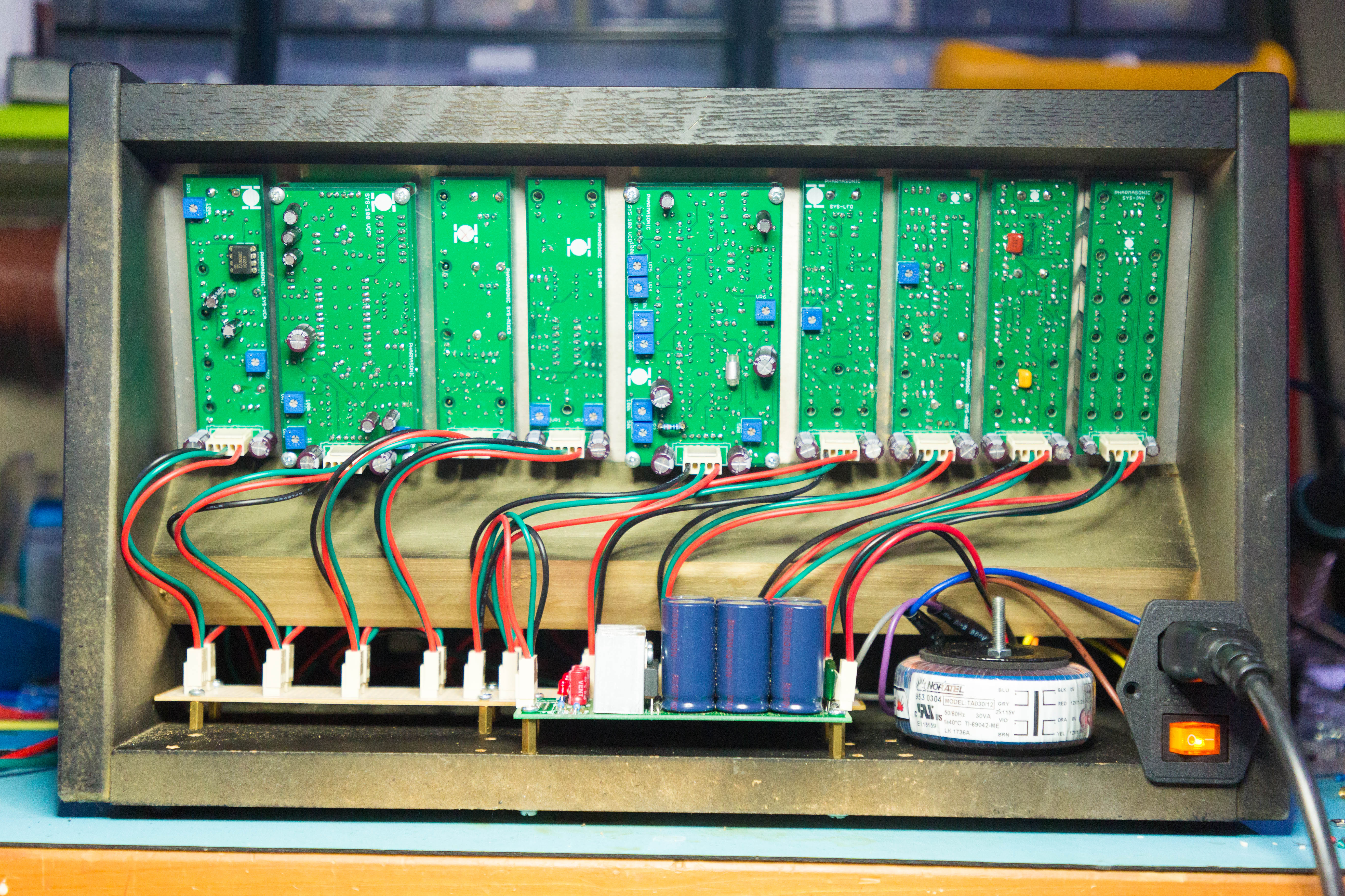

System 100 clone, built with Pharmasonic PCBs...

that's a lovely looking synth Very Happy
Wow, that's a neat little instrument!
The leftmost bottom panel (labelled "computer") is a non-standard (USB-)MIDI unit, isn't it. Where did you get that from?
Cheers and a lot of fun!

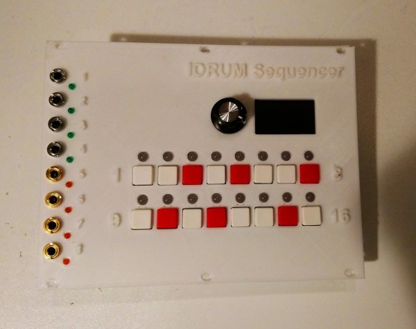

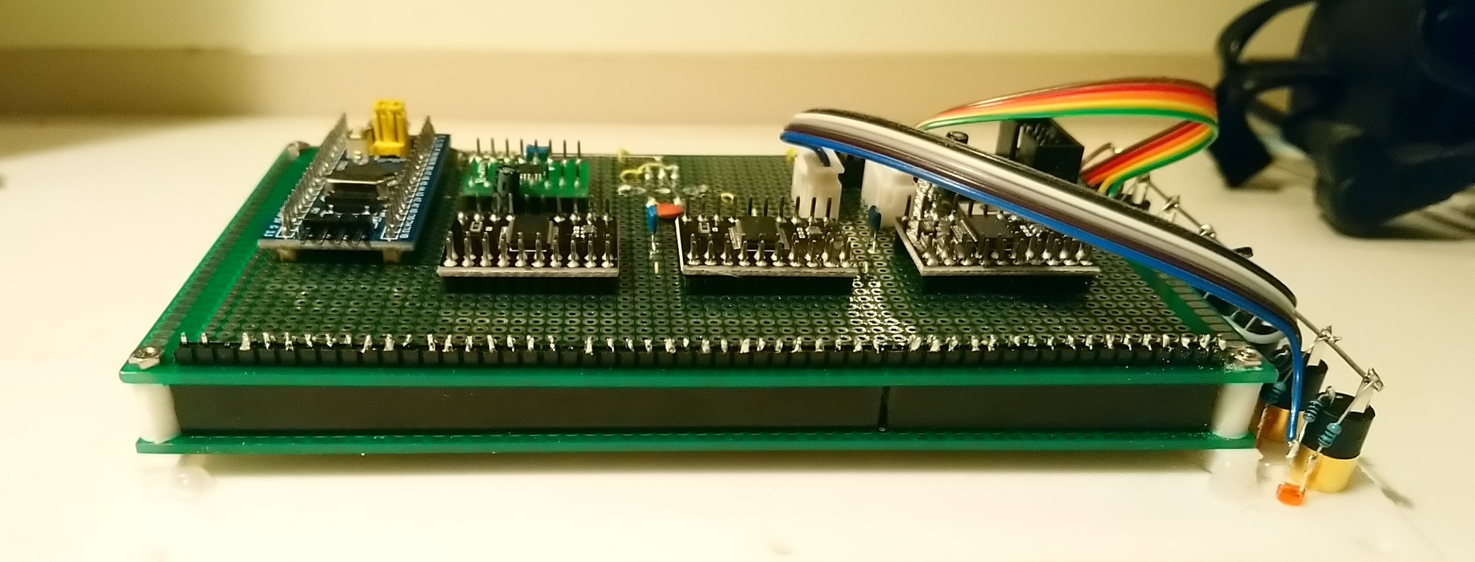

Drum sequencer, first 4 channels pure digital, the next 4 are outputs of a quad 16bit DAC.
Module is powered by a bluepill STM32F103.

I have a bluepill to play around with here, what do you use for level shifting ? (3.3.V <> 5V)
Posts: 1320
PostPosted: Mon Mar 30, 2020 2:27 pm    Post subject: Reply with quote  Mark this post and the followings unread
For the digital outputs I just use a 74LS08, works perfectly.
For the last 4 channels I use a quad DAC which accepts 3.3 volt digital signal, and puts out 0 to 5 volt. The rest of the components like the display etc. are 3.3 volt compatible.
At the moment I’m working on the software, when that works I will open a thread with schematics and some explanation how things work.
For this project I use the Arduino IDE.
I just realise that I just have outputs and no inputs... guess I have to make a secondary panel with trigger in and outputs...😱

oh interesting, I just checked the datasheet for the 74LS08 and it says the mininum high voltage level is 2V. yeah that'll work, cool
Did you get the arduino IDE working with USB ? I did manage to upload a sketch through FTDI but haven't been able to load an arduino bootloader on it.
and yeah, I did notice the lack of inputs, and the fancy goldplated connectors Shocked

One more question before I derail this thread too much; why the red buttons in those places, was that purely an aesthetic choice ?

I plan to have midi implemented as well, and the buttons can serve as a keyboard input (could have used black caps instead of the red ones Wink )
And the “fancy” gold plated connectors are the same price as the metal ones and are there to discriminate between triggers and analog outputs.
