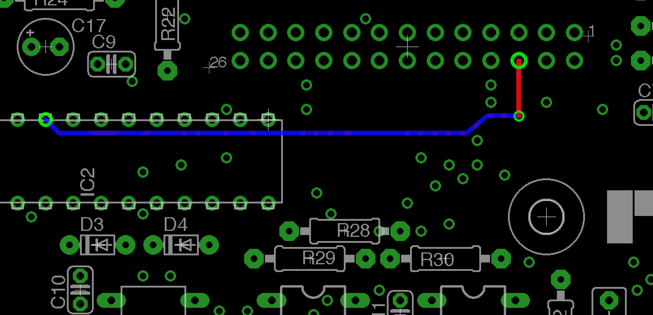

The change of resistance reading R19, when the Main PCB is connected appears
to be a problem.
The resistance of this should not change significantly, and certainly not as low as 127R.
Please check the tracks on the Main PCB for the connection of this voltage [ see atatched picture ]
I'm measuring the same voltages as across R19 on the via and the pin of IC2. Sadly it appears the resistance across that pin and gnd without panel is 126R3; seems like I managed to bugger that one as well. Sad

nativeVS wrote:
Hello
Can you remove [ very carefully ] the PIC chip, and measure again the resistance from the previous highlighted PIN [ on the Pin header of the Main PCB ] to GND.
ryk

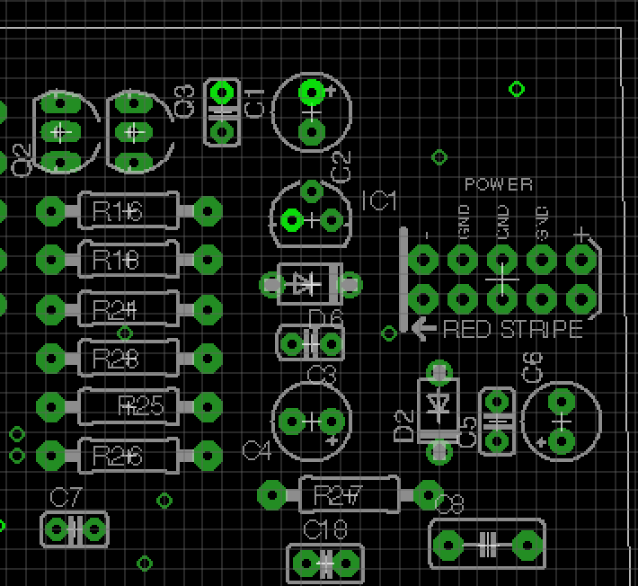

Hi, finished my M-185 build.
There is small weirdness however. I have only doepfer DIY kit power (1200ma +12, 1200ma -12v) if I remove all other modules and leave only M-185 it starts probably once in three restarts. When I connect it with other modules M-185 never boots up (other modules work fine) , unless I do ON -> OFF -> then very rapid ON again. Maybe because there is charge in capacitors and those together with fast power off -> on is enough to start module. When it starts however, everything works fine.
Does M-185 take lot's of power during startup and my Doepfer cannot supply it or is there something I screwed when I build module.. or maybe my Doepfer power has problems, unstable power at startup or something ?
ryktnk
Joined: Apr 24, 2008
Posts: 285
Hello
There should be plenty of power from your Doepfer, the M185 only uses
approx 85-110mA [ depending on how many LEDs are lit ]
Can you use a multimeter to check how much current [ + and - ] the M185 is drawing when connected to your Doepfer power supply.
You can do this by measuring the current across the 1N5819 diodes [ D2,D6 ]
when the module is powered up.
If you are unsure how to do this, please ask first, to avoid any power supply accidents . . . . Shocked
ryk

I did small protoboard testrig to "break" powercable and measure current.
When module succesfully powers up:
80-82mA +12v
12mA -12v
when it does not power up:
totally random 53mA - 180mA from +12v depending on power on cycle, it does not jump around. When I power up, it may stay on that 53mA or another power on cycle it may stay 70mA. Just once it was 180mA, usually around 53mA or 70mA.
-12v stays on 12mA like on succesfull power up.
80-82mA +12v
12mA -12v
Sounds pretty strange.
When the module powers successfully, are all the functions working ok ?
Can you repeat the test without the Panel PCB connected.
Please check carefully all the soldering around IC1 and IC100, these are the power
regulators.
Also the orientation of capacitors C1,C4,C6
Spelunker
Joined: Jun 19, 2020
Posts: 7
Location: Finland
PostPosted: Fri Jun 19, 2020 8:51 am    Post subject: Reply with quote  Mark this post and the followings unread
regulators.
Yep, when module powers up everything works. I calibrated both cv channels, no problems there, every switch works etc..
Without Panel PCB +12v current draw is sometimes 70mA and sometimes it is only 55mA
Orientation of all electrolytics is ok and there does not seem to be any obvious problems with solder.

Can you measure the voltage regulators when you switch on.
IC1 & IC100
See pic for highlighted pins.
IC1 & IC100
Those pins show 4,96v. When working or when not working...
IC1 and IC100.
ryktnk
Posts: 285
Location: london
PostPosted: Sat Jun 27, 2020 4:11 am    Post subject: Reply with quote  Mark this post and the followings unread
Spelunker wrote:
IC1 & IC100
IC1 and IC100.
Hello
Thanks, voltages sound ok.
