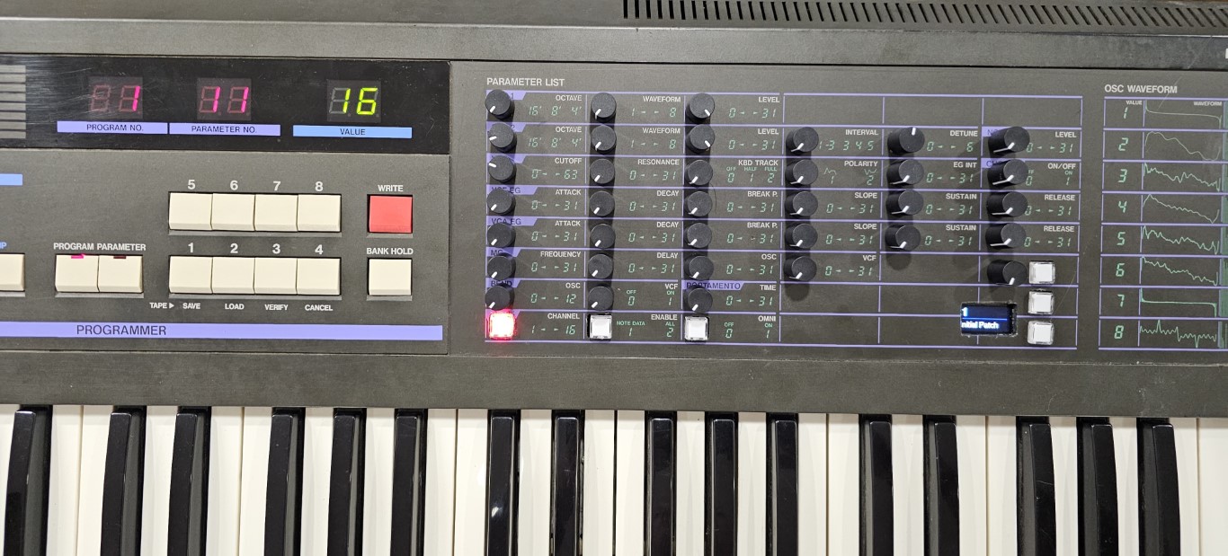

PostPosted: Sat Sep 23, 2023 11:31 am    Post subject: Reply with quote  Mark this post and the followings unread
Along similar lines, Ive just built my own editor into the DW6000, I need to add some features, but it basically does everything.
