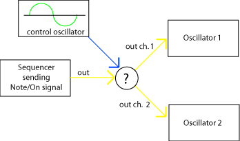

This might have an obvious answer to some, but none of the logic/switch modules (at least the combinations I've tried) seem to do this. Please use the diagram below as reference. I am looking for some kind of module/combination (represented by the "?") that has one input for a note/gate/on event, 2+ possible outputs for routing that event, and another input for a control signal that determines which output the note/gate/on event will route through.
My idea is that an LFO/osc could be used as a control source for the "mystery router"...if the sine wave in the control LFO is 0<+64 units, the note/gate/ on event will go out myster router ch. 1, hence triggering Oscillator 1 in the diagram. If the sine wave of the control LFO is -64>0, the note/gate on event will go out myster router ch. 2, hence triggering Oscillator 2.
Any suggestions? I would be surprised if there is not a simple way to do this I have overlooked/don't understand entirely. Sorry for the verbose description, I hope its more helpful than confusing.

Just another comment, but I essentially want an LFO to control the "radio buttons" (i.e. what output channel) on a switch module instead of pressing the buttons manually.

Can't you use a pan module for that?

The Mux 1-8 should do that; you'd need to add some level shifting and scaling ahead of the control input to ensure that only the first two outputs are used.

Probably lots of ways to do this but I would go for a combination of the level compare and a couple of value switches. The knob on the level compare lets you set the swap point (if you wanted to bias the output one way or the other). To switch the gate and note values you need a pair of switches.
More than two outputs would require a different solution.
Or you could create a chained network with multiple instances of this technique.

Thank you for the input everyone. The pan module would be the simple solution that I figured was evading me, but these other alternatives are definetly worth toying with (I will need more than 2 outputs in most situations.) Thanks again, I'll post some patches involving this when I finish.
