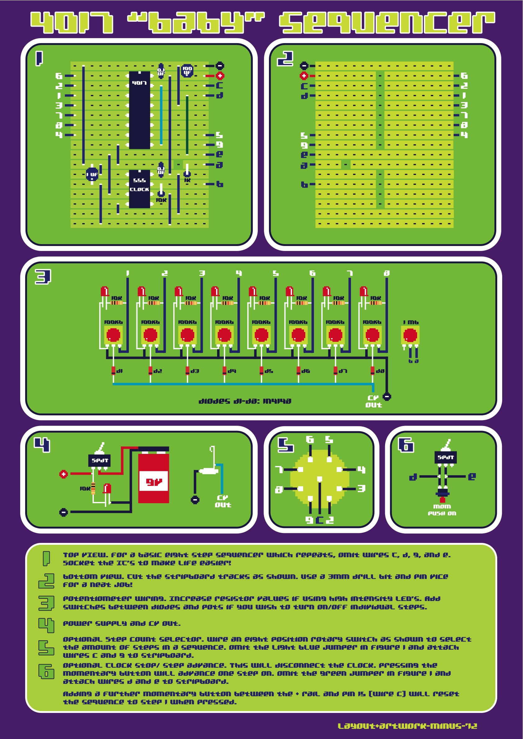

Sequencers based upon the 4017 IC seem to be a right of passage many DIYers go through. I was recently asked about a stripboard layout for the infamous Baby Sequencer. Here are some diagrams which may be useful as a starting point...
I have tested this on breadboard and it seems to be working OK. Let me know if you find any mistakes and I'll correct the layout. Feel free to add to the circuit and modify it to your own needs.

Hmm working on this right now, and so far i havent gotten it to work properly, only the first light seems to be showing a constant red shine, and no pulsing going on, have checked everyting seems to be something wrong.
-minus-
Joined: Oct 26, 2008
Posts: 787
PostPosted: Mon Apr 09, 2012 4:56 pm    Post subject: Reply with quote  Mark this post and the followings unread
Hmmm... Confused
I guess PIN 3 of the 555 clock is going to PIN 14 of the 4017? Also, make sure PIN 13 of the 4017 is tied to the GROUND (-).

Potentiometers generally come in two flavours
linear (B) and logarithmic (A) they both have the same resistance but have different ways of getting there, a linear pot will work like
1 2 3 4 5 6 7 8 9 10
and a logarithmic pot would work like
0.1 0.2 0.5 0.9 1.5 2.5 3.8 5.5 7.5 10 (or probably even steeper, this is NOT a mathematically correct example)
the lines on the diagram are wires (jumpers) they make the "column" paths on the stripboard.
its unlikely that you will annoy people here Smile so visit the chat room too, some helpful people in there Smile

I hadn't noticed the activity here! With the switches, just any on/off switch will be fine. Here's the switch abbreviations for future reference:
SP = Single Pole (One set of contacts only)
SPST = Single Pole Single Throw (or single changeover)
SPDT = Single Pole Double Throw
DPDT = Double Pole Double Throw
DP3T = Double Pole Triple Throw
4PDT = Four Pole Double Throw
*"Pole" = "Terminal" *"Throw" = "Position"
You could do an image search of each type to see what they look like in real life.
The GREEN jumper wire (figure 1) between points 'e' and 'd' is connecting the clock pulses coming out of the 555 timer at pin 3, to the clock input pin of the 4017 which is pin 14. If you want to stop and start the clock you need to leave OUT the GREEN jumper. Instead you add two wires at points 'd' and 'e' on the stripboard (figure 1), and connect to the switch or switches as shown in figure 6.
The BLUE jumper wire (figure 1) is there to reset the sequence count back to the first step after it runs through the 8 steps. If you look at the 4017 data sheet you can see how the pins are labelled. With the BLUE jumper in place it will count 1,2,3,4,5,6,7,8,1,2,3,4,5,6,7,8,1,2,3,4,5,6,7,8, etc.
BUT, that may not be what you what you want all the time. If you wanted just a 4 STEP pattern, the 5th output of the sequence would need to be tied to the 4017 reset pin (pin 15). With a rotary switch it is possible to select the amount of steps from 1 - 8 in your sequence.
As it stands with the BLUE and Green jumpers installed, you would have a basic 8 step sequencer. You can add features to this and modify it to your own needs. You could add switches to all of the pot outputs to turn steps ON/OFF. Turning down the pot at each step will do this anyway but you may want to turn the steps off without messing with your pot settings.
You can wire up a switched jack along the line from pin 3 of the 555 and pin 14 of the 4017 to use an external clock. Putting a diode in there from pin 3 before the jack may be a good idea.
Pots can be confusing. If you used logarithmic posts (type A) at the 8 steps, it would work but you'll find the range is all bunched up in the last 3rd of the pot rotation.
The BABY sequencer is a very basic one to build. It is a good introduction though to how sequencers work. And you can add to it as you learn more... a second row of pots perhaps, or pulse outputs. or triggers to fire drum modules.
Hope this helps!

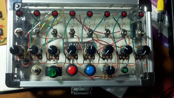

I've built this sequencer as practice before I start on a 16-step design from MFOS. I wanted to be sure that the CV in on my Moog Rogue was functioning properly before undertaking a larger, more costly project.
So, the sequencer is built, the LEDs light in sequence and respond to adjustments on the timer. When I connect it to the Moog Rogue, the sequencer functions as normal as long as the next step in the sequence is a higher voltage, and on reset the sequence repeats with a higher baseline voltage. If the next step(s) in the sequence are a lower voltage, then the pitch will slowly glide down, but not nearly as fast or far as it should. Basically the Moog is acting like it's storing a charge from each step, thus increasing it's ground/reference voltage, and not resetting at each subsequent step.
I haven't had a chance to look at the sequencer's output on an oscilloscope yet, but my analog voltmeter responds as expected to the sequencer. Also, I connected a variable power supply to the Moog's CV in to verify that quick changes to the CV produce the expected pitch changes, and they do whether increasing or decreasing the voltage.
I'm puzzled by these observations. The sequencer and Moog seem to be functioning properly when used separately, but used together they do not.
Does anyone have any ideas of what may be going on? Or to those of you who have built this design, is this just a design flaw?
PostPosted: Sat Dec 29, 2012 7:22 pm    Post subject: Reply with quote  Mark this post and the followings unread
Definitely sounds like you have some noticeable capacitance somewhere in there.

I've built this stripboard, but I want to put it into an enclosure that I haven't tried before so I've been working on other projects before completing this one.
enigmatrix
Joined: Dec 29, 2012
Posts: 3
Location: Asheville, NC
PostPosted: Sun Dec 30, 2012 8:56 am    Post subject: Reply with quote  Mark this post and the followings unread
The only other CV device I have is an analog voltmeter, which exhibits the expected behavior (sequencer seems to work as intended.)
I've used a variable power supply with the Moog. The result was snappy pitch response, nothing erratic or unexpected there.

Here's my crack at the enclosure for this stripboard, still in progress...
(ha ha notice the crack in the top if you look closely....)
I have added switches for gate, all the various optional pieces, and a quad AND chip to take gate and clock and generate a trigger of sorts. Going to take a clock out too just for completeness sake (since 4 jacks fit reasonably well along the side)

PostPosted: Sat Jan 05, 2013 12:04 am    Post subject: Reply with quote  Mark this post and the followings unread
Done wiring, but not working entirely. Will post video when it's uploaded/processed, but I'm having some issues with it. I've tried some mods to help, but they haven't really. Going to brain dump in case someone sees something that helps resolve the remaining problems....
So mods:
0) Did all the optional mods minus listed, pluse the switches for gate out as mentioned before
1) added clock/gate AND (with a 4081) to get a trigger out
2) ran a 47k resistor from 4017 reset to ground so it wasn't floating
3) ran a 10nF cap from 555 pin 5 to ground, per usual 555 circuits
4) Adjusted the component values; set the timing cap to 2.2uF and "R2" to 5k instead of 10k, so I could get things a little slower to my liking
5) ran the clock pulse through a 2N3904 inverter--this helps with #1 and also let's me send a clock out as well (so I could conceivably make this a clock source for some other simple project). Basically instead of being high all the time with downward pulses, it's the other way round. The 4017 doesn't care of course, but other things do.
Originally I just bolted the stripboard right up against the clear plastic (polycarbonate??) in this pencil box, but that seemed to make things REALLY unreliable, so I have used nuts as standoffs to get it just off the plastic. I don't have bolts long enough to get higher up, nor clearance above the board.
Even being more reliable, I still double/triple hit some notes and eventually get hung up on one. Most often this seems to be happening on step 5, but it is not always. Physically banging the box almost always resolves it, now that I have the PCB up off the plastic.
I don't think I have any lose bits of junk running around, and if I did I'd expect the banging to change the symptom entirely instead of ending up hanging in the same place (as I say, most of the time anyway).
Anyone have any ideas? I'm going to go over it more carefully tomorrow.

PostPosted: Sat Jan 05, 2013 10:15 am    Post subject: Reply with quote  Mark this post and the followings unread
I'm impressed you built this, Elmegil. Thanks for the research once again. I'm yet to construct one of my own. I'm not sure how I missed the cap from pin 5 of the 555 to GROUND. I do see this in several 555 schematics now you have mentioned it. Any idea why this cap is needed?
I am unsure why your sequencer is 'sticking' on steps. I built a trigger sequencer a couple of years ago and didn't experience this problem. I seem to be caught up in real life BS at the moment so I can't see this or much other electronic building happening until the weather clears.
I'll get around to posting another diagram based on whatever is uncovered here, with the various mods included... hopefully this month.
EDIT: And the RESET is floating too! Sorry... Embarassed . I'll have to fix this up.
PostPosted: Sat Jan 05, 2013 11:40 am    Post subject: Reply with quote  Mark this post and the followings unread
I've tried grounding the case (not easy with an aluminum case but thin so I can't really put a significant screw into it, and that hasn't helped. I did discover that sometimes just touching the case will kick it loose. I also exhibit this problem even when not connected to the cigarlab.
Edit: I was also getting trigger outs to the cigarlab when there was no AND chip in! Definitely smelling like a ground problem somewhere. Hm...the copper wire I'm using as bus bar is old, and I did not strip it/clean it. I'm getting weird results testing ground connection on the board out to the bus bars....
Here's a bit about pin 5 (the control voltage; lets you voltage control some aspects of the behavior) from an application note by Phillips:
For applications where the control
voltage function is not used, it is strongly recommended that a bypass capacitor (0.01μF) be placed across the control voltage pin and ground. This will increase the noise immunity of the timer to high frequency trash which may monitor the threshold levels causing timing error.
Essentially since the control voltage is normally set by an internal voltage divider, adding the cap will make it act as a low pass filter as well.
