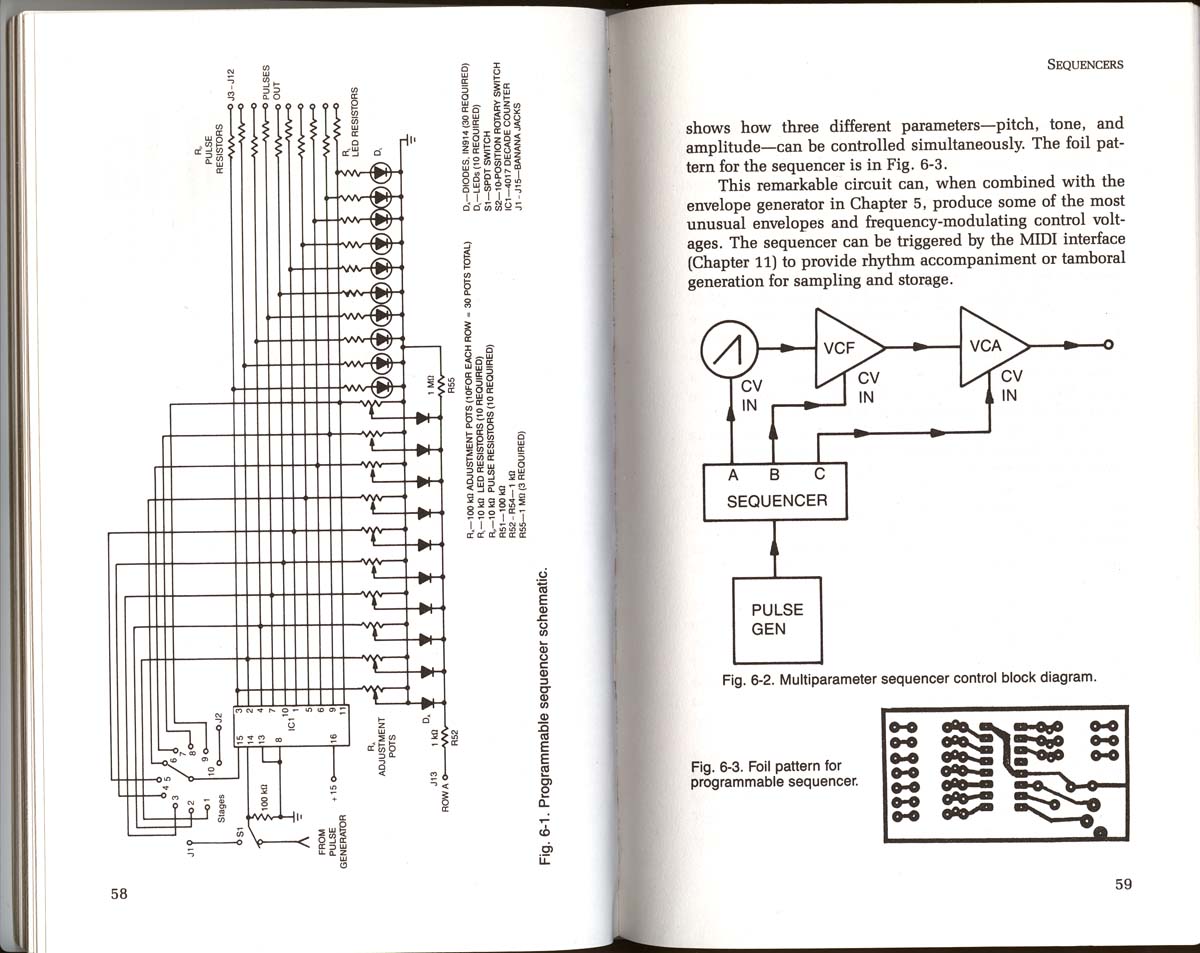

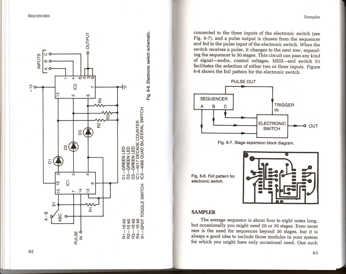

I've seen many versions of this circuit over the years, the first was in a book called "Sound Synthesis" by Terence Thomas. I'm thinking about finally building the sequencer in that book/this one/Baby 10. My concept is one module to act as the clock, then a 8-step sequencer(s) module. First question: Will any NPN transistor work for the clock input? The schematic I have says to use a 2N3365, but neither Mouser nor Digikey has those.
I can scan the article for this sequencer if it's legal and there is interest. It is a very good synth DIY book with many schematics and board layouts. It looks to be out of print. Thanks.

PostPosted: Fri Sep 21, 2007 5:34 am    Post subject: synthetic Reply with quote  Mark this post and the followings unread
please post that article!!
i am trying to build this so it would really help
thanks

PostPosted: Tue Sep 25, 2007 8:33 pm    Post subject: Reply with quote  Mark this post and the followings unread
Let me know if this isn't kosher and I'll pull these.
 Filesize:  124.96 KB
 Viewed:  1266 Time(s)
synthetic
Joined: Jun 02, 2007
Posts: 76
Location: Glendale, CA
PostPosted: Tue Sep 25, 2007 8:34 pm    Post subject: Reply with quote  Mark this post and the followings unread
page 2/4
 Filesize:  171.38 KB
 Viewed:  1793 Time(s)
synthetic
Posts: 76
PostPosted: Tue Sep 25, 2007 8:35 pm    Post subject: Reply with quote  Mark this post and the followings unread
page 3/4
 Filesize:  230.49 KB
 Viewed:  1207 Time(s)
synthetic
Posts: 76
page 4/4
 Filesize:  160.28 KB
 Viewed:  1477 Time(s)
bubblechamber
Joined: Nov 04, 2006
Posts: 280
PostPosted: Tue Sep 25, 2007 10:23 pm    Post subject: Reply with quote  Mark this post and the followings unread
thanks
