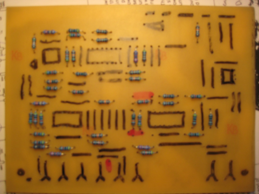

I am trying to build the synbal (and later the syntom) right now. Already etched the board, and i am shopping for the parts now. Apparently some of the semi-conductors are not avaivable easily anymore. I wanted to ask the people who already built it or who could guess by experience, to suggest alternatives. Note, that i am not really picky, and take whatever sounds more or less the same. i dont care much, if it sounds exactly like the original one
IC2: "LM13600", an amplifier chip with 16 pins. "Dual transconductance amplifier", its used at two points in the circuit. first for buffering the envelope, wich is coming out of the decay-control. second for filtering of the signal.----when i searched for this ic i got a result for an LM13700, wich would be available. after a quick internet seach it seems to be very closely related, and also pincompatible. seems like i could use this one instead, but i better ask here before.
IC3: "CA3080" Its, like the LM13600 an operational transconductance Amplifier, and the predecessor of said chip. apparently i could use LM13700 if it was just for the function. but it has much more pins and is not pincompatible. so any help here?
Edit: i just found this chip on reichelt, a german onlineshop. but its 10€ with shipping. plus i read about fake chips around, so i dont know, better have an alternative.
IC4: "741". Not sure about this one. If the LM741 is meant by this its no problem. i think i even still have one at home.
IC101: "4558 or TL1458". According to the text its used in the final stereo mixing stage. i dont even find a datasheet for TL1458 and for 4558 i find several different chips, but just one of them has 8 pins, like needed. Its the RC4558 P, wich you can find here: http://www.segor.de/#Q%3DRC4558P%26M%3D1
do you think this one is suitable? also i am not sure if this final stereo mixing stage is needed if i want just a mono out. there is something in the text about it, but i am not sure if a understood already.
Thanks for your help!

You can easily replace the LM13600 with a LM13700 and in fact the CA3080 can also be substituted with a LM13700... The CA3080 is an OTA and the LM13700 is just 2 OTa's with 2 buffers...
Maybe you should have a look at the Ms20 VCF thread in this Forum... originally designed by Rene Schmitz with 2x3080's here's a layout using just one LM13700...
http://electro-music.com/forum/topic-43085.html
and the original Rene Schmitz design
http://www.schmitzbits.de/ms20.html
comparing the schematics you see how to Substitute a 3080 with a 13700
the 13700 costs 1,20 or so and is less than a third in Price as the 3080... maybe you should use sockets for ic's as from 10 13700's i had on 2 of them one of both OTA's didn't work... so replacement would be much easier. ..
the 741 and 4558 as far as i remember are also obtainable at reichelt...
http://www.reichelt.de/-A-741-DIP/3/index.html?&ACTION=3&LA=446&ARTICLE=23435&artnr=%C2%B5A+741+DIP&SEARCH=741
http://www.reichelt.de/-PC-4558-C/3/index.html?&ACTION=3&LA=446&ARTICLE=23637&artnr=%C2%B5PC+4558+C&SEARCH=4558
for the 4558 there are different types available i guess the MC4558 (icq4558 in their shop) should work...

Thanks for the reply. Unfortunately i build this circuits based on the pcb-Layout posted her, so i etched a circuit board. this makes it impossible to just use the 13700 for the CA3800 since it has more pins. the only thing i could imagine, would be, to make bridges from the desginated pin-holes to a second board where i have the chip soldered to. if i make the bridges very short and take a very small piece of board, just big enough for the chip, it should be not to complicated and even look neat Smile just have to make sure the solder-points of the second board dont touch the first board anywhere.
I would like to NOT order at reichelt, because they charge 6€ on shipping, and actually all other chips (including the 741 and 4558) i could get at segor in their shop here in berlin, so i would save the shipping.

But so far something about the SyntomII. If anyone want to build this PCB after the Layout THeff posted here in this thread before:
1. Note that there are some holes were it might not be obvious later, because they are a tiny white spot, and like in my case, it might be no spot at all later, after etching. So in my case i missed some holes and had to drill them later, where i already populated it a bit. No big deal, but it might be good to know it in advance, so maybe you can change the layout a bit and make the holes a few pixels bigger. I am talking about the holes in the middle of the big black areas.
2. I dont know why but there will be 6 holes wich are not mentioned in the Component Overlay in the Scanned Article from F&MM '83. Maybe the scans are old or what do i know. But i took a picture of this 6 Holes (3 Connections). they are marked with red...I compared to the original schematics and found out that all of them are just simple links. But omitting them, would mean the schematic would not work, so i dont know why they are not on there. Any comments on that from the people who already built them?
 Filesize:  120.12 KB
 Viewed:  606 Time(s)
