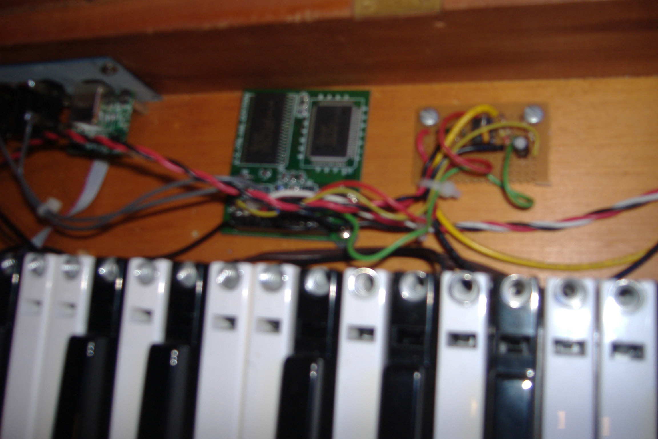

Okay gang,
This one took me way too much time to complete, but I'm ready to start spilling the beans.
What it is: The GM-Voice is a standalone, MIDI driven multiple voice unit. It can create hundreds of pre-programmed high quality instrument sounds---some natural, some electronic---in addition to dozens of percussive instruments. Best of all, the voices respond to dynamics and you can play a minimum of 24 simultaneously! GM stands for General MIDI, as if you hadn't figured that out already.
Total outlay? About $25, if you know how to shop. This is probably the least expensive way to outfit a home recording studio with high quality sounds I can think of.
Here's the scoop. A decade ago our own esteemed Antman wrote me a note on his researches into the possibility of a standalone GM circuit. I was absolutely up to the gills in projects at the time and it's only recently I've been able to return to what he had originally proposed. Moreover, Antman was able to get me the crucial raw ingredient for ten bucks on Ebay a month or two ago, and it's all been downhill since then.
This project takes a Soundblaster type daughterboard, adds a little support circuitry and voila---the computer isn't even needed to extract its magic. It becomes a standalone instrument for the studio.
This is my first joint project with Antman, and it's been a great success. I hope we can encourage him to submit a general overview of the project, the overall process and some purchasing tips for newcomers. (I still have some of your letters from a decade ago---can I post them for general info to builders?) And then, I'll supply the new and improved schems, along with PCB artwork and wiring info.
Here are the features I've included in the Antman/Henry version of the GM-Voice:
- reset button providing emergency all-notes-off action
- MIDI In
- two MIDI Thru jacks
- stereo and mono outputs
- fully buffered outputs for maximum protection
- improved MIDI activity LED shines brightly!
- internal power supply for true standalone performance
- carefully worked out digital/analog grounding for optimal performance
Attached are two photos of my unit. I only have a $25 digital camera, so the quality is a bit punk. but you'll get the general idea. The whole thing is about the size of a brick and looks very nice.

Thomas,
Thanks for finishing this up. Now I think this may perhaps be theee longest project here on the E-M Forum: ~10 years!!
Scott, thanks for moving my other post over to the TH Designs forum. It definitely makes it easier on folks to track down.
Just a few personal notes on this project:
1. Interestingly enough, Thomas has created a desktop module. When we started 10 years ago, I was going for the desktop mounting and bet Thomas he couldn't resist a rack panel due to his track record. So I went ahead and built a 1u rack panel! It still resides proudly in my main rack.
2. I am in the process of building 2 master midi keyboards: a 4-octave unit with pitch and mod wheels and a 5-octave one with a joystick. Both will contain a Gm Voice. The 4-octave one is complete and I wrote it up on the DIY forum. That unit has the same card that Thomas has. The 5-octave joystick unit will have a Yamaha db50XG board.
3. Thomas added the reset button because his unit had trouble a couple times with the RC reset. I've never had any problems and do not have a reset button on my 3 units. I did notice that i used a 47uF cap instead of the prescribed 10uF one.
4. Searching for a card on ebay....a little harder than a normal ebay search. My best finds are just searching for a "soundblaster" under computer desktop peripherals and examining the posted photos. The cards are daughterboards, so if you see a soundblaster with a board stuck to it, you're in luck. Quite often, the seller doesn't even mention it.
Sorry I've been a little quiet lately. I've been tied up with Boy Scouts (camping out this weekend in below freezing conditions!), finding a college for my high school senior daughter, traveling for work, etc. I'll try to get a photo of my rack mount GM Voice and post some public domain midi files playing these things.

Hi again, gang,
As promised, here is the artwork for the GM Voice project. (I survived a grueling 8 hour meeting full of educational mumbo-jumbo today, and yet managed to massage this all into a postable form tonight).
The PCB artwork actually has three boards in one: the interface board, the power supply board and an optional 26-pin connector board. The latter is used to connect the system to your daughterboard. J7 is a 26 pin connector; I sawed down a larger one to solder up my own connector cable, but perhaps you can find a standalone cable and connector and avoid this phase. Also note that you can cut up the three boards like I did after etching, to allow placing the various submodules tidily inside a reasonably small enclosure. If space isn't an issue for you, just make it all on one board and fit it all behind a 1U rack panel.
You'll find .pdf files for the lifesize PCB artwork and the parts placement guide. The labels (along with the schems posted earlier) should make everything clear. But to make the most of this excellent project (hey---getting a couple hundred high quality voices all at once for $25 can't be called anything less), please follow the power supply runs and grounds to the boards and panel very carefully. Digital grounds and analog grounds have a way of tussling more than the Fabulous Moolah with Bobby "The Brain" Heenan, if you're not careful. You'll note on the parts placement guide that there are various multiple pads on the power supply and the interface boards. Use them like this:
Analog Ground:
a. daughterboard
b. interface board
c. front panel
Digital Ground:
a. daughterboard
b. interface board
c. MIDI jacks J2 and J3, and switch S1
+5V:
a. daughterboard
b. interface board
c. LED D7 on the front panel
If you follow these routes, then digital and analog ground only connect at one point (the power supply).
Also note the power supply was so compact, that C6 wasn't needed. So, C6 does not appear on the PCB design I've attached. If you're doing your own design and the +12V supply is far away from the 7805, then use both C8 and C6.
Want to know the currents? Well, the -12V supply draws almost nothing, less than 10mA. The +5V supply draws around 40mA, and the +12V around 80mA (40mA actually, but it also feeds the 7805). These are all small currents, but I still went with the 7805, 7812 and 7912 just so I wouldn't have to hassle around with heatsinks inside a sealed enclosure. Everything should run cool.
This is one of the neatest projects I've ever been suckered into, and I want to thank Antman once again for pushing me along. The acoustic grand piano is alone worth the price of admission, but then there are those other 200 instrument sounds just waiting!
Finally, it took a lot of dinking around with the artwork (I still do all of my designs "by hand"), so if you found this project useful in your own work, please respond here with your results; Antman and I will be suitably honored. A large cheer from the crowd makes it more likely other projects will appear in the future. Remember, we don't do this for an income (that's why we like electro-music---none of us are here to make money, but to make music and help each other)

Dear Folks,
Here's some photos on my 2 Gm Voices. One is rack mounted and was built nearly 10 years ago when Thomas and I started this whole mess. It's the purple (yeah, I know Embarassed ) panel in the middle of the rack.
The other is built into my 4 octave midi controller. Note the daughterboard and the interface board built on perfboard to the right.
 Filesize:  702.93 KB
 Viewed:  1379 Time(s)
 Filesize:  576.37 KB
 Viewed:  1444 Time(s)
