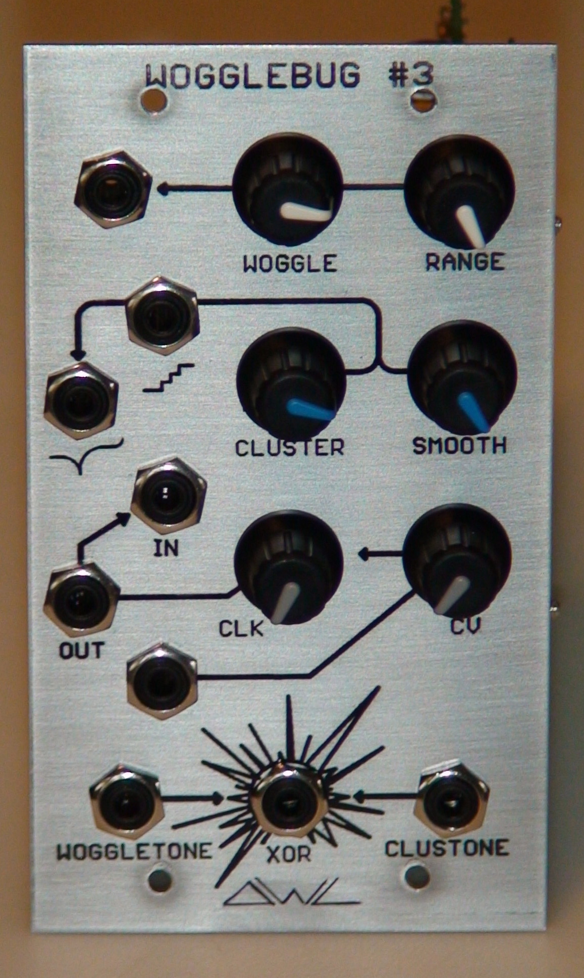

Any options for adding some LEDs to the panel?
Ken Stone's LED driver can be modified to add LED's to most things, it's worth looking at if you're pining to have some fairy lights back in your life so soon after Christmas!
I usually have to dissuade myself from hanging them off every output..

unit-sound wrote:
You should have put Grant Richter's name on the panel.
He is the guy who designed this fantastic module and gave it to the diy comunity!
v-un-v
Joined: May 16, 2005
Posts: 8932
PostPosted: Tue Jan 08, 2008 2:17 pm    Post subject: Reply with quote  Mark this post and the followings unread
I must admit, I think Dennis is spot on here. The actual Series 300 Wogglebug module costs a small fortune- to have it available as a DIY project is a very amicable gesture. Putting Grant's name on the panel is the least that should have been done. Idea
Sorry to be so blunt. Smile

PostPosted: Wed Jan 09, 2008 5:24 am    Post subject: Reply with quote  Mark this post and the followings unread
this looks cool

PostPosted: Wed Jan 09, 2008 5:26 am    Post subject: Reply with quote  Mark this post and the followings unread
so have we worked out if there is anything missing from the PCB here and a real Wiard Woggle?

PostPosted: Wed Jan 09, 2008 9:03 am    Post subject: Reply with quote  Mark this post and the followings unread
I love that XOR out! Very Happy
Nice panel too.

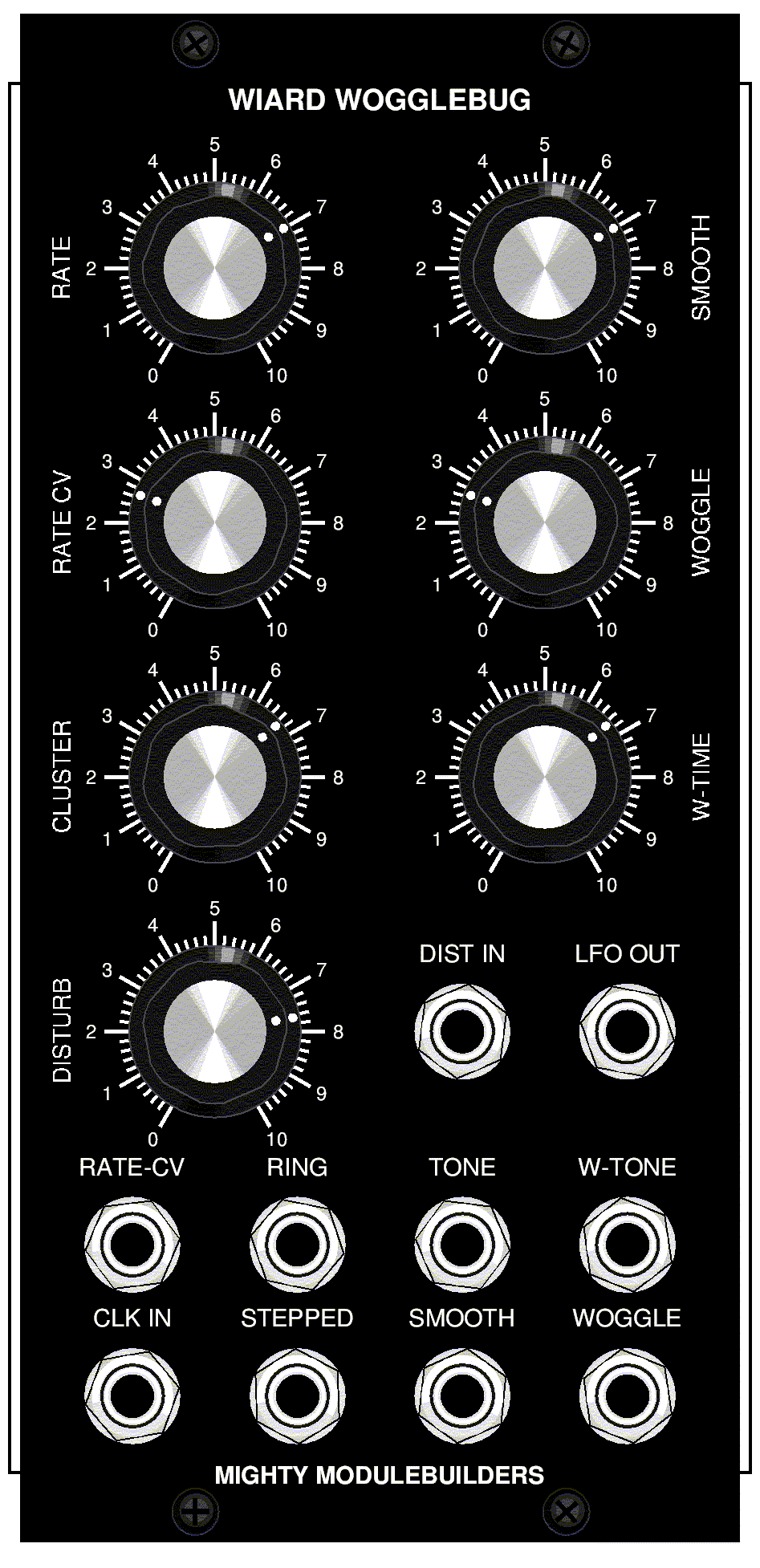

PostPosted: Fri Jan 11, 2008 9:07 am    Post subject: Reply with quote  Mark this post and the followings unread
@stegoman (and all).
i have redesigned the front panel after your ideas:
 Filesize:  150.99 KB
 Viewed:  272 Time(s)

PostPosted: Fri Jan 11, 2008 9:13 am    Post subject: Reply with quote  Mark this post and the followings unread
Have you tested the Disturb function as added to the original PCB?

amnesia
Joined: Jul 29, 2006
Posts: 149
Location: amnesia
PostPosted: Fri Jan 11, 2008 9:31 am    Post subject: Reply with quote  Mark this post and the followings unread
with this woggle pictured i cant understand what all the in /outs and knob names are.
the names seem different ie WOGGLE and RANGE i know the graphics are stepped and smooth but what are the others?

goldenechos
Joined: Jun 06, 2007
Posts: 201
Location: Marshall, NC
PostPosted: Fri Jan 11, 2008 11:55 am    Post subject: Reply with quote  Mark this post and the followings unread
Which controls do you not understand?
One thing about the wogglebug is that the Cluster and Smooth controls affect more then just the Clustone (cluster audio out). They also affect the Woggle CV (next to the Woggle control) and the Woggle audio (called woggletone on my panel).
I guess I just named things for what they seemed to be doing. I have since made a couple of changes in my panel design, and I hope to make a new panel soon.
The word woggle sounds like "wiggle" and the woggle control seems to make the woggle CV (and thus the woggletone) wiggle more. The Range control seems to affect how much range the woggle CV has.
The Cluster control seems to affect the sample and hold circuit, varying the number of CV changes created (note clusters). The Smooth control, well that name is somewhat misleading, as it seems to affect the range of the smooth CV to the Woggle and Cluston circuits... I just did not want the word Range on my panel twice.
I called the LFO a CLOCK because that is what iti is doing, it is clocking the S&H circuit.
Hope this helps.
