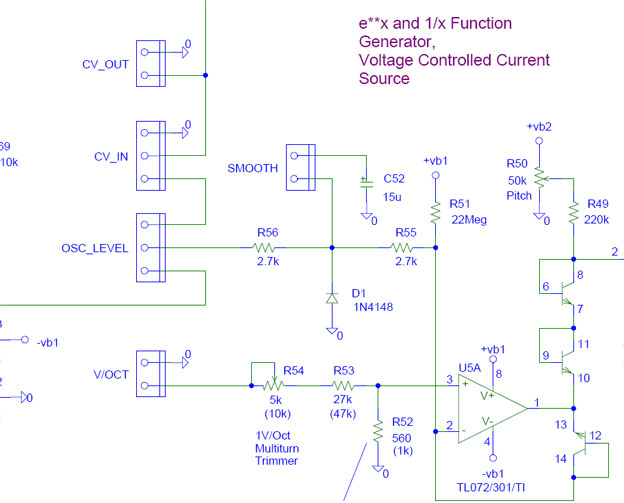

PostPosted: Mon Mar 17, 2008 4:23 am    Post subject: Reply with quote  Mark this post and the followings unread
can anyone easily add another cv linear input ?
adding an 2k7 resistor between R56 and R55 ? or at U5A -IN (pin 2) ?
BTW, the SMOOTH function (which only consists of a cap tied to ground ?) is great.
 Filesize:  51.45 KB
 Viewed:  190 Time(s)
jhaible
Joined: May 25, 2007
Posts: 2014
PostPosted: Mon Mar 17, 2008 4:54 am    Post subject: Reply with quote  Mark this post and the followings unread
This CV path, while linear in terms of delay time, is 1/x-law in terms of pole frequency and ladder current.
That means, the range must be set precisely in order to get a cool effect: You have that 22Meg resistor for one end of the range (R51), and only 5.4k (2.7k * 2) for the other end.
Simply adding another 2k7 resistor may reduce the range because of mutual loading of the different CV paths.
So in order to combine more CV paths here, you'd have to buffer the input (left side of R56) and do the summing befor that point, and you'd have to make sure that you stay in the "good" range. (Whatever this means ... well, try it, experiment ...)
JH.
