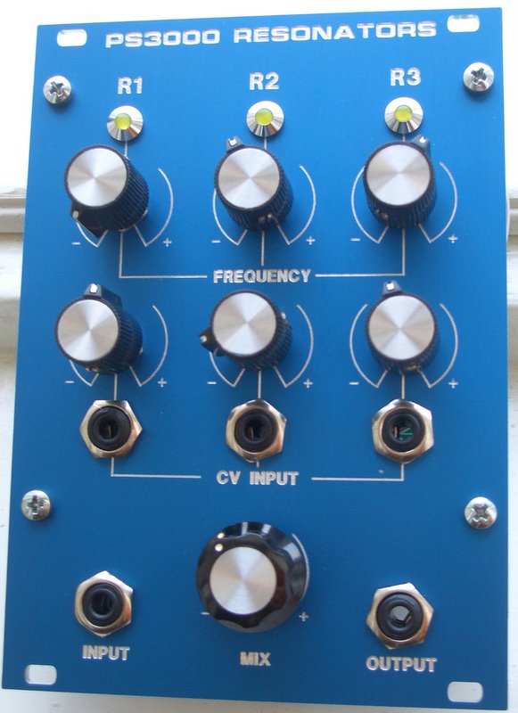

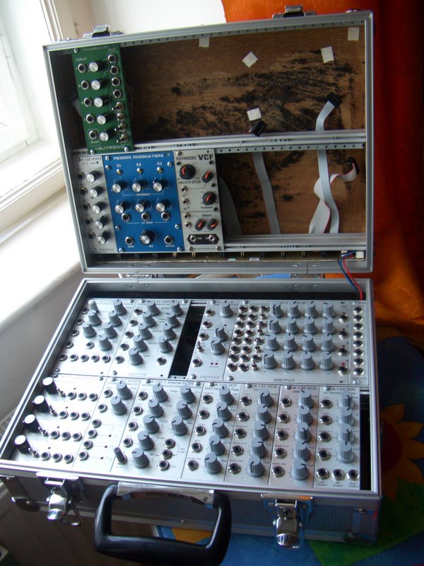

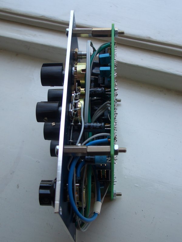

PostPosted: Sat May 17, 2008 7:29 am    Post subject: Reply with quote  Mark this post and the followings unread
ready and working! love that sound.
unfortunately it became a PS3000 resonators module, instead a PS3100 Rolling Eyes
..guess i have to live with that.
i left out the LFO since i have too many anyway and added attenuators instead. somehow the att on the first reso does not work - probably the potentiometer is dead or it has to do something with the switching to the other jacks. the other two work perfect.
anyone some ideas what it can be? before i dissasemble the whole thing to exchange the pot.
however, thanks or that great PCB!
hel

PostPosted: Sun May 18, 2008 1:03 am    Post subject: Reply with quote  Mark this post and the followings unread
helitron wrote:
ready and working!
Not that it really matters that much, but you do know that you've labeled your module a PS3000, instead of a PS3100?? Shocked
Edit;
Embarassed Laughing
read the fucking post Tom before looking at the pictures first!! Laughing

PostPosted: Sun May 18, 2008 1:20 am    Post subject: Reply with quote  Mark this post and the followings unread
yep, i am still pissed about that ... dont know what happened there, must be my numerophobia Shocked

PostPosted: Sun May 18, 2008 11:54 pm    Post subject: Reply with quote  Mark this post and the followings unread
great work! great design! the blue finish looks very nice, i will try that on a project, too.
i fear i know how you ended up with a PS3000. if you used the fpd file from my site as a template you just may have copied my typo...

PostPosted: Mon May 19, 2008 12:06 am    Post subject: Reply with quote  Mark this post and the followings unread
ha ha. yes its true, was using your template to make that frontpannel. and i was wondering why the hell i changed the writing from 3100 to 3000. but it was 3000 all the time. i should pay more attention when i am making frontpannels, that was not the only thing that went wrong this time - i had to redrill aprox all holes because i forgot to set them to the right size.
however, yes the blue finish looks really great, i didnt expect it to look that good. same goes for the green ones.
hel
