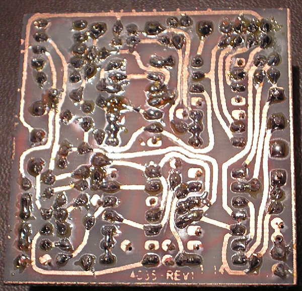

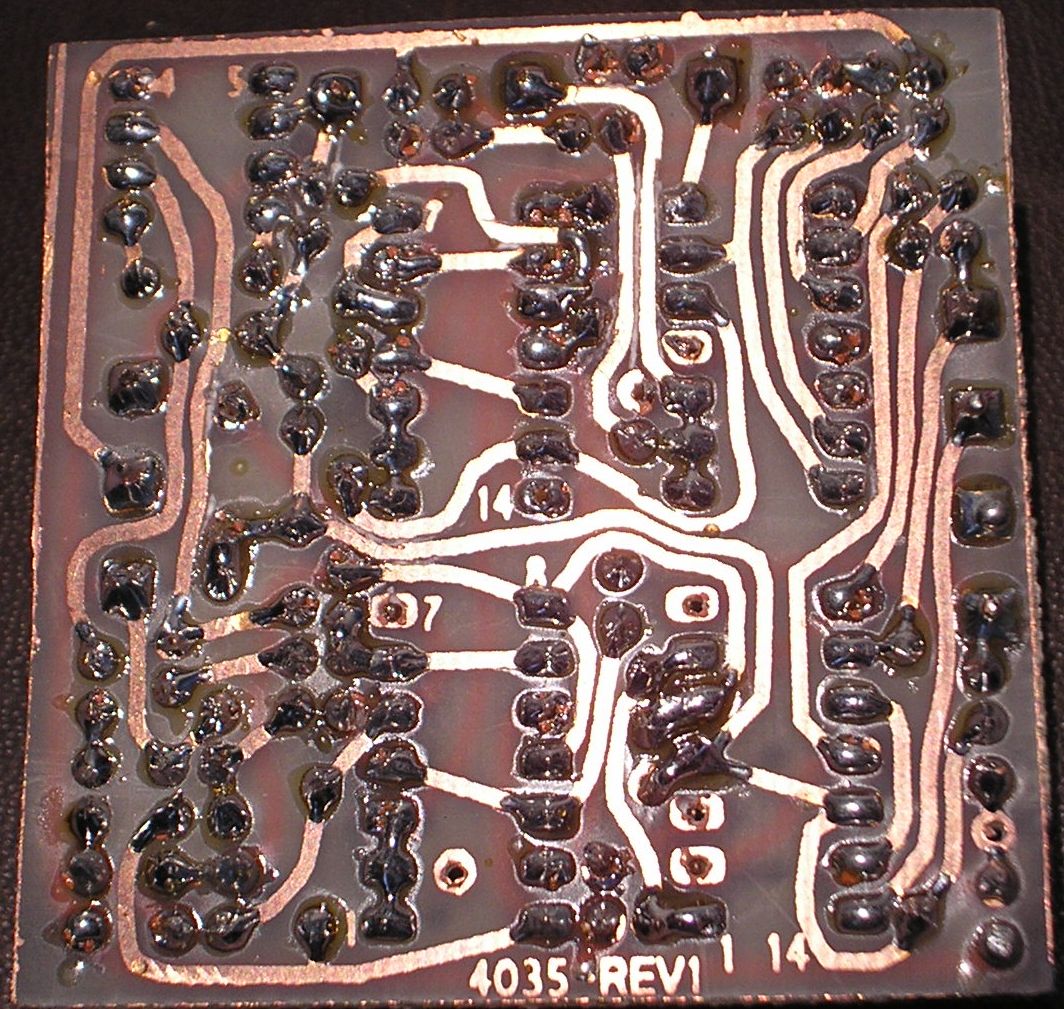

Joined: Oct 10, 2008
Posts: 13
Location: west
PostPosted: Tue Oct 28, 2008 8:51 am    Post subject: Reply with quote  Mark this post and the followings unread
AndyR1960 wrote:
Any chance of hi-res pics of both sides of your PCB?
I've built several 4035 modules with no problems - I'd like to see if I can help.
Hi Andy,
Thanks for your support.
Please find the pics enclosed.
I started with 4035, then I changed back to 4034, but no luck at all.
Probably I should build a test gig, and test the filter alone.
As you can see, I have used the equivalent TB331 that I had around, 2 BF245A as fets, and a simple 2-watt resistor instead of the tempco.
Any hints?
Respect,
3nity
front1

Broadwave
Joined: Feb 16, 2007
Posts: 347
Location: Manchester UK
Audio files: 6
PostPosted: Tue Oct 28, 2008 11:23 am    Post subject: Reply with quote  Mark this post and the followings unread
I've found something... My fault I'm afraid - DUH!
Next to the left of your 2W 1.8k resistor, on the edge of the board, you'll see two pads with no components soldered in - you need to link them with wire and solder through on both sides (see attached JPG).
This is the only thing I can see that could be the cause of it not working.
I've updated the original PDF... Apologies to all.
Andy.

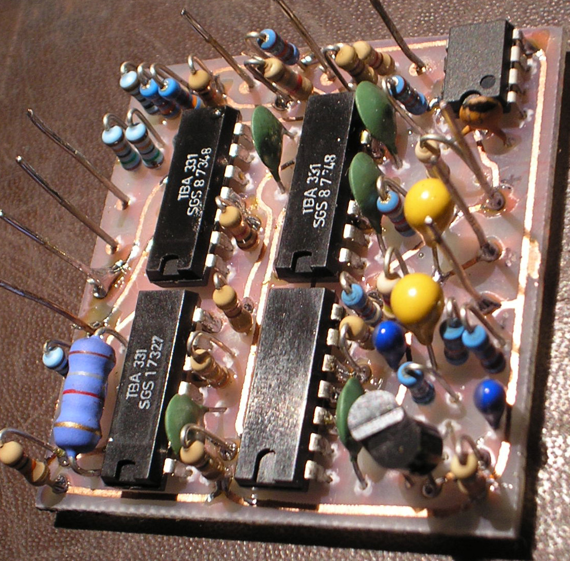

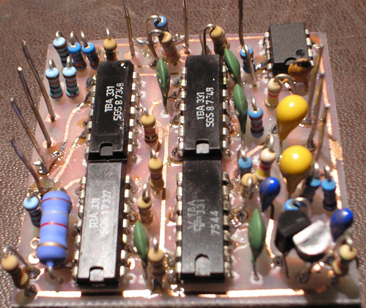

What type of caps are those in both 3nity and Andy's pictures, the yellow and blue bulb shaped ones. They are tantalum?
3nity
Posts: 13
Location: west
PostPosted: Thu Oct 30, 2008 11:27 am    Post subject: Reply with quote  Mark this post and the followings unread
Yes.
2nd ATTEMPT
1) I remade the foil, since I realized that in the old one the emulsion was up, so I could get a more precise development.
2) I re-etched a new pcb, double-checking for shorted traces, and correct all the errors.
3) I mounted the whole board again. Now I have DIL sockets for the IC's, found the original CA3086 from RCA, and 2 BF245B.
4) Double-checked again for errors.
5) Reconnected the test rig, with the trimmer and the two pots.
6) Fired up!
RESULTS :
It immediately seems to be working.
Frequency and resonance controls respond correctly.
The mains hum is still there, but it depends on the fact that the board is not encapsulated in a screening can, so it picks up electro-magnetic fields from around, especially when near a transformer.
Now I'm tired.
Tomorrow I am fitting my new 4034 filter (I sticked to the old Tonus design) inside my old Odyssey II, and see what happens. Let's cross the fingers.
All for now.
Respect.

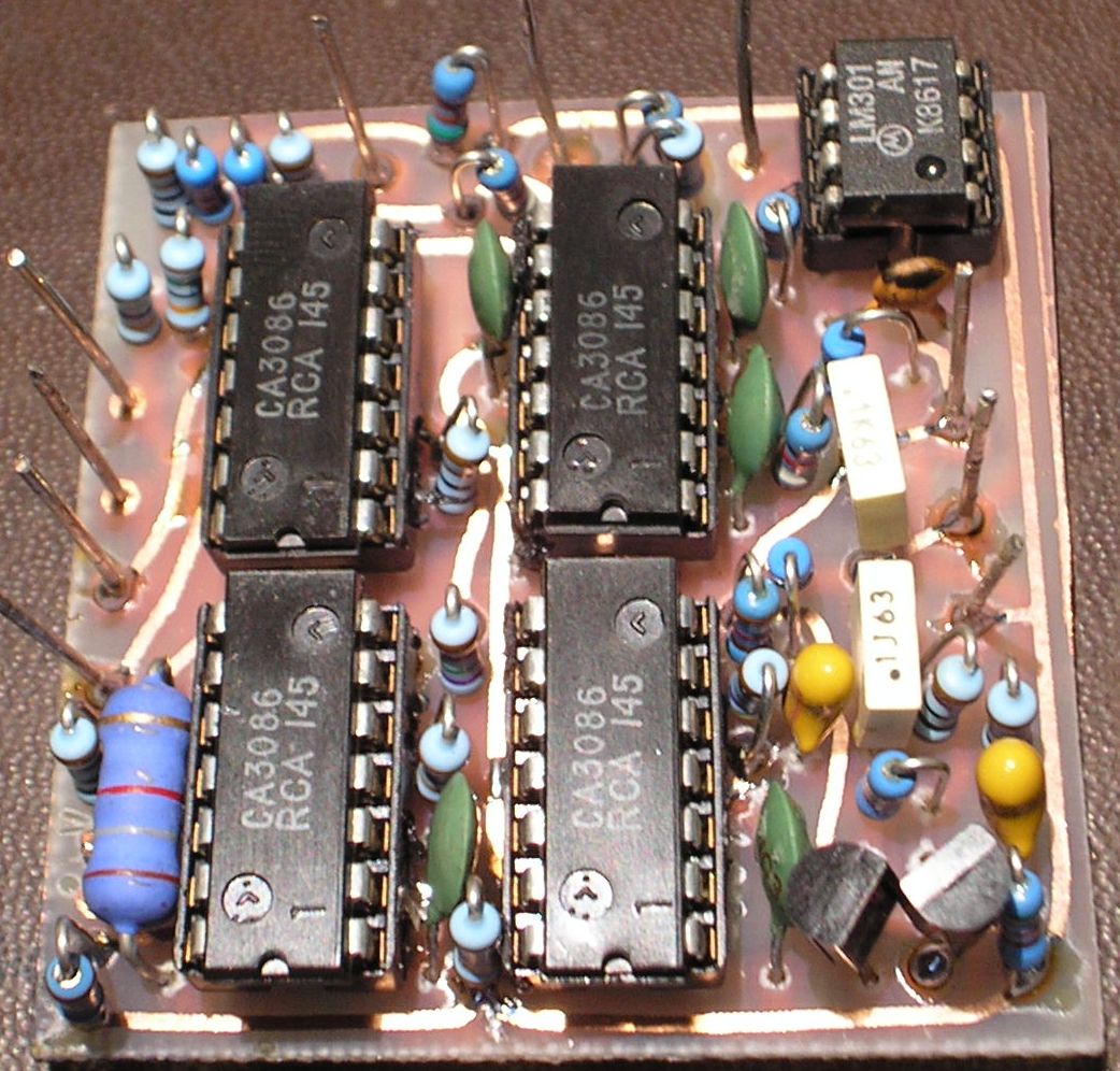

UPDATE
Finally I have fitted the 4034 in my Odyssey II.
The sound is somewhat moog-ish as you already know.
I like it.
Some issues (but this depends on the C-II board of the synth):
1) I cannot set the correct VCF CUTOFF frequency, which should be 16Hz, well actually it is 67Hz, and if I turn the R71 trim more cw, the oscillation disappears.
2) VCF/OCT R68: it won't go beyond 700Hz (it is supposed to be 800Hz).
3) I have to remake a new power supply, because the old one is always fluctuating, and the synth is never tuned.
Beside that, it is a great analog synth from 1974.
And here are the pictures of the new version filter.
Enjoy!

Broadwave
Posts: 347
Audio files: 6
PostPosted: Sat Nov 01, 2008 2:29 am    Post subject: Reply with quote  Mark this post and the followings unread
Hi 3,
From the looks of things you built the 4034, which was designed for the Pro-Soloist... I'm just wondering if that may be why you're not quite getting the response you expected. Maybe the Pro-Soloists "off-board" components (audio and CV mix and resonance sections) are different from the Oddy.
I'll have a scout round and see if I can come up with anything.
