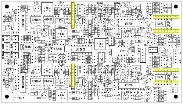

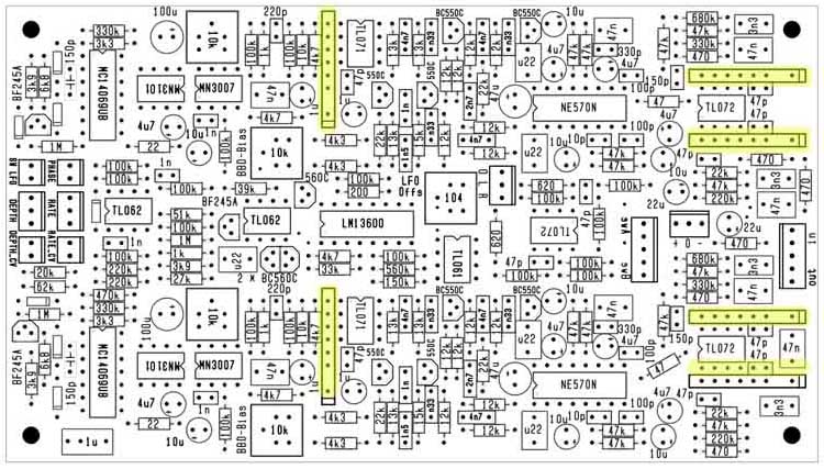

What are those 6 rows of holes in the attached diagram? Are those wire bridges? Can I just link all holes together?
 Filesize:  117.43 KB
 Viewed:  206 Time(s)

Those are for the vintage HA1457W SIP op amps. If you're not using those I think you can leave these disconnected.
jhaible

PostPosted: Fri Jan 09, 2009 9:18 am    Post subject: Reply with quote  Mark this post and the followings unread
No, by all means don't short them together!
Just leave them open.
This is where the HA1457 opamps go, in the "vintage" version. (In that case, don't solder the TL071 and TL072 opamps in.)
JH.
JH.
