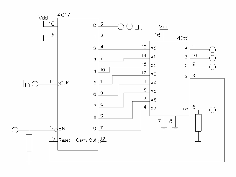

Thanks
For that patch I was using the little melody generator I mentioned in my other post, with a 4024 clocking the ABC inputs, and an audio rate clock into the clock input. The output from that was then fed into the clock input of a 4089 set up like this, and this was clocked with different pins from the 4024.
In the second half of the clip I fed a second audio rate clock into the Clock enable pin of the 4017 to get the ringmod type sounds. The different melody is from using a different combination of 4024 outputs to clock the chips.
Here's a quick schematic of the melody generator, like I said I can't take any credit it for it I just took it from voks's schematic. I think I'll hardwire one when I build my Lunetta but you could just patch it up if you already have the chips in yours.
You can take the output from any of the 4017 outputs and get different patterns.

that melody generator makes some cool sounds, would you mind explaining how the 4052 and the 4017 interact together to produce those sounds?

Basically, the length of the pulses on the 4017 pin 3 (Out) in relation to the clock pulses on pin 14 (In) depend on which number it's counting up to. If it counts to 2 it's twice as long so half the frequency of the clock, if it counts to 3 it's 3 times as long so a third of the frequency and so on.
The outputs of the 4017 connect to the inputs on the 4051, and the output connects back to the 4017's reset pin. The signals on the A,B and C pins set which output gets connected to reset and this sets the number the 4017 will count up to, and therefore what note it will produce.
To make it play tunes you feed an audio speed signal into the 4017 clock Input and feed different clock signals into the ABC inputs. Changing the combination of signals on those pins gives you the different notes and patterns.
The 4017 clock enable (pin13) adds modulation, at slow speeds you get tremolo effects and higher speeds give ring mod type sounds.
Hope that makes sense.

thanks for the explanation, big help!

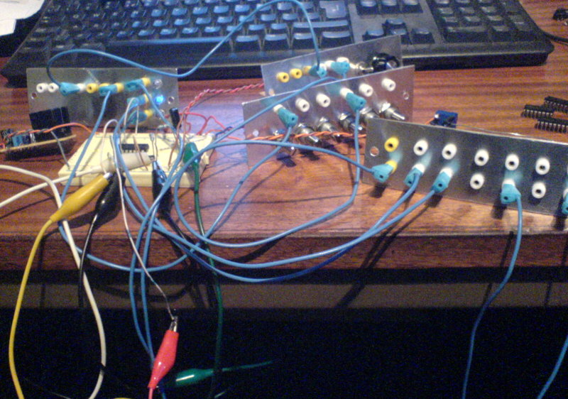

Here's another couple of little pieces. I've been listening to the great stuff in the Klee musics thread so these inspired by that.
I whacked the output through a delay pedal into an amp and then recorded that so there's a bit of hum and the odd crackle.
The first one gets a bit loud at the end, so watch your speakers Very Happy
Lunetta doing its thing.
