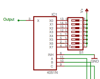

I'm not sure about clocking each 4017 differently - I 'spose you could also reset each 4017 using Lunetta clocks/counters, too.... I have not yet tried either of these.
Anyway - Without the 4066 switches on the output it's this bit of circuit. Someone else throw it together and see what you think.

Otay! That's all, good enough to me! Very Happy When I do the PCB, I'll leave the clocking connections for each of the 4017's, OPEN so that I can assign them the same clock, or individual. If the latter works well, then I will finalize the front panel, for the switches. If not, then I'll leave them all to the single clock input.
Thank you for your further analysis! Looking forward to trying it out! Very Happy
