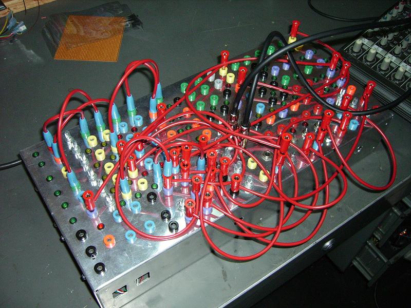

Here's the first patch from the new Lunetta.
It's raw, it's self playing - and here's what it sounds like.
bruce
Here's what it looked like....
 Filesize:  119.94 KB
 Viewed:  519 Time(s)
Lunetta2.mp3
 Filename:  Lunetta2.mp3
 Filesize:  3.78 MB
 Downloaded:  1690 Time(s)

Hey Thanks for the feedback Rych - It's very encouraging that you liked what it's doing.
I'll get the values from the R/2R to you later - I don't have them from this 'puter.
Actually, I didn't use the melody generators on this patch at all. Those are found in the conspicuously patchless lower left corner of my box.
Mostly what was used there were R/2R being fed from two 4094 8 Bit Shift Registers...
Here's what I recall... although my attempts at describing Lunetta patches in the past has been attrocious. Embarassed
4 clocks
2 clocks to Clock input of 4094 8 bit registers.
1 clock to data input of 1st 4094
1 clock to a 4 bit register then to a Binary counter...(mainly this is just a delay of sorts.) That then goes to a R/2R input.
One output (# 5?) from the first 4094 is into the Data input of the second 4094.
3 outputs from each 4094 go into the R/2R.
Various other 4094 outputs - and serial outputs go to the VCO's or into the R/2R...
Timing on the clocks comes down to twiddling until it does good things....
Anyway - there's really not much involved in this patch - except lots of trial and error.
Clear like mud?
I'll get the R/2R values to you this afternoon...
bruce

FWIW
Here's a clip using 4 4017's to divide a single Lunetta VCO's audio into 7 parts. /2 /3 /4 /5 /6 /7 /8. (It's the 4017 layout portion of the CGS pulse divider)
The output of the divider is summed, and the divisions are switched in and out by other portions of the Lunetta - counters, shift registers, etc. by 4066 bi-lateral switches.
It's different. The jury is still out on this, I think.

I listened to the track almost a full 2 x.
I'm ...... not sure. Confused
(Please note on the following: my interpretation is IF I understood it correctly. I may be mistaken in what I heard. Wink )
There were a strong amount of note progression, repetition. That would be from the controllers over the 4066 switches themselves though, wouldn't it?
I would try activating the switches, not only at different integer divisions, but at different frequencies from other clocks.
Also - summing the outputs from the 4 x 4017s.......
Scrap all that I just said. Sad
I just had a look at Ken's schematic again on this one. I'm now possibly tending to agree with you.
That's a fair amount of hardware, with only 7 division outputs, thereby possibly limiting the possibilities coming FROM the unit.
1 possibly salvaging thought - would be having the option of driving the 4 x 4017's from different clocks; summed / logic'd inputs to each of their clocks. That would then completely mess up with the output logic, but could it possibly bring a further useful variance??
Jury's now out on this one for me as well. It could be, too limiting. Sad
Thanks for going to all of the trouble to get this one up and going though, Bruce!
Mmmmm. I wasn't sure whether to upload this MINIMALIST piece or not, but I'll send it up, to hopefully cheer up your ear!
I did this track last night, wishing to see what it could sound like to feed the 8 outputs from my 1 input to 8 output multiplexer, into my 8 input R-2R DAC.
I changed a couple of the DAC's inputs (after hearing ONLY 2 different notes) to outputs from 2 of my 4 bit shift registers and added in the function of my 4 Stage LFO.
The outputs of the DAC and the 4 Stage LFO are both modulating a single Liquid Voice at differing levels, through the 6 minutes piece.
