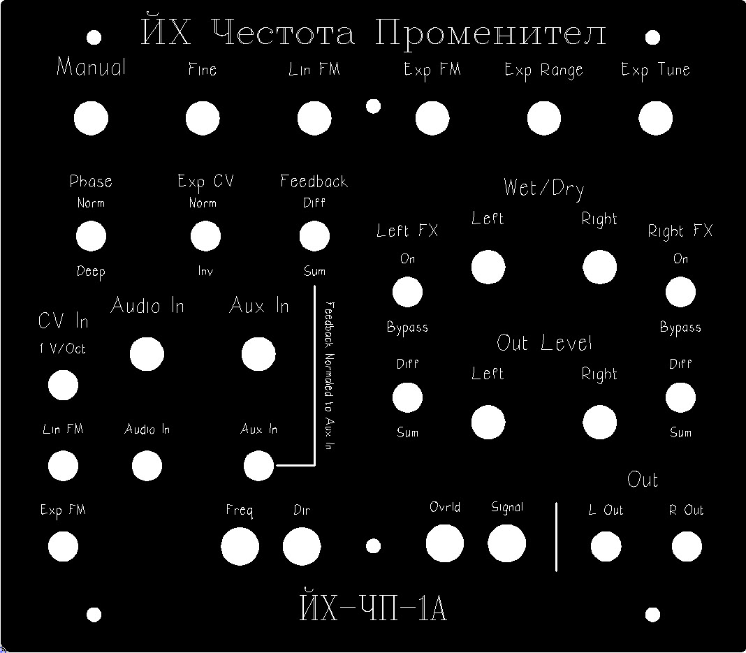

PostPosted: Fri Apr 10, 2009 10:23 pm    Post subject: FracRack panel Reply with quote  Mark this post and the followings unread
Last update I hope.
I've uploaded one last version. I got rid of the Mic/Line jack and am just using an auxiliary in and an "Audio" in. The only difference is the Aux in is normaled to the feedback (per JH's connection diagram). The "Audio in" bypasses the mic pre-amp and is a simple unbalanced input (similar to what Dave Brown did I think).
I also relabeled and reorganized the knobs to make more sense, I hope. Instead of up/down, or on/off, I used sum or diff as this was what the switches are connected to.
I've sent this one off to Schaffer for building.
Again, I used Bulgarian for the name, JH Frequency Shifter, and JH-FS-1
Thanks JH for some truly amazing projects.
David
