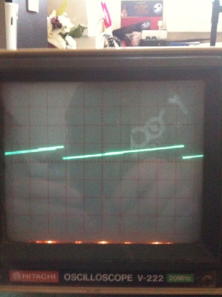

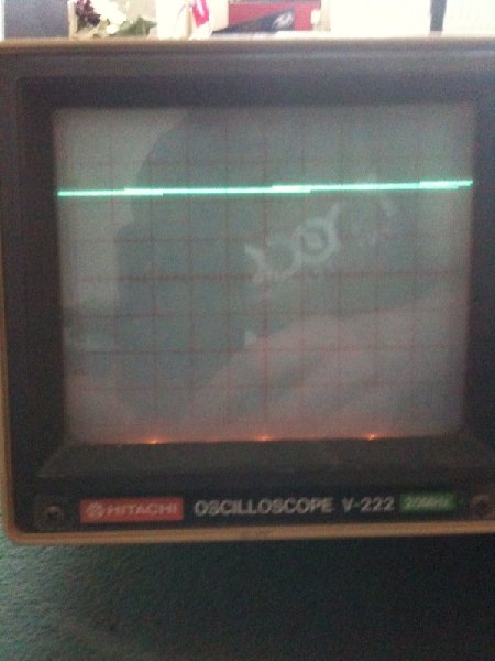

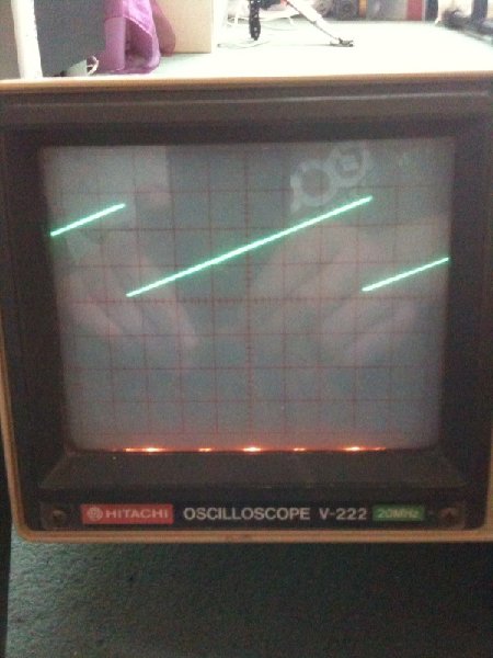

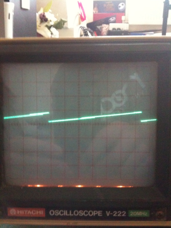

I've finally got some time to try and debug the 2nd VCO which isn't quite working as it should. I've checked the wiring which it all seems correct so I'm a little stumped!
VCO1 seems to work fine - I get a healthy saw and pulse output from the respective outs. VCO2's saw doesn't have the same level as VCO1's and I get nothing out of the pulse output. I've attached some oscilloscope pics.
Where should I start looking for problems?
Thanks a lot!
PS. Each square is 2 volts on the oscilloscope.

PostPosted: Tue Sep 29, 2009 2:00 pm    Post subject: Reply with quote  Mark this post and the followings unread
I recently built an experimental single version of the VCO and had exactly the same problem - I did manage to fix it... but did I write any referral notes down - no of course I didn't Confused
I'm desperately trying to remember what I did, but first of all check the sync input. Do you have the switch fitted from VCO 1, because VCO 2 will have problems if you leave the sync input floating - It either has to have a signal from VCO 1 or must be tied down via the 100k and 150k right next to the sync switch pads.
The next thing is to check the CD4011 - I definitely remember there was also something about loading on the output (one of the nand gates is used as a buffer for the square wave output).
I hope this helps - next time I'm problem solving, I'll takes notes!

PostPosted: Tue Sep 29, 2009 2:09 pm    Post subject: Reply with quote  Mark this post and the followings unread
I do have the switch in and I can hear it syncing when I turn the switch on, so I assume it's working. I'll check the wiring in the morning just in case.
When you say 'check the 4011' do you mean check it's getting the correct voltages? I don't suppose you have a list of the correct voltages at the pins at all? I have a couple of spare 4011s so I'll try swapping them in.

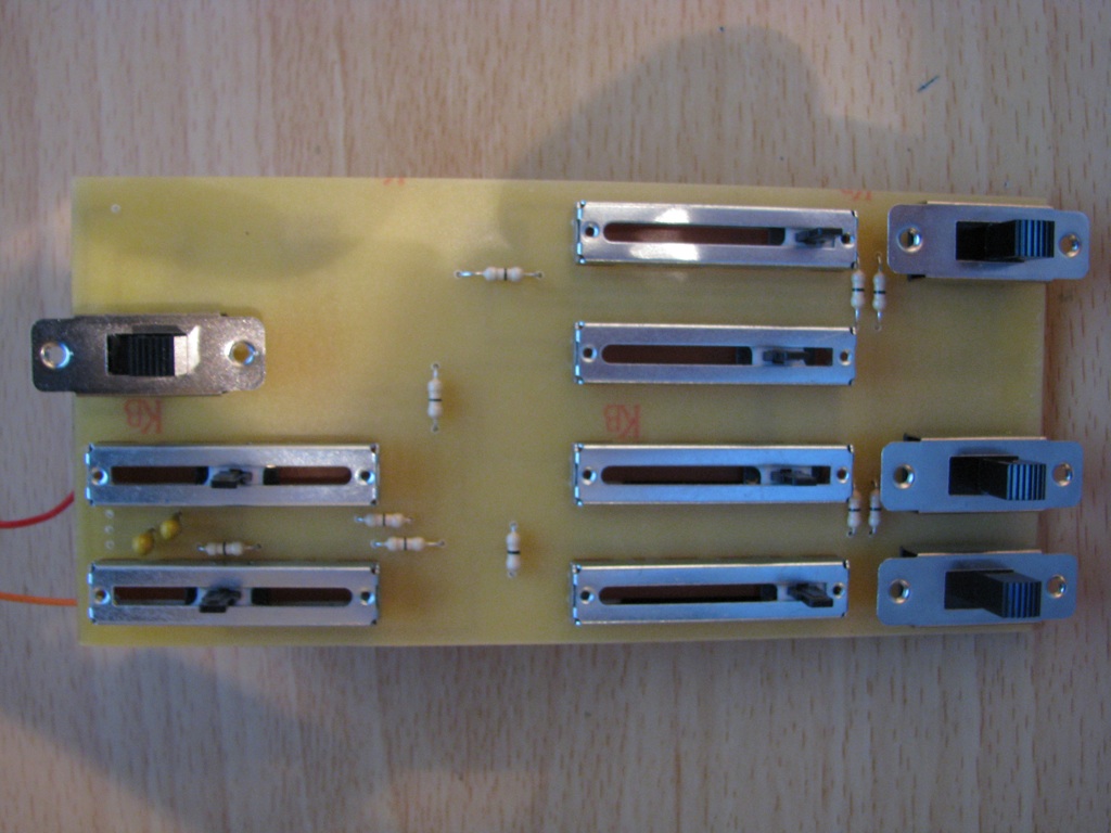

BTW, as an addition to this thread, I mentioned above a single VCO version I was working on. I was building a compact clone of the Odyssey - got as far as the two VCO's, S/H mixer, LFO, noise and VCF mixer, and then I got a MKIII Odyssey off ebay.
I guess I should finish this project... one day... maybe...
I've used 30mm sliders - the width of each section is the same as the Odyssey, but the depth is 4 inches shorter.
 Filesize:  183.19 KB

PostPosted: Wed Nov 11, 2009 7:47 am    Post subject: Reply with quote  Mark this post and the followings unread
I was comparing the voltages beetwen VCO1 and VCO2 and the pitch of VCO1 is shifting when I touch the grid of its JFET (Q6) with my voltmeter probe while there is no effect on VCO2 if I touch the grid of its JFET (Q13).
Is this a clue?
Thanks
Nicolas
