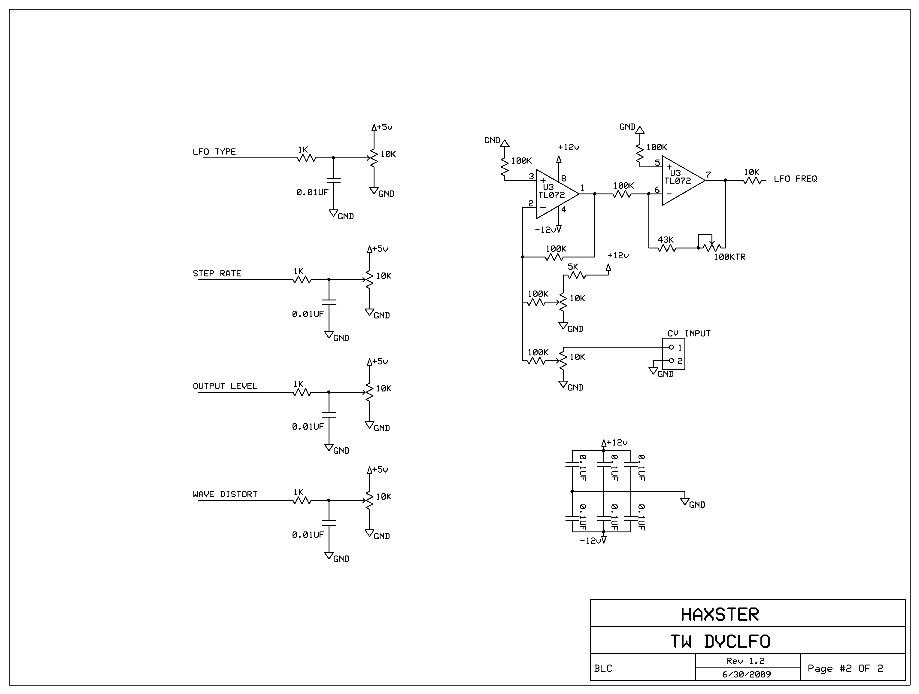

Here's the schematic for the DVCLFO core.
 Filename:  REV1.2_PAGE1.bmp
 Filesize:  866.31 KB
 Downloaded:  453 Time(s)
 Filename:  REV1.2_PAGE2.bmp
 Filesize:  866.31 KB
 Downloaded:  416 Time(s)

I'm about to finish up my LFO but there are a couple of caps that I can't find the value for. The ones marked with red.
haxster
Joined: Feb 01, 2006
Posts: 246
PostPosted: Sun Jan 10, 2010 4:28 pm    Post subject: Reply with quote  Mark this post and the followings unread
The one at the bottom is 0.1uf, that is for the GLIDE/portamento
The two Cap pairs are for the Analog LFO's. Pair them with values like this: 0.0047uf, 0.01uf. You are free to experient with values. The higher the cap the slower the LFO. For example 2UF NP will make it go really slow.
A good combo is like this: 0.00xx uF, 0.0x uF.
The Last one circled in red is an LED not a cap.

PostPosted: Sat Apr 10, 2010 5:49 pm    Post subject: Reply with quote  Mark this post and the followings unread
haxster
did you use this schem for the analog lfo?
i cant seem to get the square / ramp switch working
can you provide a wiring diagram for this for me
it is hard to know what is going on with no real schematic

i finally found the schematic for sl-plus lfo
there is no link for it on the mfos site anywhere but luckily the page is still there and i was able to find a link to it on a forum thread

Did you figure it out yet or do you still have trouble? If I recall on the first run, the Analog LFO has the 1 2 3 labeled wrong I think i mentioned this on the previous page.
Luka
Joined: Jun 29, 2007
Posts: 1003
Location: Melb.
PostPosted: Wed Apr 14, 2010 1:15 am    Post subject: Reply with quote  Mark this post and the followings unread
my pcbs were from 2nd batch
i think i have got it now, yet to test
ive been working on my mods to the digital lfo today but ill test this again now
the problem was i had no idea how those numbers match the switch pins
even now that i have an idea of how to route the wires the numbers dont make sense to me
how can 1 and 4 mean the center pins of the switch?
is this correct?
i usually think that dpdt switches are like this
1 4
2 5
3 6
where as i think you have it like this
2 5
1 4
3 6

It's like this:
1 is the center, then 2 is above, then 3 is below (that's one column)
2
1
3
next 4 is the center, then 5 is above, then 6 is below (that's one column)
5
4
6

ok that works
my square is almost rail to rail whereas the tri is 10vpp

so has anyone built their lfos?
i have finally got mine completed
the squarewave on the analog lfo was running rail to rail (30vpp)
i used a simple voltage divider (49k9/27k) to get it down to 10vpp
i also implemented vc-sample'n'hold, vc-waveform selection, vc-phase distortion
took a lot of work to get it going but it was worth it
