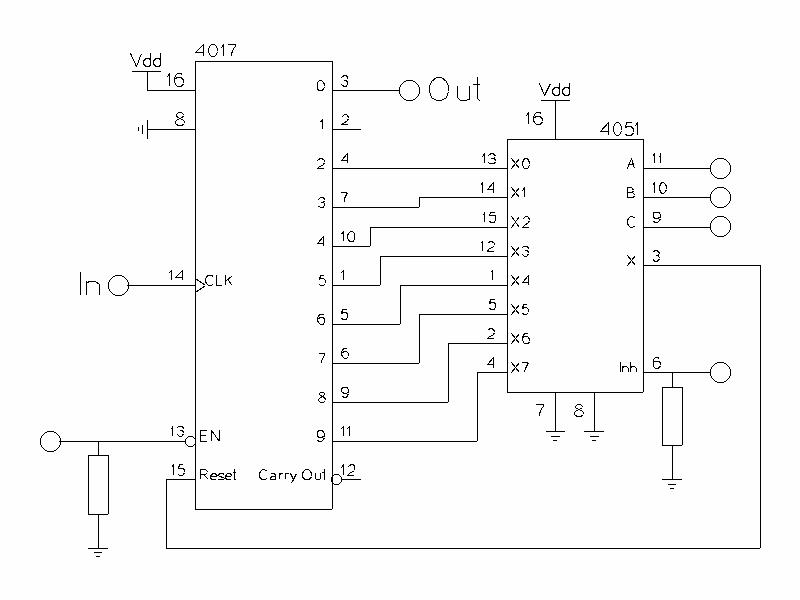

I've been seeing a lot of set ups having this little circuit built in, and a lot of really good sound clips seem to come from it. So, how exactly does the Melody Generator work? Should all the inputs be oscillators of some sort? And then on the schem, what does the "EN" stand for? I'm sure I just missed something in the datasheet, but oh well Rolling Eyes
So what have your guys' experiences been with this neat little module? Smile

Ive had exactly the same experience with the melodygenerator. No clue how it works, but boy does it work Smile. The ABC outputs on the 4051 can be hooked up to clocks or audio osc, but Ive also had good results with dividers and multiplexers.
The EN stand for engage, you can feed it a square and find out what it does. Same goes for the pin 6 on the 4051.

Nonetheless - here's the explaination given by by slacker from this thread...
http://electro-music.com/forum/topic-27239-50.html
<<SNIP>>
Basically, the length of the pulses on the 4017 pin 3 (Out) in relation to the clock pulses on pin 14 (In) depend on which number it's counting up to. If it counts to 2 it's twice as long so half the frequency of the clock, if it counts to 3 it's 3 times as long so a third of the frequency and so on.
The outputs of the 4017 connect to the inputs on the 4051, and the output connects back to the 4017's reset pin. The signals on the A,B and C pins set which output gets connected to reset and this sets the number the 4017 will count up to, and therefore what note it will produce.
To make it play tunes you feed an audio speed signal into the 4017 clock Input and feed different clock signals into the ABC inputs. Changing the combination of signals on those pins gives you the different notes and patterns.
The 4017 clock enable (pin13) adds modulation, at slow speeds you get tremolo effects and higher speeds give ring mod type sounds.<</SNIP>>

The Melody Generator needs a fairly high frequency on the 4017 clock (pin 14).
As the output is a slower subdivision of this clock in, and I have my present 40106 osc's maximum frequency restricted with a 1.2k resistor in series with the potmeter, I have the 4017 clock in maxed out to get decent "melodic" results.
Conclusion: I need an oscillator that goes higher into supersonic.
The name Melody Generator might suggest using the output as audio. I have had nice results when slowing down the "melody" with a 4040 counter and use the outputs of the 4040 as control gates. I've used the slower 4040 outs as input on one of the ABC in's of the 4051, nice.
With higher speeds on the 4051 ABC's the "melody" aspect disappears. However this signal subdivided by 4040 is very useful to me again.
The original schematic has the 8 inputs of the 4051 hardwired to the 4017. Mine has these joining points availabe for patching. Even when probably not the officially approved method, they've proven useful as inputs as well as outputs.

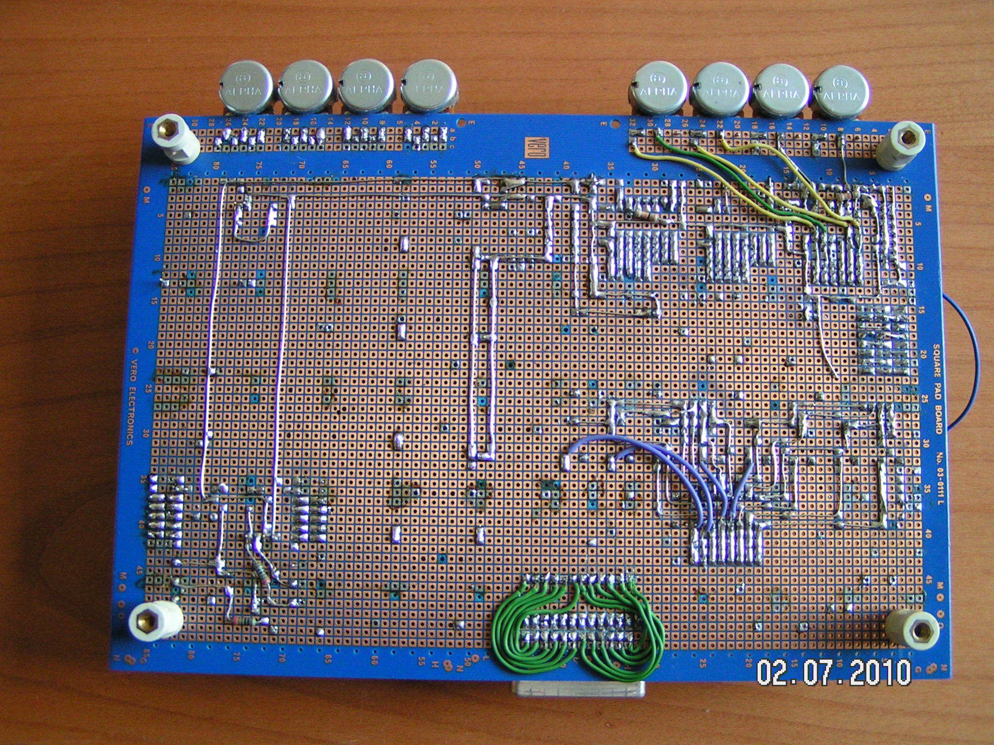

Quik'n'Dirty demo of Melody Generator and miscellaneous Lunetta elements.
Edit: hrmpff, I should have turned up those crappy speakers some more. Sorry...

PostPosted: Thu Jul 01, 2010 2:32 am    Post subject: Reply with quote  Mark this post and the followings unread
Nice! I love seeing your videos, the board looks really nice and clean. Good nice range of sounds too. Ive noticed that using different gates, XOR is really nice, can make your sounds a lot more interesting.
Could you take a shot of the underside of this blue beast? Im really curious as to how the different connections are made.

PostPosted: Fri Jul 02, 2010 7:31 am    Post subject:
Subject description: electri-fire Lunetta solderside
ok.

electri-fire wrote:
ok.
thanks! Again, amazingly neat and tight. I especially like the seperate pots, trimpots are nice, but real ones just feel so much nicer. For me as a visual kind of person this says more than a thousand words thumb up .

No. It needs a clock in for the the 47017, and up to 3 (ABC) inputs to select one of the eight options from the 4017 into the 4051. One output is taken from the 4017. More can be added, but those are the basic in/outputs.
