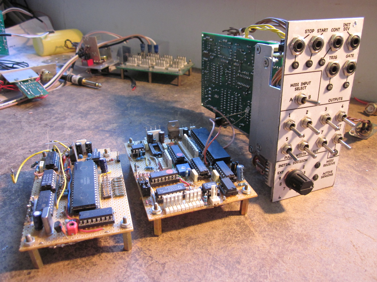

Top one show how cramped the module is in euro....
The bottom one shows the MK1 and MK2 prototypes on perfboard.

Bit of a long post, but I'll try to explain how the M2C works. It may seem complicated, but when you actually use it, it's dead simple.
Diablojoy - I guess if a PCB run happens, the schematics will be released at the end of the first run, along with a BOM and build/user notes. I'm working on the latter at the moment, though it will take a while due to work pressure.
Tommi - Yes, the two stages divide down from the initial 24PPQN that MIDI clocks arrive in. The initial division divides this down into a more usable number. Let's say it's set to divide by 3. That then gives you 8 PPQN, or 32 beats in a 4-beat bar. With the INIT DIV toggle on, that is what would come out of the GATE and TRIGGER jacks. (The trigger is just a narrow pulse, the gate is variable length)
The second divider stage sets the division *and* pulse width from the GATE out jack, and is controlled by the toggles. It is indeed a gate sequencer, although I originally thought of it as an 8-input OR gate.
For setting pulse widths and divisions, lets set the INITIAL DIVISION to 3.
With Toggles 1,3,5 and 7 ON, you would get 16 beats to the bar from the GATE and TRIGGER out jacks. With 1 and 5 ON, you get 8 beats and so on.
With only toggle 1 ON, you get 4 beats to the bar. If toggle 2 is also ON, the pulse length doubles. With the first 7 toggles ON, you get 4 beats to the bar, but with a pulse length that is *nearly* the whole length of a beat. This is a function of the circuit design, but I think it is a good thing, as, if you trigger an envelope from the GATE out, the gate goes low quickly at the end of the beat, and the envelope is re-triggered at the start of the next beat.
With the INITIAL DIVISION set to divide by 6, you get the same behaviour as above, but the maximum number of beats is now 16, and at the slowest setting (only toggle 1 ON) you get just 2 beats to the bar in 4/4.
If the INITIAL DIVISION is set to divide by 4 or 8, you get a 3/4 meter.
You can have a lot of fun by setting random patterns of the toggles - you get odd rhythms with pulses of different lengths. These can be switched ON and OFF while the thing is running, and it won't affect the sync. Switching the initial division while the sequencer is running gives much more unpredictable results. The other odd numbered divisions in the initial divider (divide by 5, 7 etc.) are there just for fun - a simple build could just have divide by 3 or 4.

The EXT position on the rotary was a position left for expansion, where the INITIAL DIVISION could also be gate selected. I have some ideas on how to achieve this, it wouldn't be too hard. A possible expansion board could combine a 2nd gate controlled secondary stage, possibly a gate controlled initial stage, and DIN SYNC, which should be easy enough to implement.
Finally, Tommi, you're right again - the MIDI input select switches between two physical MIDI inputs. I always try and run MIDI clocks, and definitely MTC, on its own down a separate MIDI cable from NOTE and other information. MIDI protocol will allow MIDI clocks to be sent in the middle of *any* midi messages, including SYS-EX, so in practice, they can end up delaying other information like note-ons, particularly at faster tempi. There are lots of the little buggers flying around, and MIDI still runs at the same baud rate, so there is less room for notes etc. to be transmitted. I totally recommend using a separate cable for MIDI clocks. These days, multi output MIDI interfaces for computers are cheap enough, so dedicating one from the 8 for clocks, helps a lot to tighten things up. Hence, the select switch - I can either feed the M2C from the dedicated clock line, or another line if needed.

No schematic yet...but is there the possibility of adding a LAG control, so you can turn a know, and delay the CV pulse from the MIDI clock, maybe even move it earlier?
That'd be nice to sync a modular to a MIDI based system, and get notes to align tightly. Or better: make it CV controllable as well, so you can add groove to the beat by adding a gated S&H LFO to the input?

Hi guys.
Thanks for the interest . I guess I'll have to make a demo video then....... Smile
Am currently refurbishing the modular, so it'll have to be cobbled together for the demo. Work is frantic at the moment , so it might be a few days before it happens.
As far as Lag and CV control go, I haven't thought about that so far.
You've got access to the raw clocks via pin-headers on the board, so delaying them is easy. Moving them *forward* in time is also possible, by delaying the first beat to *just before* it would happen at the second beat.
I'm hoping the video will make things a bit clearer.....
