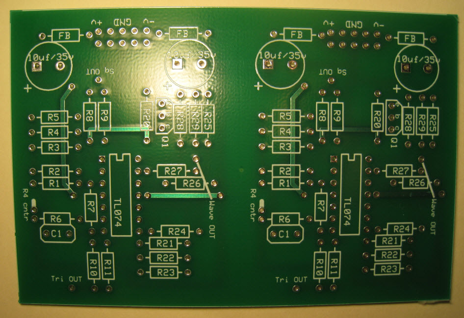

PostPosted: Mon Aug 29, 2011 4:18 pm    Post subject: Reply with quote  Mark this post and the followings unread
I received my MiniBoard Pro order from ExpressPCB today... can't say enough nice things about them. Here's a picture of the component side of one of their boards complete with solder mask, component screens, the works. Were I to cut the boards in half, the laid in cost from them for this level of service came to about $14/module including shipping. I didn't make any allowances on the boards for mounting so will probably use Thomas Henry's method of glued angles (courtesy of his "Build a synth" DVD, thank you TH!) BTW, the price could have been around $10 per module by ordering the PCBs without solder masks or screens. It's a great deal either way if you ask me.

Tim Servo
Joined: Jul 16, 2006
Posts: 924
Location: Silicon Valley
PostPosted: Mon Aug 29, 2011 7:08 pm    Post subject: The LFX experimental LFO (8K LFO and Weird Waveshapers) Reply with quote  Mark this post and the followings unread
Hey Marv,
Looks nice! A couple of thoughts on PCBs (these are just some things I do on my own / Magic Smoke PCBs)
1) Include the board name, and a date or revision number so you know what the board is and what schemo you used for it.
2) On the part designators (R1, U3, etc.), I always try to move them off to one side so that they're still visible when the part is in place. Makes troubleshooting or modding quicker and easier. You can't always do this on really cramped boards, but one most of mine I've been able to do it.
3) If possible, try to keep all similar parts pointing in the same direction. In other words, all ICs should point the same direction. I also try to keep all resistors in the same orientation. It generally makes assembly easier and makes the board look cleaner. This is a must for boards that are going to be automated, although that's something I've never had to worry about (although I do have a project coming up ...)
4) Whenever possible, traces on one side of the board should be at a right angle to traces on the other side. This minimizes interference, and even though that's not going to be a problem on an LFO board, it is a good habbit to get into.
For layout software, I've had really good luck with KiCAD (and it's free / open source).
Let us know how the LFX boards work out!
Tim (has plenty of bad habbits too) Servo
marvkaye
Joined: Mar 14, 2011
Posts: 225
Location: Fla
PostPosted: Mon Aug 29, 2011 7:45 pm    Post subject: Reply with quote  Mark this post and the followings unread
HI Tim,
Thanks for all the great pointers. If I ever manage to actually come up with my own PCB design I'll try to keep them in mind. It was actually bubzy who did all the heavy lifting with this one, I just made a few very minor changes and sent ExpressPCB money Rolling Eyes
I'll probably cut small stencils for them and airbrush the name of the board and revision down the center... I figured I'd keep them together and layout a MOTM style front panel that accommodates the pair.
Did you ever come up with the LED driver for this? MFOS Ray has a simple one that takes a couple resistors and a 2n3904 (on his Synth DIY page under the "Hot tips" menu item) but I don't know if it's appropriate to this application or even where it would tie into the circuit. Just curious....
<marv>
Tim Servo
Posts: 924
PostPosted: Mon Aug 29, 2011 10:07 pm    Post subject: The LFX experimental LFO (8K LFO and Weird Waveshapers) Reply with quote  Mark this post and the followings unread
Hi Marv,
For marking the boards, you might want to also consider a fine-tip permanent marker, or even a paint marker (don't know if those come in a fine tip).
As far as an LED driver, the transistor driver on Ray's site is an excellent, and very simple solution. I have some slight enhancements on that, but that original design is the simplest. You can hook it up to any of the waveform outputs - the buffer will pull very little current from the output, so the output can still drive lots of mod inputs.
Tim (the original, and the simplest) Servo

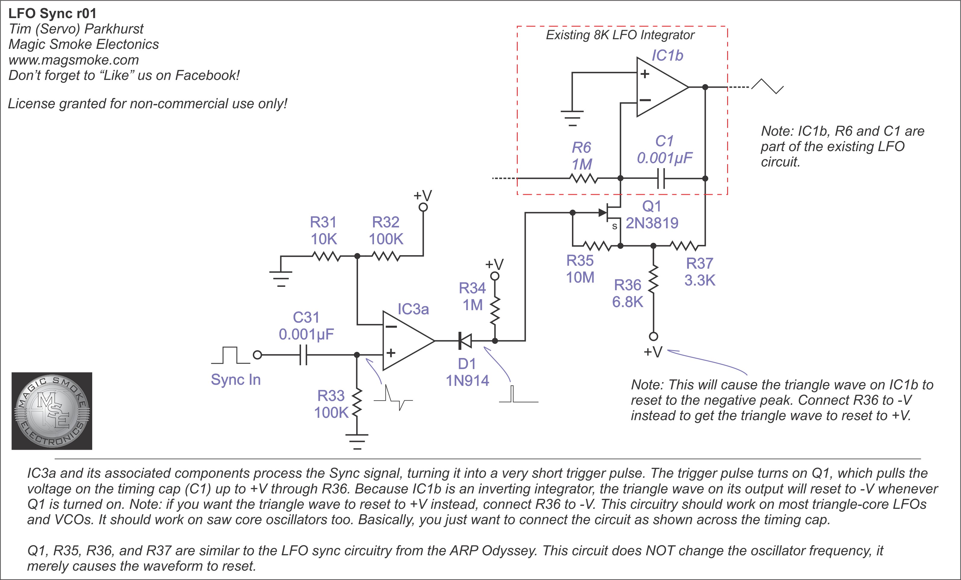

Tim Servo
Posts: 924
PostPosted: Tue Jul 23, 2013 5:27 pm    Post subject: The LFX experimental LFO (8K LFO and Weird Waveshapers) Reply with quote  Mark this post and the followings unread
Hi Oc,
Yes, it's pretty easy to set up sync on this (or most other) LFOs by using an FET or an analog switch to change the charge on the timing cap. You can set up the circuit to pull the cap up to V+ or down to V-. In most triangle core oscillators, the integrator is inverting, so this means that pulling the timing cap up to V+ means the output triangle will be reset to V-. By the same token, pulling the cap down to V- means that the output wave will reset to its positive peak. It just depends on what behavior you prefer (or you could even put in a switch). The circuit below has already been posted on the Magic Smoke Facebook page (that's the place to go if you want to see this stuff a little sooner).
Tim (peaky!) Servo
Sync Circuit for the Magic Smoke 8K LFO - works with most other LFOs too.
 Filesize:  671.91 KB
 Viewed:  960 Time(s)

PostPosted: Wed Jul 24, 2013 7:27 pm    Post subject: Reply with quote  Mark this post and the followings unread
Tim is there a reason for not pulling the intergrator cap to 0V ?
instead of the negative or positive rail
resetting the wave to 0V seems more intuitive to me

Tim Servo
Posts: 924
PostPosted: Wed Jul 24, 2013 10:29 pm    Post subject: The LFX experimental LFO (8K LFO and Weird Waveshapers)
Subject description: A question of resets...
Hey DJ,
In this design, you can reset the cap to 0V by connecting the 6.8K resistor to 0V. However, if you pull the cap to 0V, the output won't consistently reset. If the LFO wave was on the down slope, a reset to 0V will make the output start at 0V and head negative. On the other hand, if the LFO wave was on an upward slope, the reset will set the output to 0 and the it will start up. Resetting the LFO wave to the negative (or positive) peak means that the output behaves exactly the same way on every reset, regardless of where the LFO wave was when the sync pulse hits.
Tim (resetting it to 0K?) Servo

PostPosted: Thu Jul 25, 2013 3:29 pm    Post subject: Reply with quote  Mark this post and the followings unread
Thanks Tim
makes perfect sense.
I seem to remember seeing something along similar lines on the time machine schematic using a DG chip for resetting the LFO /EG to a known point and forcing a particular direction, would have to look it up again though to be sure.

bubzy
Joined: Oct 27, 2010
Posts: 594
Location: United Kingdom
Audio files: 64
PostPosted: Fri Jul 26, 2013 6:21 am    Post subject: Reply with quote  Mark this post and the followings unread
haven't made a pcb for some time, so this might not work, I haven't tested it (or done a huge amount of error checking :p)
this is the original board, but with the sync section added.
hope it works, let me know if it doesn't and ill fix it.
