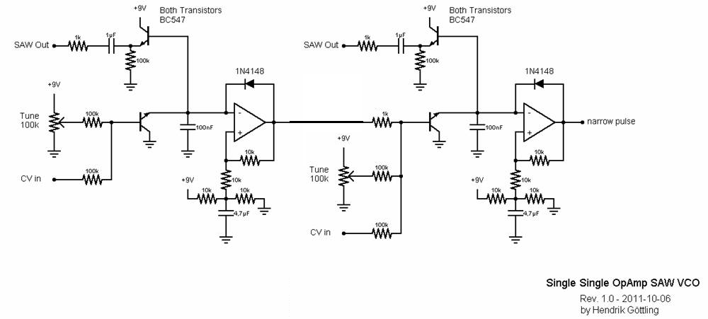

Hey folks!!!
I thought it's time to give something back to the community. Inspired by a thread from nicolas3141 - which can be found here: http://www.electro-music.com/forum/topic-38087.html - I wanted to build a very simple VCO. This is what I came up with.
This little circuit uses one single Op Amp to generate a saw wave at the capacitor which is then buffered through a transistor. At the output of the op amp there is a very narrow pulse.
Frequency range is pretty huge and if my ears aren't wrong this thing has exponential pitch response. So with an expo converter it should be possible to get this thing to 1V/Oct. I haven't tried that yet.
This circuit works on a single supply - in this case on a 9V battery but it should work on almost any voltage. If you want to use a dual supply, simply exchange the lower voltage divider with a connection to ground.
The op amp is 1/2 of a TL062 but almost any op amp should work.
I'm currently working on a simple single op amp LFO for this little thing.
I'll post it as soon as it's finished. Also I'm thinking about a Saw to Tri converter to get some more waveforms from this circuit.
Oh, by the way - the output of the SAW is roughly 1/2 V-supply.
Have fun experimenting!!! Tell me what you think!!!
Hendrik
[EDIT] The cap on the inverting input should be 10nF - but 100nF will also work...

Hi Hendrik - that looks pretty neat!
I'm a little unclear on the circuit though. What is the function of the diode in the feedback path of the opamp?
Thanks
Gary
metal_head_82
Joined: Dec 27, 2009
Posts: 34
PostPosted: Wed Oct 12, 2011 1:32 am    Post subject: Reply with quote  Mark this post and the followings unread
Hey Gary,
the Diode sets the charge time of the cap to zero and therefore generating the sawtooth.
The discharge time of the cap is then determined by by Rce of the transistor which changes with the voltage present at its base.
You could exchange the CV-input section including the transistor with a pot connected to ground. Altering the pot would have the same effect on the pitch.
Basically this in an op amp version of a schmitt trigger oscillator.
Hope this helped a little...
Hendrik

Hey. Is it me, or shouldn't the CV transistor have emitter and collector swapped ? Or does this resistance thing work also with collector at a lower voltage than emitter ? Just asking, I'm pretty ignorant.
(ok I should just try it myself)

PostPosted: Mon Jan 02, 2012 6:31 pm    Post subject: Reply with quote  Mark this post and the followings unread
It is me. Both work actually.
Could the pulse be used as means of synchronization, as simply as this ?
suggestion !

PostPosted: Wed Jan 04, 2012 4:40 am    Post subject: Reply with quote  Mark this post and the followings unread
Yes, it can!
BUT you are using it as some sort of FM.
If you want hardsync you should connect the pulse-out of the first vco via a diode and a switch to the diode at the opamp's output of the second VCO.
(Hope this is clear enough - else I'll try to put a schematic online)
I've done this in the vco I'm currently working on. It's based on this design and has FM and hardsync. It's working pretty well BUT the expo converter gives me a headache.
Hope I could help you.

PostPosted: Wed Jan 04, 2012 6:22 am    Post subject: Reply with quote  Mark this post and the followings unread
Sync - in this case hardsync - means that one osc restarts the cycle of another osc everytime its own cycle restarts. In this case that means that you need to set the output to high level and let the cap discharge - thus forming a saw.
But you could also discharge the cap. But the way you did it you simply set the CV with every pulse to the highest possible value => FM Wink
But this sort of FM could sound very interesting - I would like to hear a sample of that Smile
Keep up that great work and - in the words of Ray Wilson - stay ingenious!

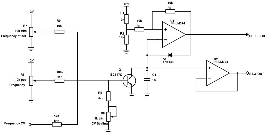

pretty new to electronics and still a freshman on this board...
I recently built -on breadboard so far - the version also referred to in this thread, around the 40106. then I got curious and also tried this circuit using 1/4 LM324. it differs from the schematic that I used 2n3904s (to have the same as in the 40106 circuit) and instead of the 100nf cap, which I tried, I went with a 470nF which gave me a more satisfying frequency range.
as i had them both sitting readily before me I thought it might be a good idea, and maybe of interest to some others here, to do an A/B comparison recording:
40106 version:
http://soundcloud.com/ivorybunker/vco-40106-saw-21092012
http://soundcloud.com/ivorybunker/vco-40106-pulse-21092012
LM324 version: (this uses a 470nF cap instead of the 100nF in the schem)
http://soundcloud.com/ivorybunker/vco-lm324-saw-21092012
http://soundcloud.com/ivorybunker/vco-lm324-pulse-21092012
from breadboard into the soundcard. mono, no editing or anything, except cutting the respective parts into single files... I did a sweep over the full range a 100k pot gave me (and some little extra turns towards the end on most files.)
there is some more info (including some illuminating remarks by maestro jingle joe) in this thread: http://electro-music.com/forum/post-370151.html

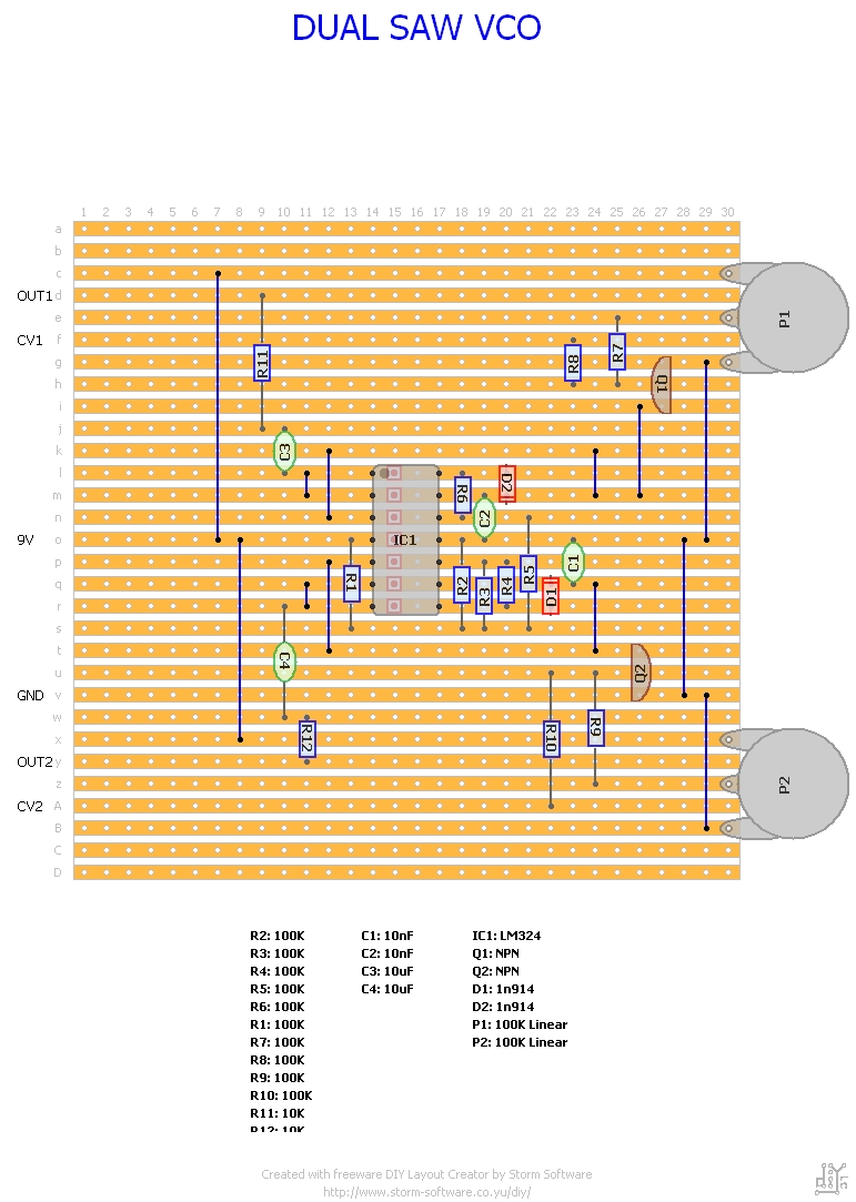

I made a somewhat crude stripboard layout for a dual version of this using an LM324. I took out the transistor buffer and replaced it with an op amp voltage follower using the spare op-amps in the LM324. All resistors are 100K except R11 and R12.
Note that I forgot to add the bypass cap across the bias voltage, but that's and easy fix.
Has anybody worked out a way to get it to do 1V/Oct yet?
EDIT: I finished building it using my layout today and can confirm it works!

PostPosted: Fri Apr 17, 2015 5:16 am    Post subject: Exponential CV input Reply with quote  Mark this post and the followings unread
Hi all,
It's an old topic, but I thought I could add something anyway. I played around with this circuit, and I like it very much for its simplicity. Thank you for posting it! I have a few comments, and then I show the circuit how I built it so far.
1. Dual supply opamp: It's actually not so easy to use a dual supply opamp, and probably its not worth the trouble. To use dual supply, the transistor and the CV input should be referenced to the negative supply in stead of ground (the oscillation will be between +V/2 and -V/2, so you have to discharge to something more negative).
2. Linear vs exponential CV. The circuit can do both, or something in between! In the original post, it was mostly linear for audio frequencies. The reason is, that the transistor was used as a current amplilfier. The 100k transistor in the CV input path converts the CV to a current, and the transistor multiplies it by it's beta.
The alternative is to use the transistor as a voltage driven device. If you supply a voltage Vbe at the base (w.r.t. the emitter, which is ground), the transistor will allow an exponential Is current to flow into the collector,
Ic = Is exp(Vbe/Vth)
where Is is a device parameter and Vth is the 'thermal voltage', 25mV at room temperature. It is quite sensitive though, Vbe should be very close to the threshold (0.7V or so), and especially it is very temperature sensitive (hence the name thermal voltage).
I built it up as follows with roughly exponential CV. R9, R10 and R11 form a voltage divider with R5+R6 to set Vbe. R6 adjusts the scaling, and you can get roughly 1V/octave with a bit of twiddling around. R7 sets the lower frequency, so you can tune it roughly to the audio range, and then R8 gives good frequency adjustment range.
The CV tracking is not perfect, you always have some error either at higher or at lower octaves, but for 2-3 octaves this is reasonable. I think at high frequencies it still operates a bit in current-controlled regime, so probably one can improve for example by buffering the CV voltage.
Version with approximately 1V/octave CV input
 Filesize:  47.08 KB
 Viewed:  2398 Time(s)
