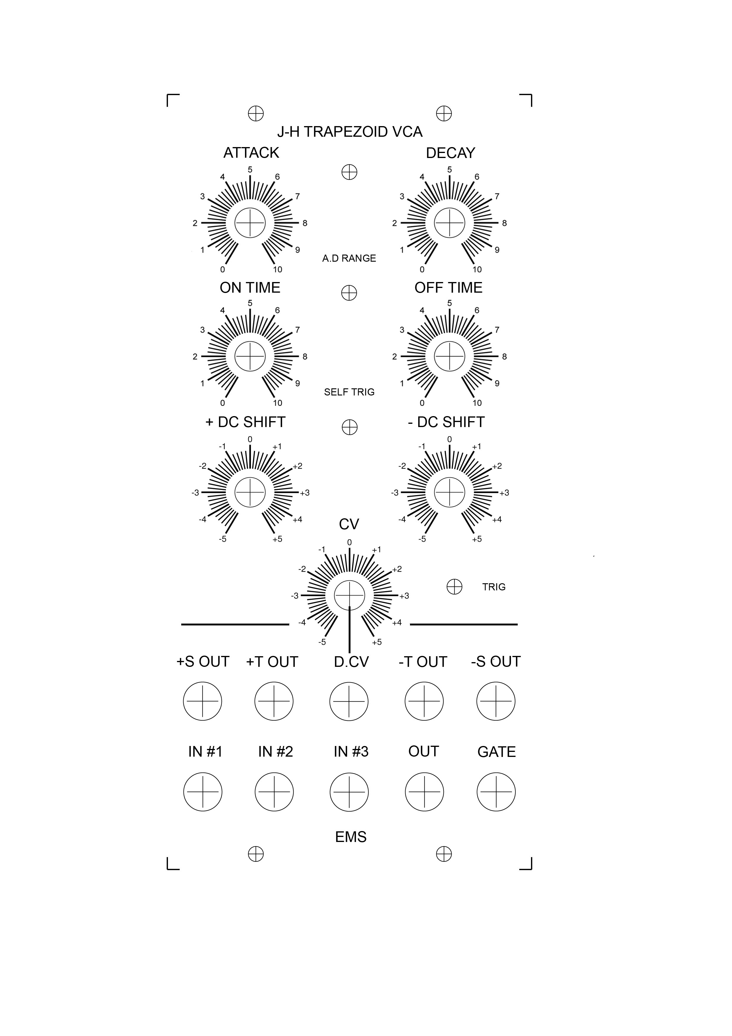

zarko wrote:
Hi Jurgen, i made a new front panel with the attenuator pot,would you tell
me what do you think about Wink
Looks great.
And you could still improove it by making it a reversible attenuator, i. e. zero at 12 o'clock position, and increasing Decay time on cw end (with a positive CV), decreasing decay time on ccw end.
Also, the DC shift potentiometers have no effect in 12 o'clock position. Turning them cw will add a positive DC shift, and turning them ccw will add a nagative DC shift. This refers to both pots: The "+" and "-" means the normal and the inverted output. You can DC-shift them both in both directions.
JH.

PostPosted: Fri Nov 26, 2010 2:56 pm    Post subject: Reply with quote  Mark this post and the followings unread
Thanks Jurgen i think now that we have the right final panel.
Let me know if i have to modify other ting Wink

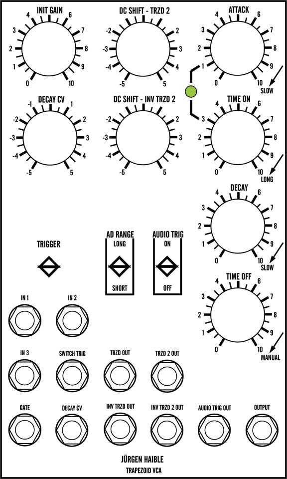

PostPosted: Tue Dec 07, 2010 2:28 am    Post subject: Reply with quote  Mark this post and the followings unread
MR-808 wrote:
janvanvolt wrote:
Anybody got an idea for the frontpanel (5U?)
My partner in synth-building is working on one. I hope to have something worth showing soon!
Too many irons in the fire! We finally put together something we both like. It doesn't conform to the usual MOTM conventions, which will probably tick some people off. Wink My collaborator convinced me that it would be better to put the inputs on the left and the outputs on the right.
I still have a little bit of tweaking to do on the horizontal spacing, but it's very close to what we'll screenprint.

PostPosted: Tue Dec 07, 2010 5:39 pm    Post subject: Reply with quote  Mark this post and the followings unread
MR-808 wrote:
MR-808 wrote:
I really like the panel design for your dual trapezoid. Great work!

wjhall
Joined: Dec 09, 2010
Location: NJ-USA
PostPosted: Thu Dec 09, 2010 7:47 pm    Post subject: 5U JH Trapeziod VCA panel designs
Subject description: a few design ideas from Bill and Will
Hi guys -
Will found this thread and thought perhaps we might offer his panel ideas. He did this graphic design, as we usually do, to illustrate the feature set before the panel actually get laid out in FPD or by Scott Deyo or whoever... I think he's got a good handle on the feature set.
This first of his 3 designs includes all of the features represented on Jurgen's schematic diagram. It needs a 3U wide panel. He did another two - one with attenuators for the 3 audio inputs (also 3U wide), and another with just the Trapezoid Generator portion of the features (2U wide).
Please let us know what you think.
Thanks,
Bill and Will
