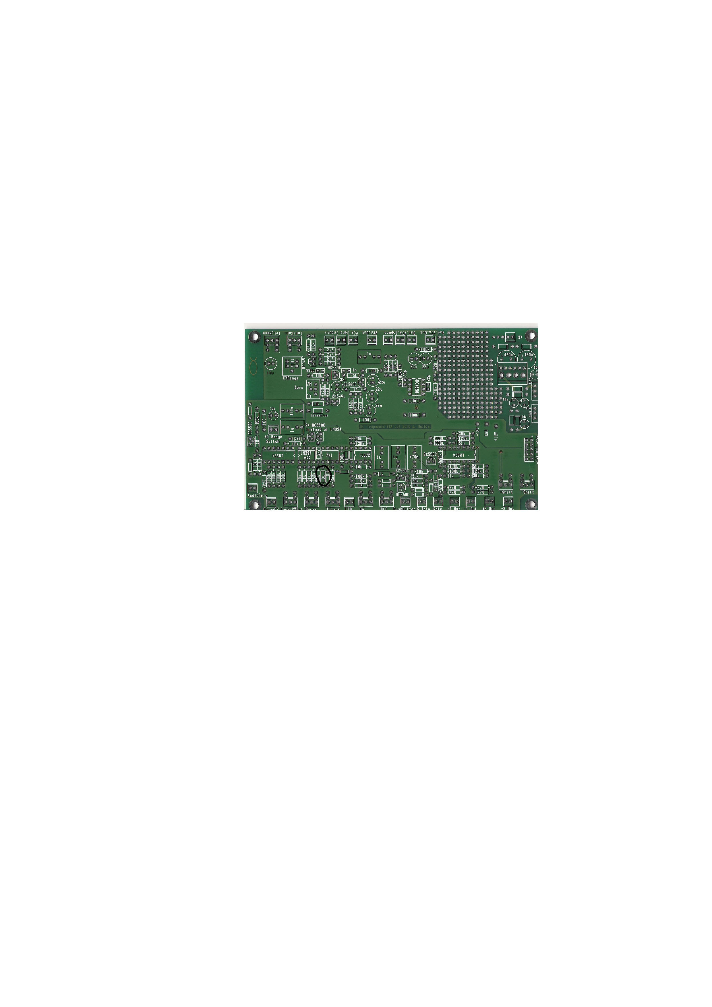

PostPosted: Mon Dec 06, 2010 10:06 am    Post subject: Reply with quote  Mark this post and the followings unread
Hi
I think that the right value is 3K on the PCB

PostPosted: Mon Dec 06, 2010 10:20 am    Post subject: Reply with quote  Mark this post and the followings unread
zarko wrote:
Hi
Yeah, I saw that on the web site image too, but my board has 2K4 there, as well as the schematic. JH?

PostPosted: Mon Dec 06, 2010 1:18 pm    Post subject: Reply with quote  Mark this post and the followings unread
numbertalk wrote:
zarko wrote:
Hi
2k4 is right.
It was a last minute change. 3k will also work, sort of; but 2k4 will work better in combination with extreme Decay CV settings.
JH.
