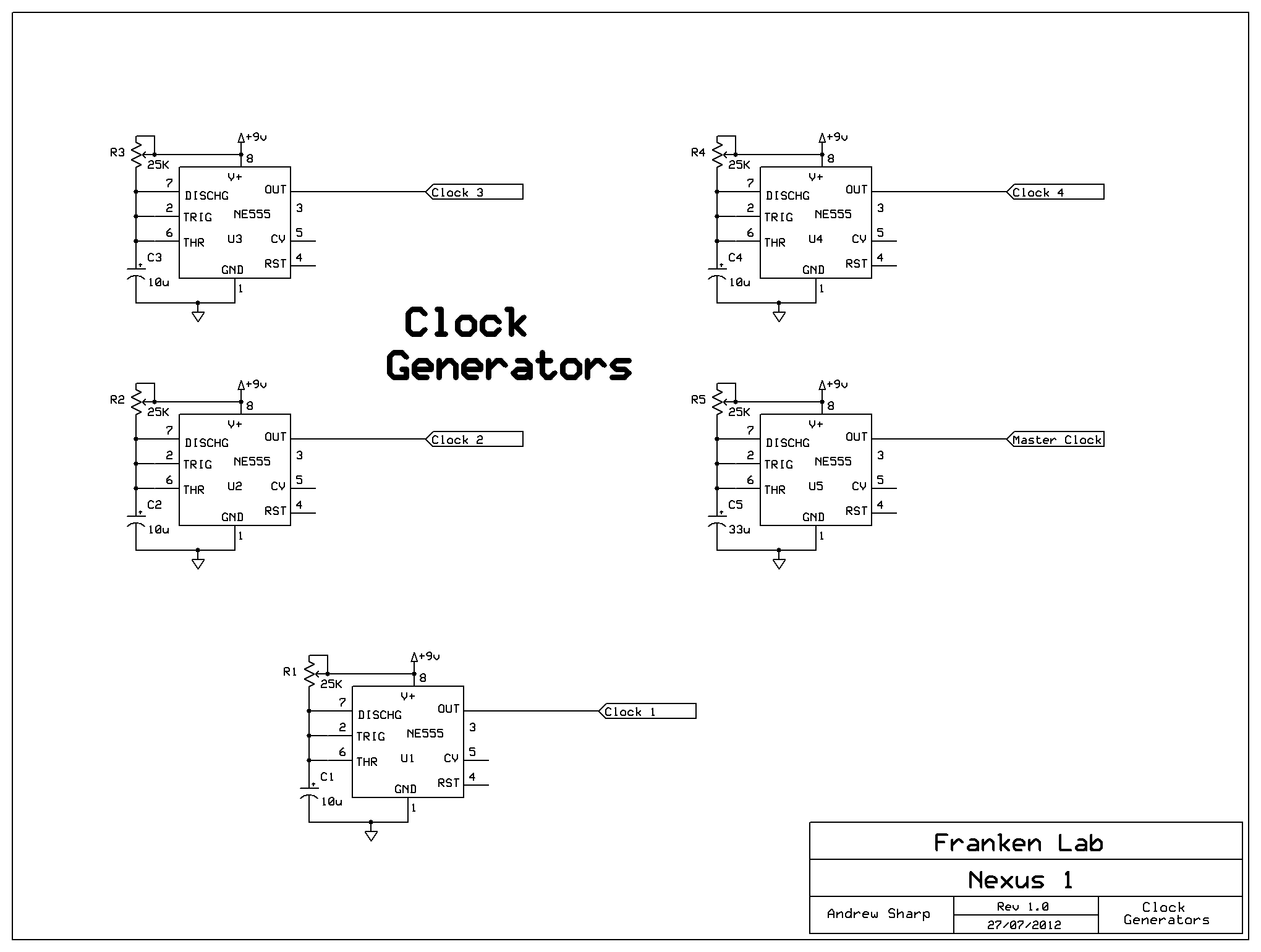

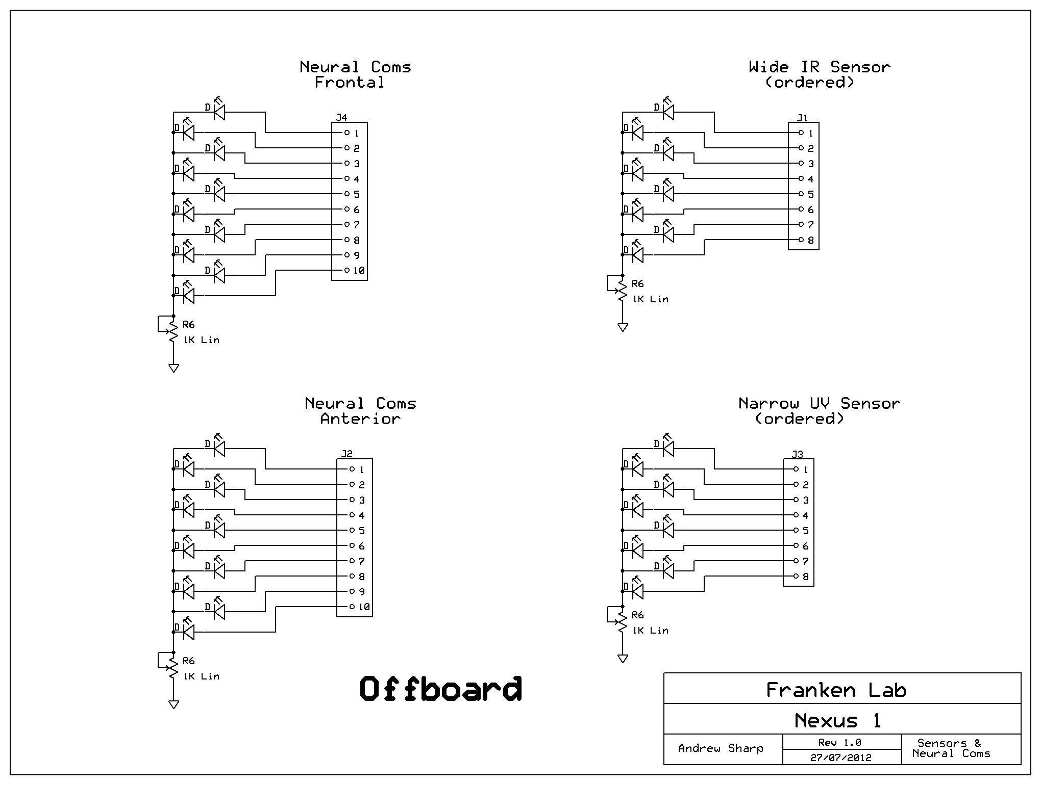

Okay,
These three schemes show what I already have to work with.
It's all laid out on piece of stripboard, (which I'll take a pic of later).
I designed and laid it out around 1995. No software to design or test on then. I actually find it amazing that it worked quite well. Straight off the bat.
Even relative newcomers to SDIY should be able to see quite a few alarming errors on this schem. But it would be good if we can find them all, don't ya reckon? It's transcribed exactly as the stripboard is already built. And it works,....kinda,... But if I fix the errors on the board as we find them, then it will end up heaps better. I'm already quite certain I can cut the current draw by 100:1! Laughing
It is not yet a Lunetta (technically) as it doesn't make a sound. Not yet. Twisted Evil
Half the stripboard is empty.
The challenge is to find a way to make this "Light Show" into something more real, by giving it a voice.
I've already installed a piezo on the sculpture to "see" how it "sounds".[/b]
Link to newest stripboard and schems is here : - http://electro-music.com/forum/topic-54532-25.html

PostPosted: Sat Jul 28, 2012 6:30 am    Post subject: Reply with quote  Mark this post and the followings unread
It might be a good idea to make a list of errors you've already noticed.
The one I spotted first is those 555 timers, they need a limiting resistor on pin 7 or the discharge transistor will fry itself and if you want to keep the duty cycle roughly square, put the pot between pin 6 and 7, (threshold and discharge respectively) you can charge/discharge the capacitor from the output too by putting the variable resistor between pin 6 and the output.
Similar sort of thing on the master 4017, a bunch of those outputs are tied to ground, now i notice it resets before it gets to them but if that line were to be broken it would count down to it's own demise, so it's best to leave them unconnected.
I don't want to be a total misery guts so I'll say that I think it looks like it has potential too Smile You could run those clocks at or above audio frequency and combine the outputs from the 4017s via gates to get interesting beeps.
PostPosted: Sat Jul 28, 2012 8:03 am    Post subject: Reply with quote  Mark this post and the followings unread
Yeah, thought of doing a complete duty cycle control, but these sequencers need to run slow (for the light show) so I have to run my oscillators off the Led outputs. Because of that, it doesn't matter if these 555s put out just a spike. They're just to kick the sequencers over at sub audio rates.
Yeah, I was gonna pull them down with a 20K, but unconnected is good.
That's where I'm thinking of hanging some of those starved oscillators. Off the Led outputs maybe through an R/2R if going back to the 555 CV ins. But otherwise you could just have a few diode-ORs into the base of a 2N3904 and hang a 40106 osc off the other side.
Get what I mean?
Also, the Leds should maybe have their own current limiters?
Depends what I end up hanging off them hey?

PostPosted: Sat Jul 28, 2012 5:12 pm    Post subject: Reply with quote  Mark this post and the followings unread
40106 to replace all your 555s?
you may also have to ground the clock enable of your master 4017

PostPosted: Sun Jul 29, 2012 3:11 am    Post subject: Reply with quote  Mark this post and the followings unread
Get what I mean?
Yes, that could work Smile
Also yes Smile (My rule of thumb: 1k resistors if the supply is above 5V, 470ohms for 5V and below)
If I were you I'd have rather used 4040's or some other binary counters in place of some of those 4017s, makes for more interesting patterns rather than the linear sequences provided by the 4017. Nevertheless, a little experimentation could have your contraption making the most marvelous sounds Smile

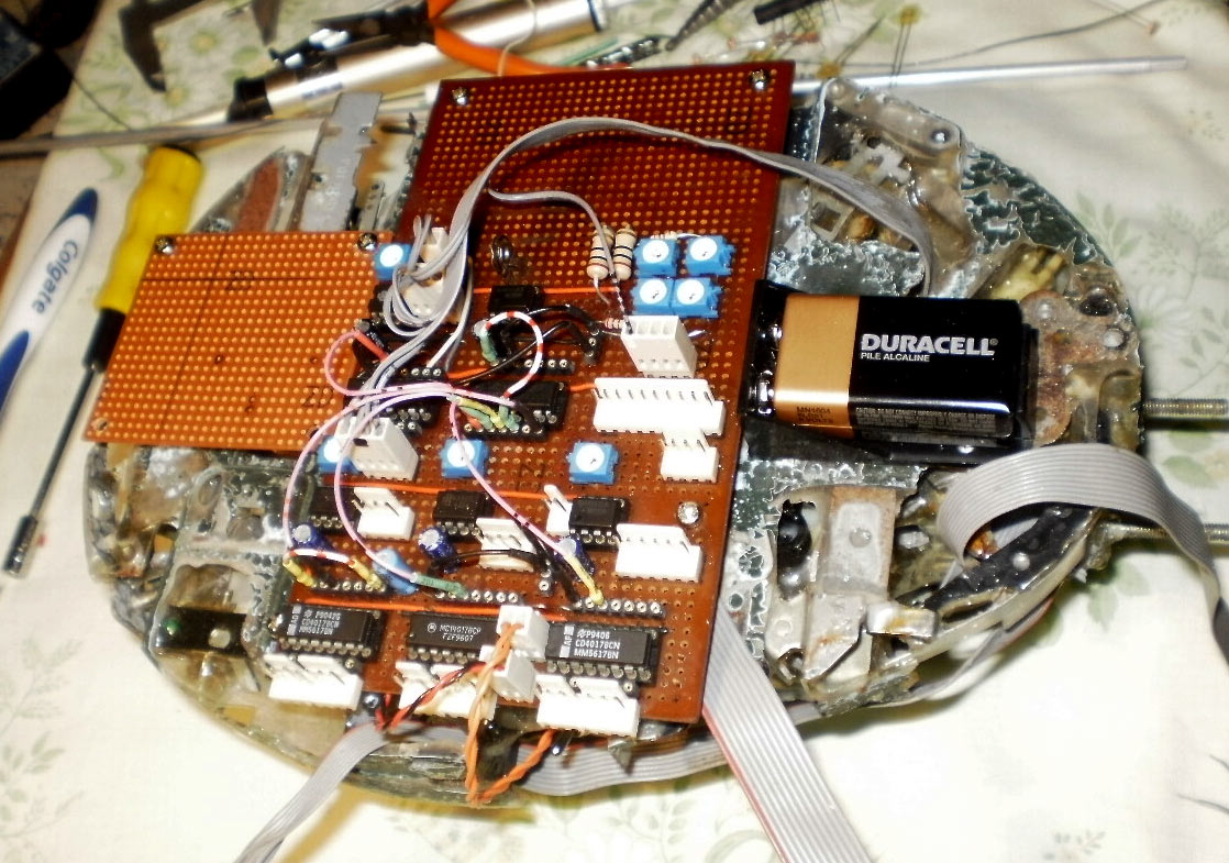

PostPosted: Mon Aug 06, 2012 5:42 am    Post subject: Reply with quote  Mark this post and the followings unread
Here's a pic of the board at this stage.
I can't believe how much I've done to it, just in this last week.
I've put a lot better ground return for the light chains (bottom right) with separate dimmers on each. (4-25mA)
I've replaced some other trimmers, and added connectors for the LEDs, and now I'm already into the fun process of lunettafying it. SIL strips everywhere, and I've learned how to make .6mm phono style patch cords to go into them! Cool Very Happy
Notice all the chip ins and outs are vertical, and the ground strips are always 3 pins wide and horizontal. Any +V strips will be only 2 pins wide with a red band of heatshrink around them. I reckon this could be a pretty good way to work it all out in 2130! Laughing

PostPosted: Mon Aug 06, 2012 6:30 am    Post subject: Reply with quote  Mark this post and the followings unread
Uncle Krunkus wrote:
"Well, at this stage, we're not quite sure. Back in 2087, when it was found half caked in mud near the Swiss desert, some so called experts believed it may just be a hoax.
It is now thought to be some kind of "head". Probably an early incarnation of the Nexus droids which we now rely on so slavishly.
We've ascertained that the middle "eye" is extremely sensitive to both infra-red and ultra-violet wavelengths. The transducer on the front is currently inoperable, but we plan to replace it.
Some older parts will have to be sourced from Silicon Mountain in Malaysia, as they are too old to be replaced with anything we've used since quintelligence."
Is that Philip K Dick? Laughing
The board is looking good so far Smile good thinking for the ground connections! it;s allways good to make a distinction like that.
PostPosted: Mon Aug 06, 2012 2:14 pm    Post subject: Reply with quote  Mark this post and the followings unread
No, it's not, but I can't pretend he didn't inspire the idea. Laughing
Yeah, these SIL strips are very handy things to work with. The patch cords are made with the machined pins from the same SIL strips as well. They're really robust and (hopefully) reliable once they're made up. It really shifts the construction back towards the asthetic beauty which I love working with.
So far, it looks like the empty space on the board will contain 4 * 40106 complex oscillators (my term for six tolerance varied oscillators stacked on the one starved chip), and I'm thinking a chipful of AND gates may be handy. Any other suggestions? 6 chips is about all I can fit, and I still need space for an R/2R to feedback to one of the sub sequencers.
