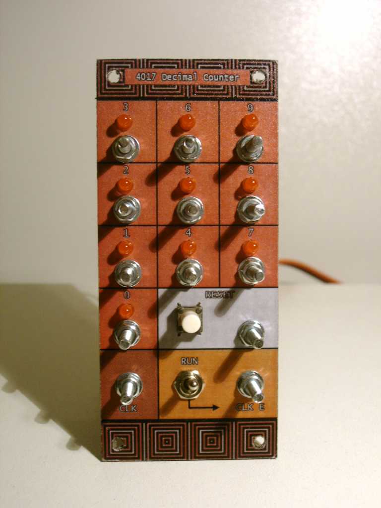

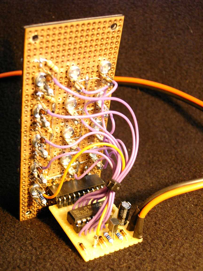

Subject description: [4017 DECIMAL COUNTER] Module
next:

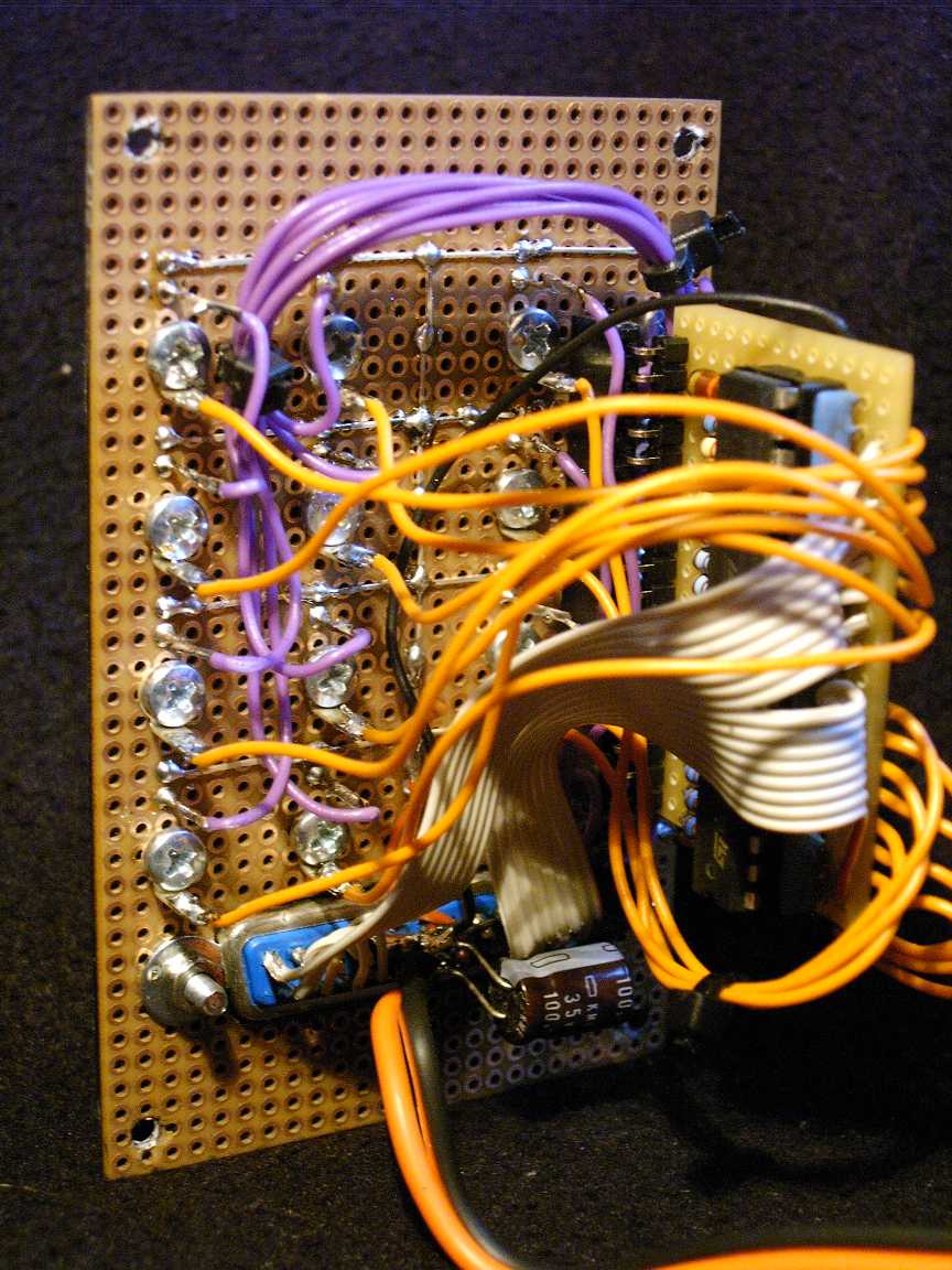

Don't think I need to mention anything about this one, except for using the CLK INH pin to hold/run the counter,
either with a switch or remotely.
 Filesize:  18.57 KB
 Viewed:  1363 Time(s)
 Filesize:  48.05 KB
 Viewed:  1205 Time(s)

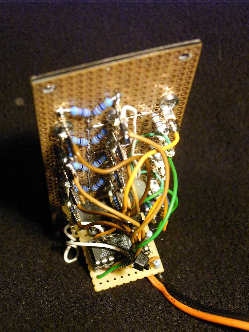

Posts: 5949
PostPosted: Sat Dec 08, 2012 6:39 pm    Post subject: PHOBoS' Modular Lunetta`

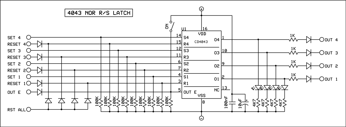

Subject description: [4043 NOR R/S LATCH] Module
and the last of the 3:
4043 NOR R/S LATCH
It's Alive!, ALIVE!
well ok it's not really alive (yet) but it can remember some bits now. I also added an extra input for a total memory
wipe, and a switch so it can sleep sleeping but still remember the bits when it wakes up.
 Filesize:  26.03 KB
 Viewed:  1300 Time(s)
 Filesize:  63.23 KB
 Viewed:  1166 Time(s)

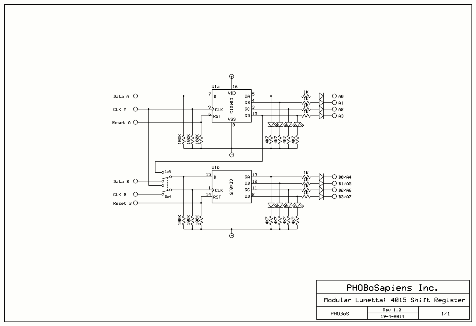

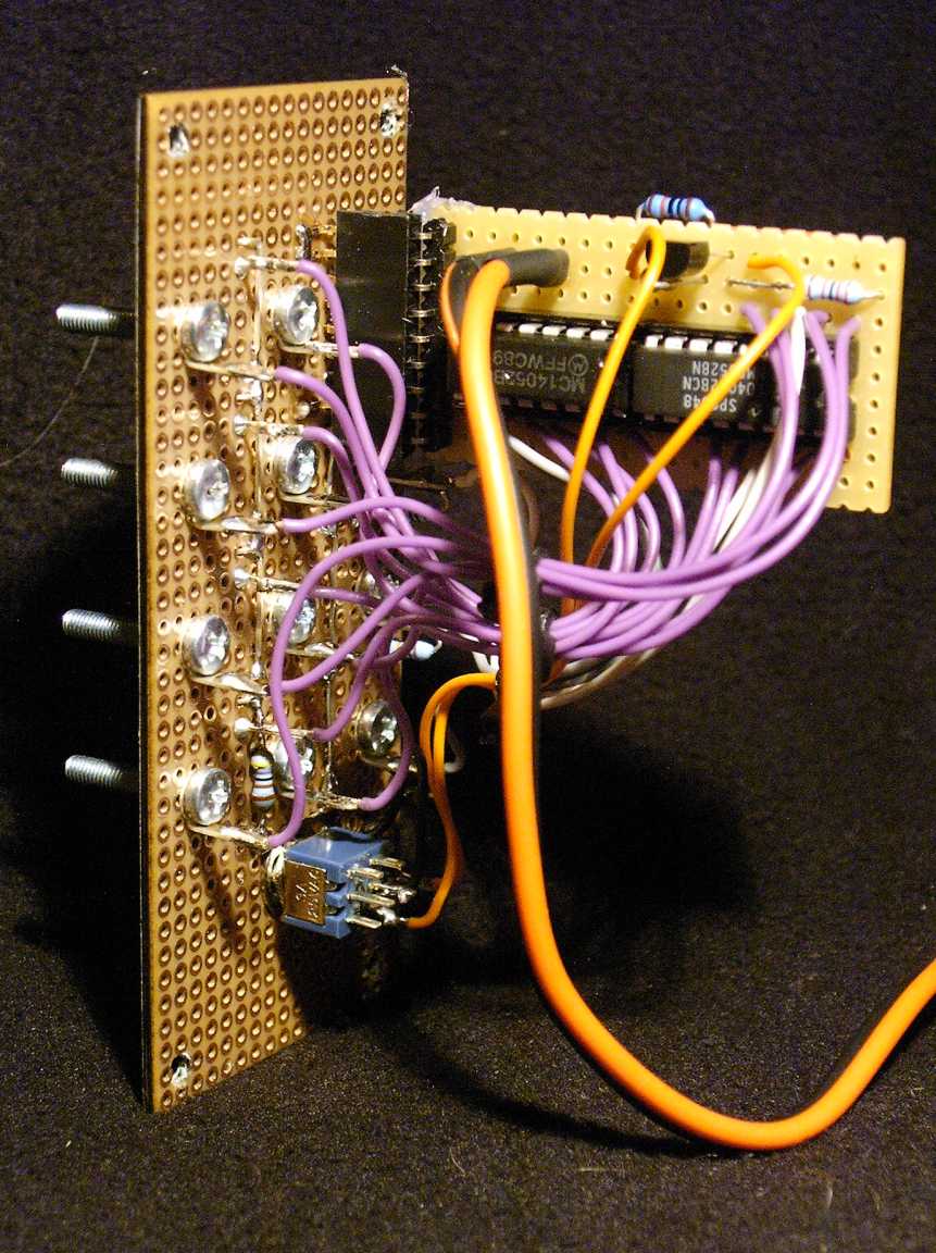

PostPosted: Sat Apr 19, 2014 6:03 pm    Post subject: 4015 Shift Register module Reply with quote  Mark this post and the followings unread
it's been a while but I added another module, nothing special but very useful:
a 4015 shiftregister with a switch to select between 2x4 or 1x8 Cool
Modular Lunetta 4015 Shift register schematic
 Filesize:  55.26 KB
 Viewed:  1218 Time(s)
Modular Lunetta - 4015 Shift Register module
 Filesize:  120.79 KB
 Viewed:  778 Time(s)
 Filesize:  116.36 KB
 Viewed:  776 Time(s)
 Filesize:  108.75 KB
 Viewed:  748 Time(s)
 Filesize:  78.89 KB
 Viewed:  793 Time(s)

PostPosted: Wed Apr 23, 2014 7:49 am    Post subject: Reply with quote  Mark this post and the followings unread
Nice! I have a 4015 as well as a 4094 in my big machine. Shift registers help mangle up the order of things and are simple to wire up. You really can't go wrong building a lunetta based on just a few oscillators, maybe a divider or 2, some shift registers and and r/2r to mix them up. The rest is just gravy Laughing !

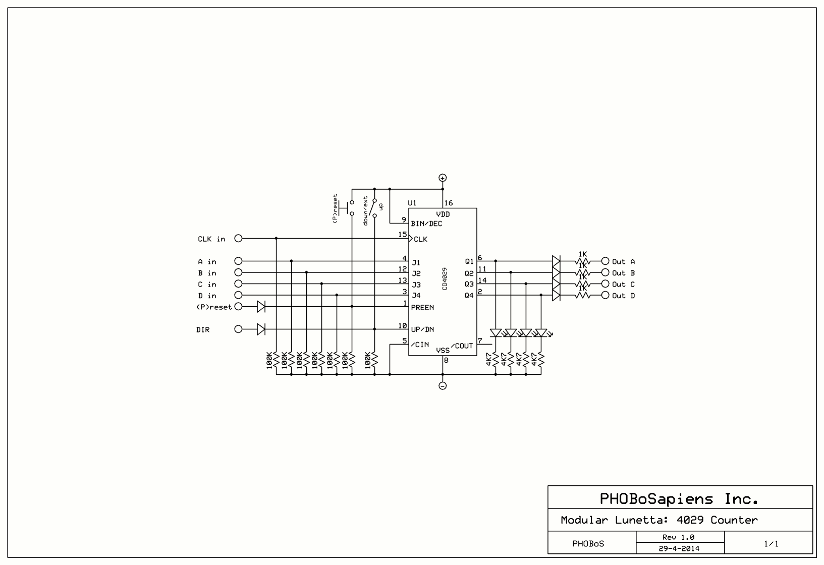

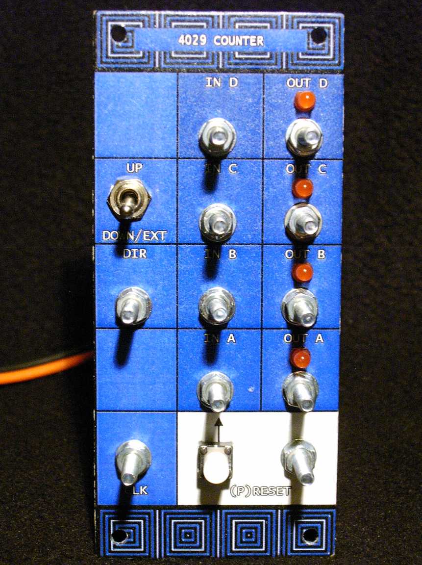

PostPosted: Fri May 02, 2014 3:21 pm    Post subject: Reply with quote  Mark this post and the followings unread

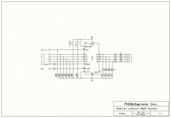

I would add some XOR's to that. But yeah with that alone you can already get a wide range of sounds Very Happy.
I wanted some more dividers/counters and was originally thinking of using a CD4520 dual 4-bit binary counter, but I went for a CD4029 instead. Besides
being able to count up and down it also has 4 preset inputs, which can be used as a digital 4-bit S&H. And with nothing connected to the inputs it works
as a reset. I just finished it (solder is stil hot Wink)
Modular Lunetta 4029 Counter schematic
 Filesize:  49.09 KB
 Viewed:  1014 Time(s)
Modular Lunetta - 4029 Counter module
 Filesize:  121.39 KB
 Viewed:  743 Time(s)
 Filesize:  95.64 KB
 Viewed:  741 Time(s)
 Filesize:  108.62 KB
 Viewed:  708 Time(s)

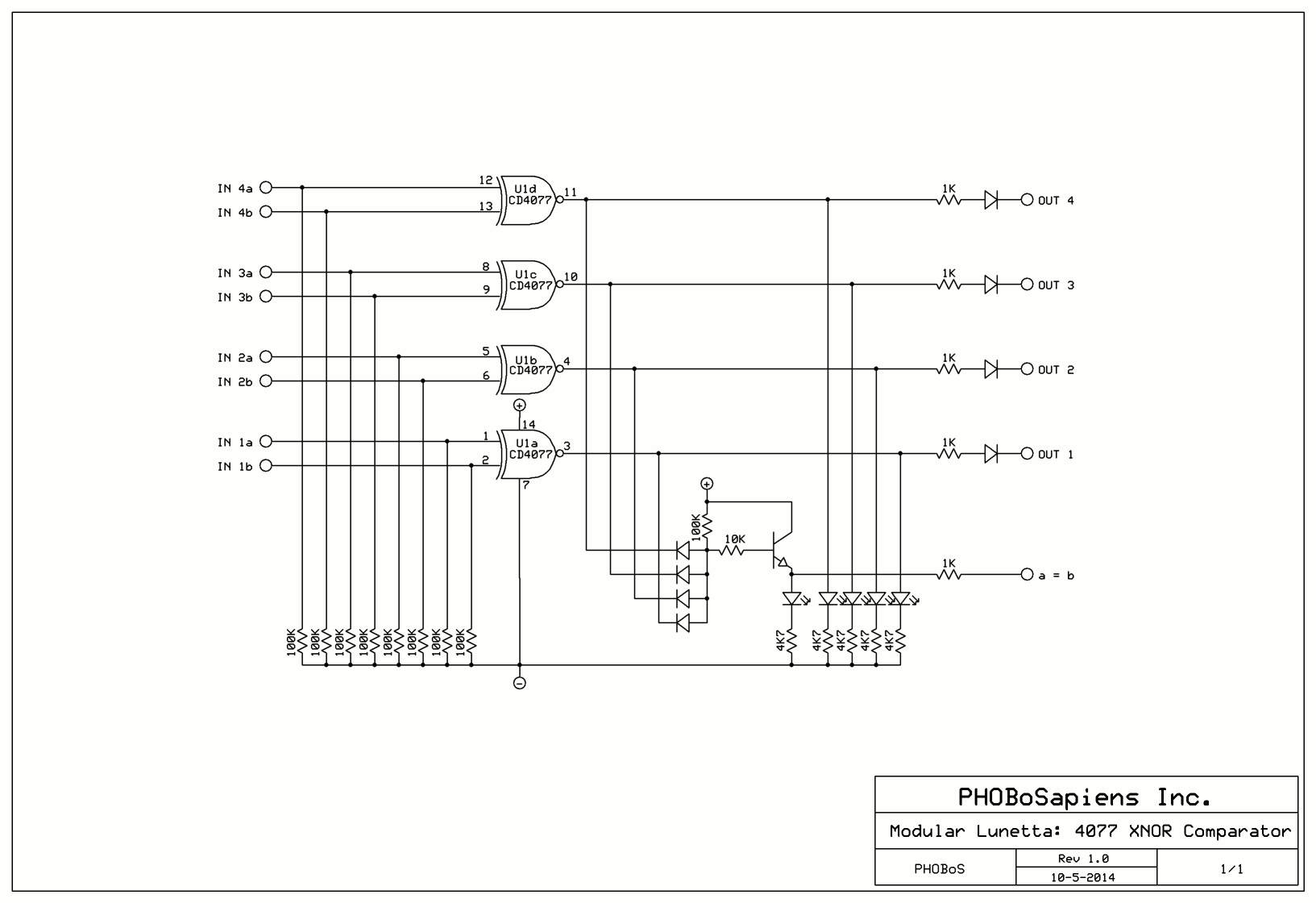

elektrouwe
Joined: May 27, 2012
Posts: 149
PostPosted: Sat May 03, 2014 4:39 am    Post subject: Reply with quote  Mark this post and the followings unread
...I would add some XOR's to that..... I went for a CD4029 instead
if you use a XNOR (4077) instead of the XOR(4077) and 4 diodes in wired-AND style you could probably us it as a logic comparator to generate a preset pulse. So you have 2 4bit inputs that define start & end value of the counter, right ? if this works, let us know. Smile
I use 4516 instead of 4029, because it has an extra reset pin.
have a nice solder weekend, u~
Posts: 5949
PostPosted: Sat May 03, 2014 5:50 am    Post subject: Reply with quote  Mark this post and the followings unread
scratch Shocked
yep I think that works. If you make two of those comparator circuits (I like them already) connected to a flipflop controlling the up/down pin you
should be able to make it bounce between 2 set points. I'll do some tests.
Wasn't familiar with that one, but just looked it up and it's actually a nicer version of the 4029. I don't really care for the DEC/BIN option and would
rather have a reset pin instead which is exactly what the 4516 has. Thanks for mentioning it Very Happy

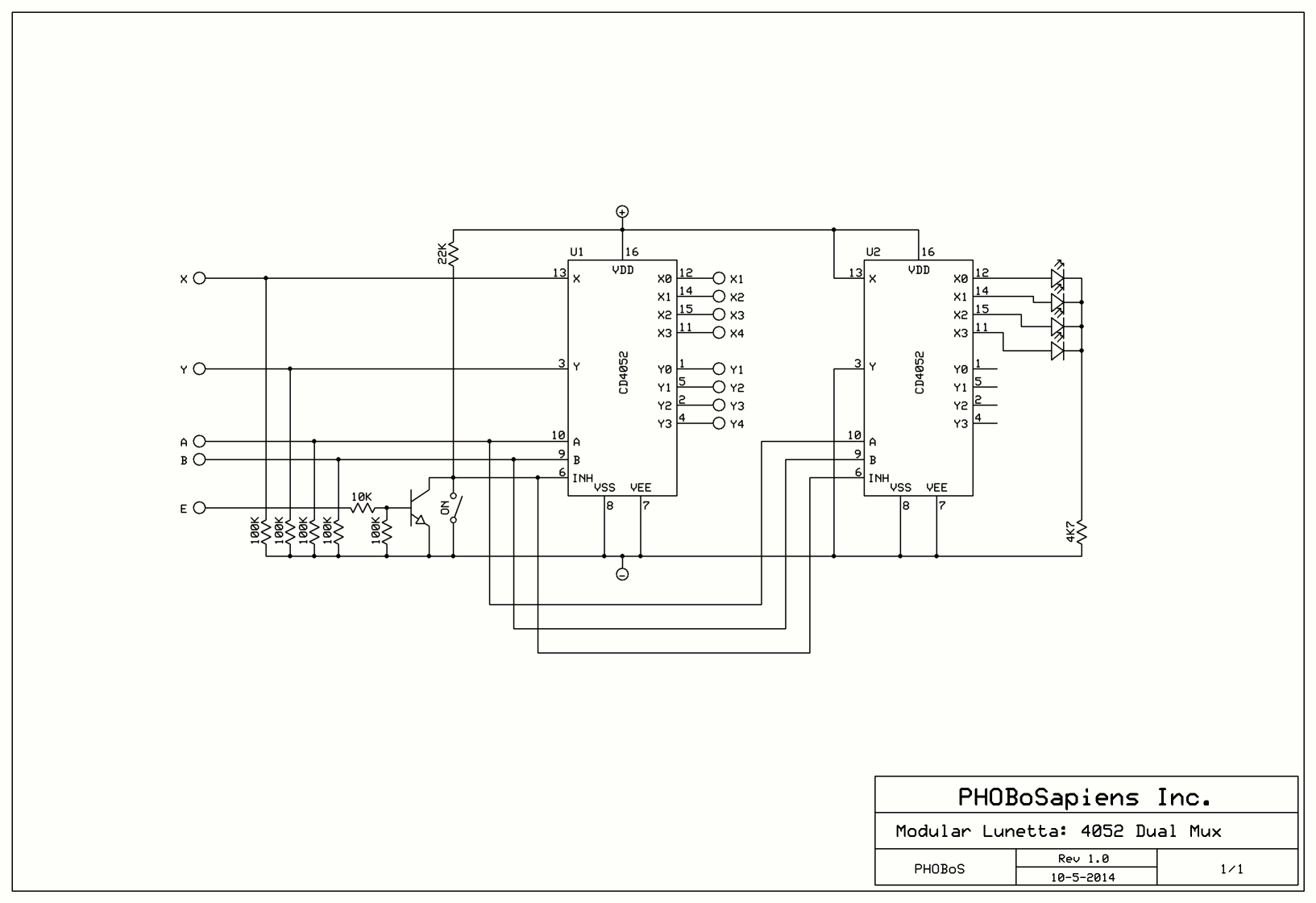

PostPosted: Sat May 10, 2014 4:38 pm    Post subject: Modular lunetta dual mux module
Subject description: CD4052
And another one finished, a 4052 dual mux. I added another mux that is just used as a bin2dec decoder to control the LED's. Since this is the same for
both halves (X,Y) I only used 4 LED's and mounted them between the X,Y in/outs.

PostPosted: Mon Jun 23, 2014 4:14 am    Post subject: modular lunetta XNOR Comparator module
Subject description: 4 bit
I have room for 3 more modules, 2 regular sized and 1 larger one the same size as the interface. I want to use the large one for a mixer so that
leaves me with 2 modules left. Some extra inverters are useful and some XOR gates aswell and if you make one input of an XOR high it functions
just like an inverter. But because I have diodes on all the outputs I can't use pullup resistors (the input would never go low). I could use a
patchcable though to make one input high if I want to use an XOR as an inverter.
But instead I choose to use XNOR gates, these work as an inverter when one input is low instead of high. And can be used like an XOR be it that
the output is inverted (I can invert it with a second XNOR gate to get a regular XOR). I also added diodes and a pullup resistor, buffered by a
transistor, as suggested by elektrouwe so the module also functions as a 4 bit digital comparator. Very Happy
